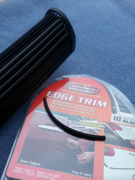

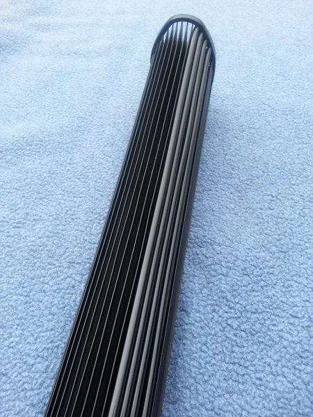

    mine whistled so bad the truck was un-drivable until I did this to the lower four heat fins. still whistles a bit, but 95% of it is gone.

    glad to help, you need to put the edge strip on the 4-5 lower fins as the air is coming up off the windshield, like blowing across a coke bottle!
