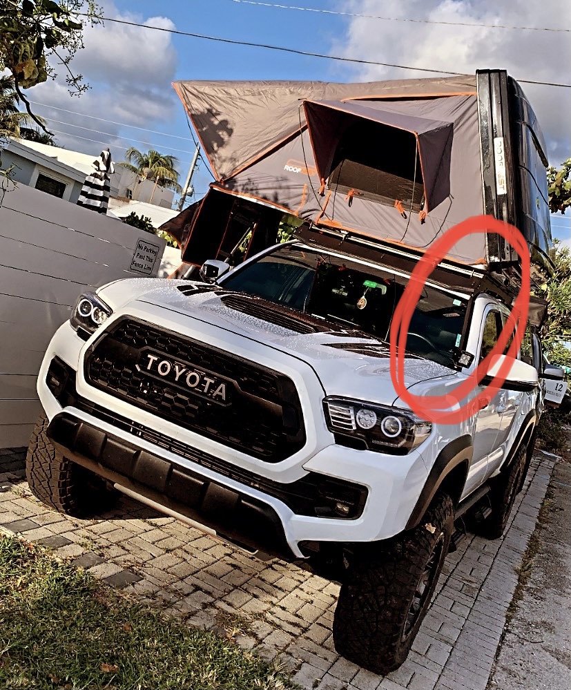

    KC Hilities makes a super solid universal wire hider. I’m at work and this is the only pic you can somewhat see it on my truck lol I can snap another pic when I’m home later. The wire hider just uses double sided 3m tape & if you follow the factory windshield weatherstripping it looks factory.
    I bought it from Rago because with shipping and all it was the cheapest place I could find it. C0E4DBCA-88E4-4FDE-AC24-FBA26FD90514.jpg
