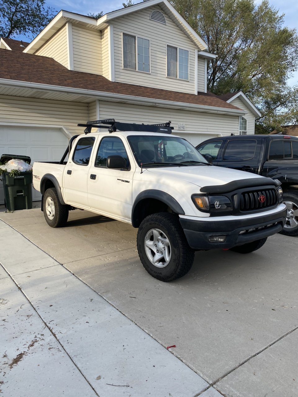

    I’m looking to put some roof lights on my rig. I like the look of the round lights rather then a bar, but I don’t want to pay the price of the KC lights. I think I wanna mount then upside down on a on a roof rack. My question is has anyone done this before? If so or has any ideas on wiring them up?
    Photos for reference. TIA

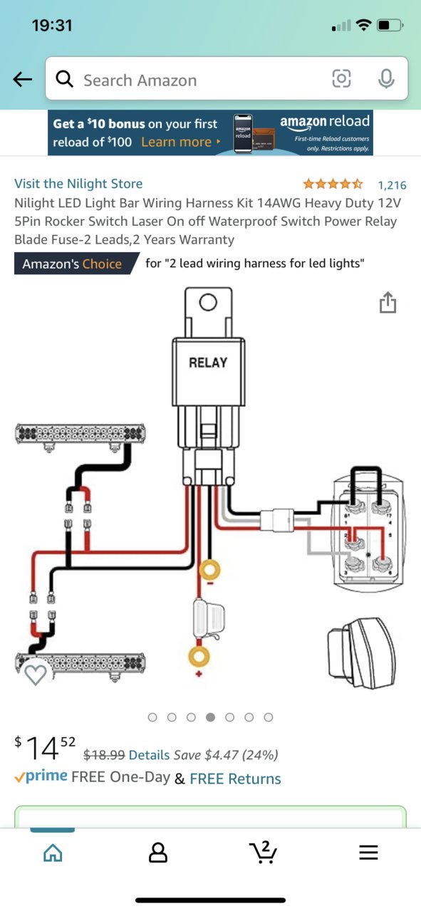

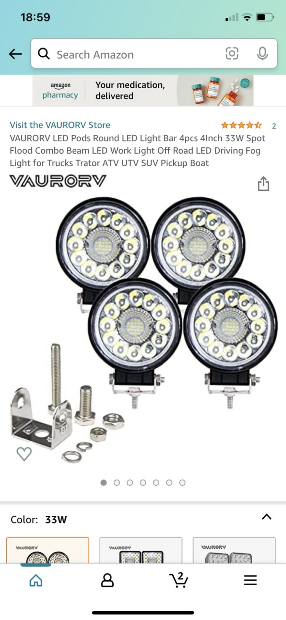

    If I were to get something like this and solder them together to plug in, would that work?

    Yes, so long as it says it’s rated to handle the amount of watts you want to put through it with the # of lights you want.
    ie: if you want 4 of the 33wat pods, make sure the harness is rated to at least 132watts max.

    Look for amps, not watts on the relays and wires. You'll probably find things are more expensive when marketed with watts since people dealing in those terms don't know what they're doing - easier to take advantage of.
    Also, almost all LED wattages are overrated for marketing - sometimes by as much as double. 100W/12.8V = 7.8A.

    Unless you mount those Amazon lights really far back, you’re going to get bad hood glare. The KCs have a highly engineered optic with no forward escaping light that isn’t reflected, giving incredible control and all but eliminating hood glare.

    Okay, could I buy wire and a relay separate And make my own harness? Or would that be to complicated? Thank you for your tip

    In round there are not any other LED options I’m aware of. In non-round there is products by Diode Dynamics with their TIR optics, or reflector light bars as posted here: https://www.tacomaworld.com/threads/the-sae-j581-aux-high-beam-thread.696597/page-17#post-26216012
    In halogen round Hellas Black Magic lights have internal shields minimizing light spill and causing the reflector to look black.
    For your criteria the KCs will be the best fit, but are not inexpensive. You can buy the Pro6 lights in pairs though, if you wanted to say put 4 lights up there vs a full bar. The Diode Dynamics bar will likely be the best value, but not offer the round look you are going for.

    Yes, you can absolutely buy separate wire and relay to make your own harness, if done correctly it's the best option because you can make it the exact length you need it to be. Cost wise it'll be a wash however due to the cost of supplies for your first one. However each harness you make out of those wire spools ultimately reduce the cost of each harness lol
    If you're really interested in learning and aren't scared of reading to learn this page is very informative to a beginner
    https://www.12voltplanet.co.uk/relay-guide.html

    Yep. I did 5 for like 20 bucks
    Like this, but mine have inline fuse holders as well:
    https://www.ebay.com/itm/371624481987
    I should note that it helps to have spare wire and switches around, I guess not everyone does, so maybe that original screenshot you sent is fine
