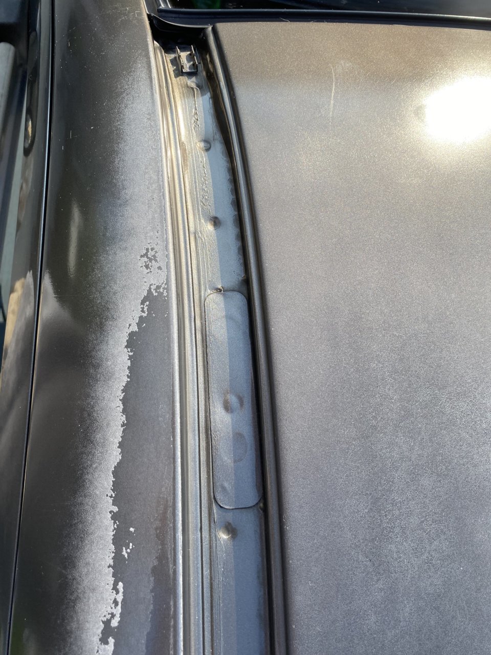

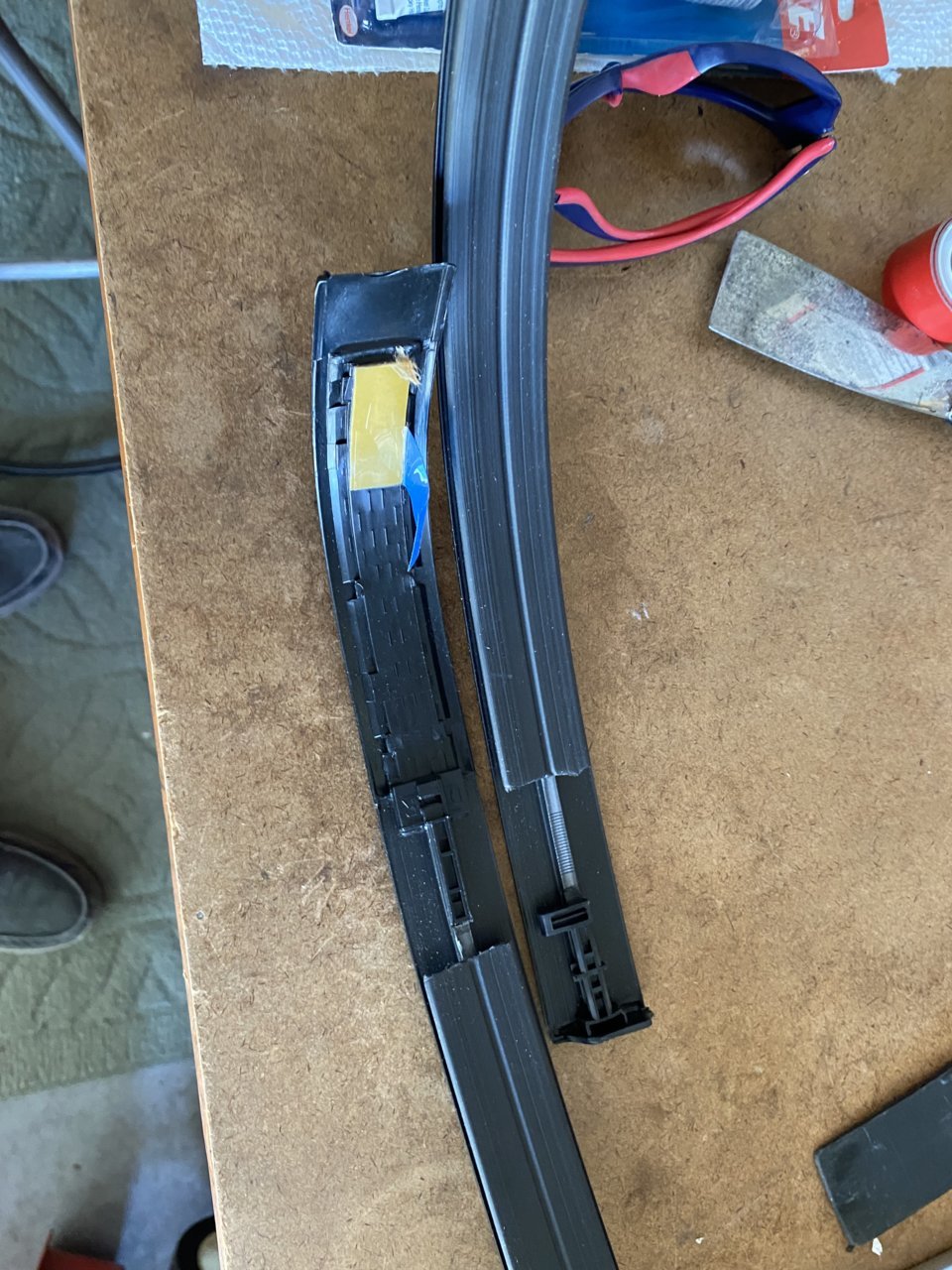

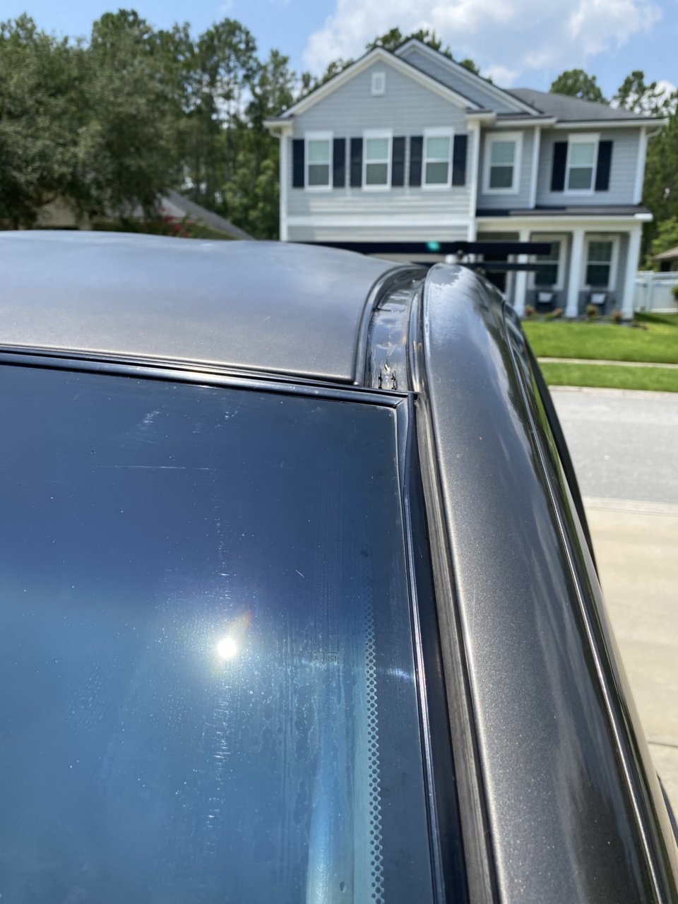

    Follow up.
    Yes no problems running without the moldings on noise or water intrusion but yes wanted to confirm it did look like ass as mentioned above (even with my failing clearcoat)!
    Here are a few pics for anyone wondering what is under those moldings and how they clip and stick in.
    McGeorge Toyota had them to me in 3 days about $200 shipped/taxed to me for both - great service and best prices.
    The front pic shows the clip and rear top has same plus you can see the rear adhesive on the new molding. The slightly raised strip about 4" in the empty roof is where a roof rack would mount punching thru the heavy painted tape and there are 3 places each side.
