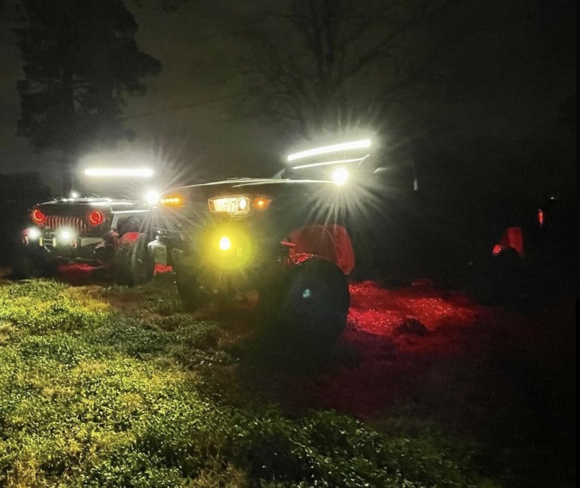

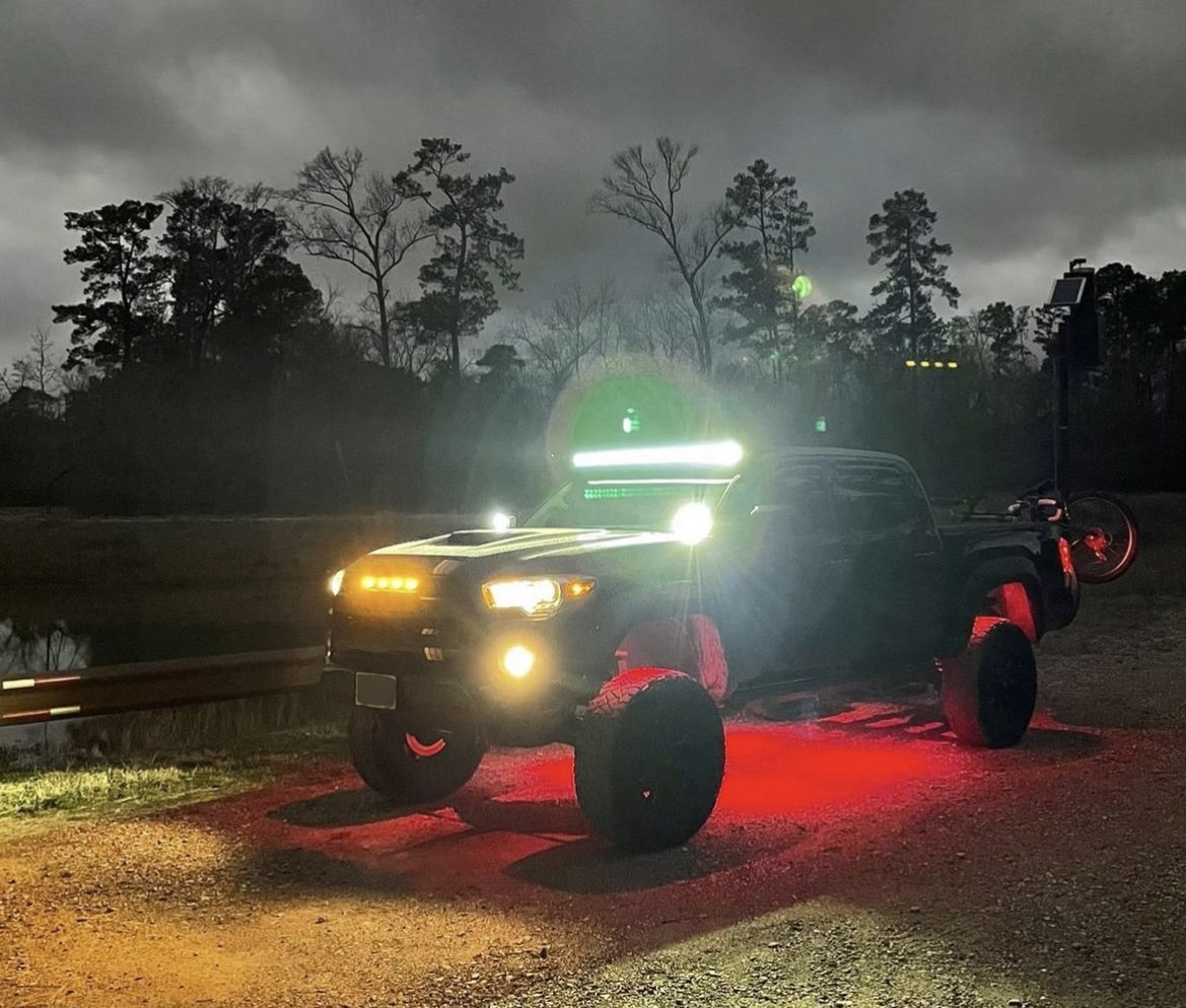

    All my rigs are purpose built. From crawling to camping. I also enjoy a nice stock truck for what that’s worth. Toyota’s are the jam!
    Grill lights to illuminate the road only.
    Roof lights to illuminate way down the road, and if you get a combo it will spill into your peripheral side vision.
    Ditch lights are great to help see animals on the sides of the roads more than anything. I don’t use them to see in ditches.
    If your the terrain that your in has dense foliage and the trees are tight on the road, consider using an Amber lights. The white will almost blind you bouncing off everywhere to close to you.
    So I got a little bit of everything on my truck. I use the bumper and ditch lights the most.
    The roof one I use when I am moving at speed and have open terrain. Like I mentioned if I am in the woods, it almost blinds me it’s so bright. Mine has 2 functions, white spot in the middle and Amber flood on the sides. I end up just using the Amber floods, the center white spot only is turned on when I want to see way out.
