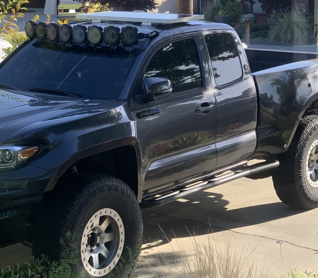

    I like how they mounted flush. Did the panels come with the brackets to mount them flush or did you buy them separately? Thanks

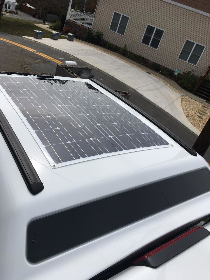

    I’ve had a solar panel mounted two ways. I’m not a richer that has a roof rack so mine was mounted right on the roof.
    Round 1: mounted via double sided tape on the brackets that came with the panel. Also added some safety wire in case the tape came loose. When I took it off it was still so stuck down I bent the brackets and almost the roof pulling it off.
    Round 2: flat panel stuck to the roof. This looks better but I kind of messed up the install and it’s not perfectly flat. Once I get a shell I’ll buy another of these and stick on the shell. Why another? Because removing this will absolutely destroy the panel. It’s on with almost an entire roll of double sided tape. It’s not going anywhere.

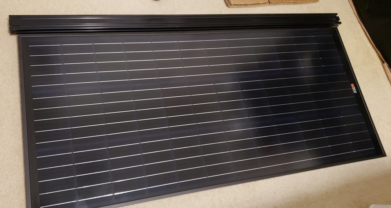

    They are rigid fixed panels that I drilled holes through on the sides. They are just bolted directly to my prinsu rack, so no additional brackets were needed. If you have the thin flexible panels you'd need to come up with something different, but for the thicker rigid panels, this is the way.

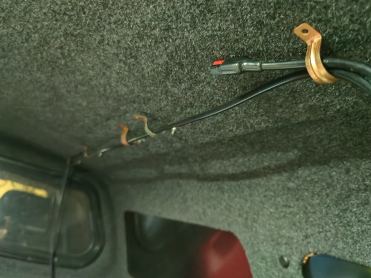

    Sliding front window? Like a 3-piece design, with center slide? You just opened it, put the wire, then closed it? I'm surprised that worked, especially with the cable thickness
    I have the same kind of window, but it also can fold down. I wonder if that would work too. Fold it down, route on the outer edge side, then close it. I'll go open it to see what the gasket design is like and how tight it closes; it might not be possible

    How did you secure the panels on the inside of the racks?
  19. Sep 5, 2023 at 8:00 AM
    #39
    MountainManGuy
    MountainManGuy Well-Known Member
    Jul 26, 2019
    #300316
    808
    Colorado
    2019 Toyota Tacoma TRD Off-Road DCSB
    I drilled holes in the frames of the panels and used t slot bolts in the tracks of the rack. You have to assemble the crossbar sections and the panels together prior to lifting it up on the 'skeleton' of the roof rack.
