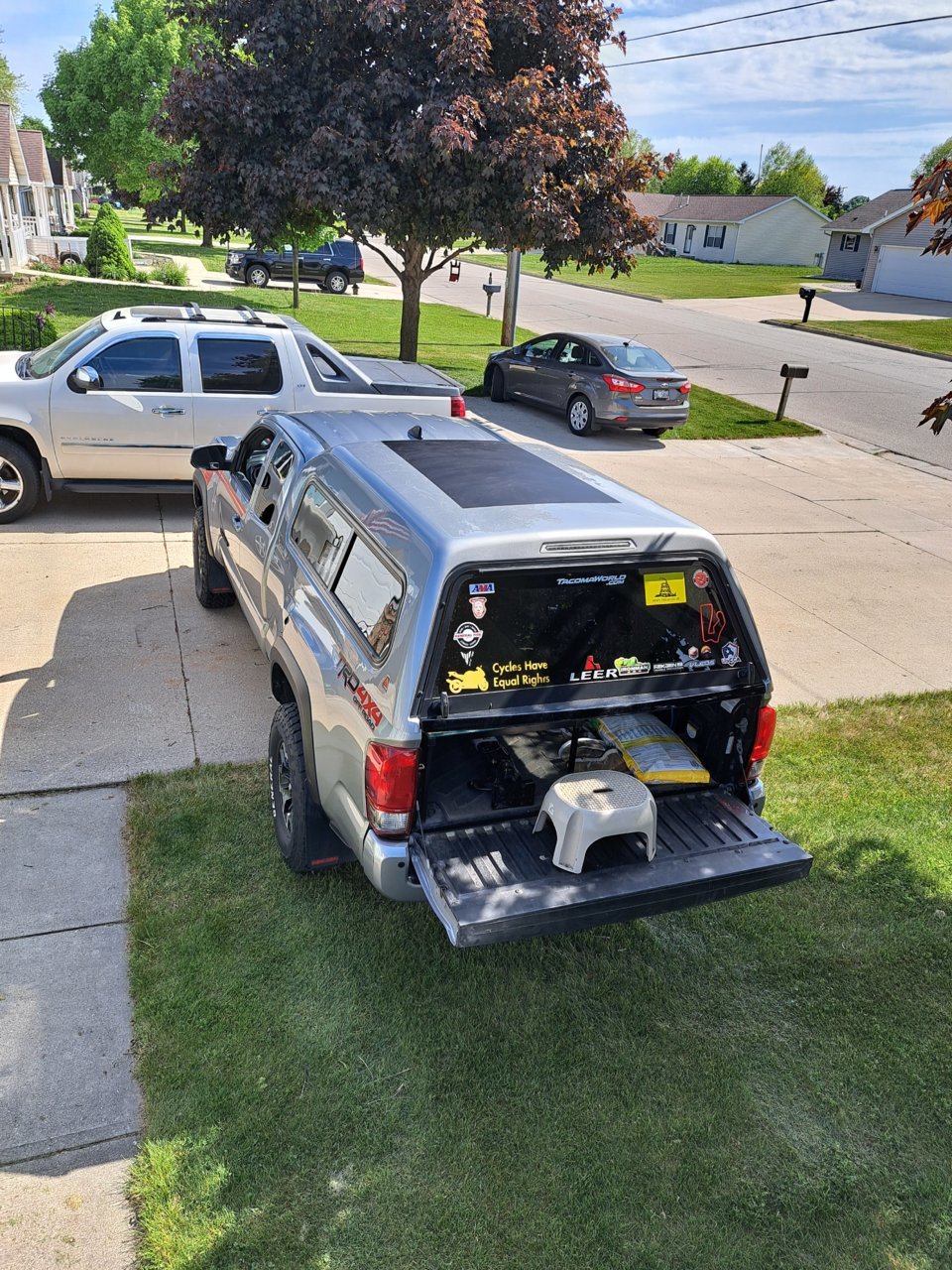

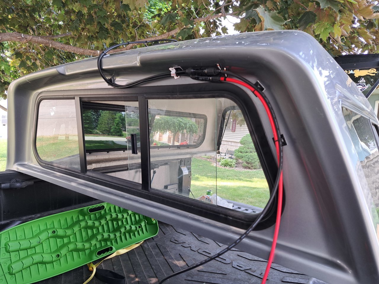

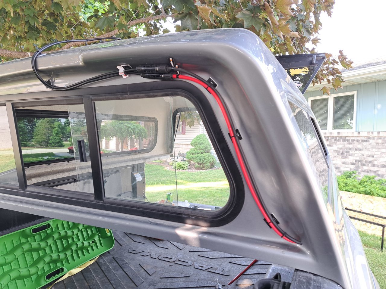

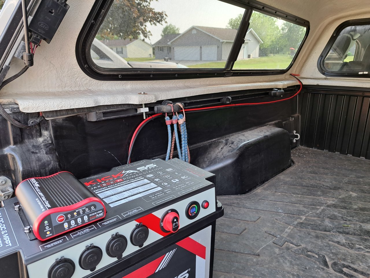

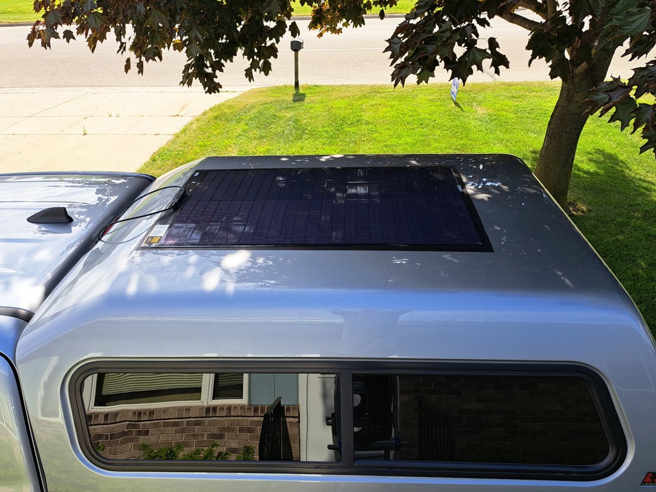

    My setup:
    20230529_163314.jpg 20230529_160359.jpg 20230604_161707.jpg 20230604_164348.jpg 20230604_174003.jpg
    The KickAss power station has an AGM battery in it. I went with the AGM because that's what I will be running soon for my main battery. With my tune adjusted for proper charging of the AGM and the power station now wired to the main battery, I will have more than enough power to do what I want to do. Initial test weekend, without the power station wired to the truck, I ran my refrigerator, lights and was able to charge my phone, etc and had more than enough reserve. With the power station wired in, I'm charging whether I'm running or parked.

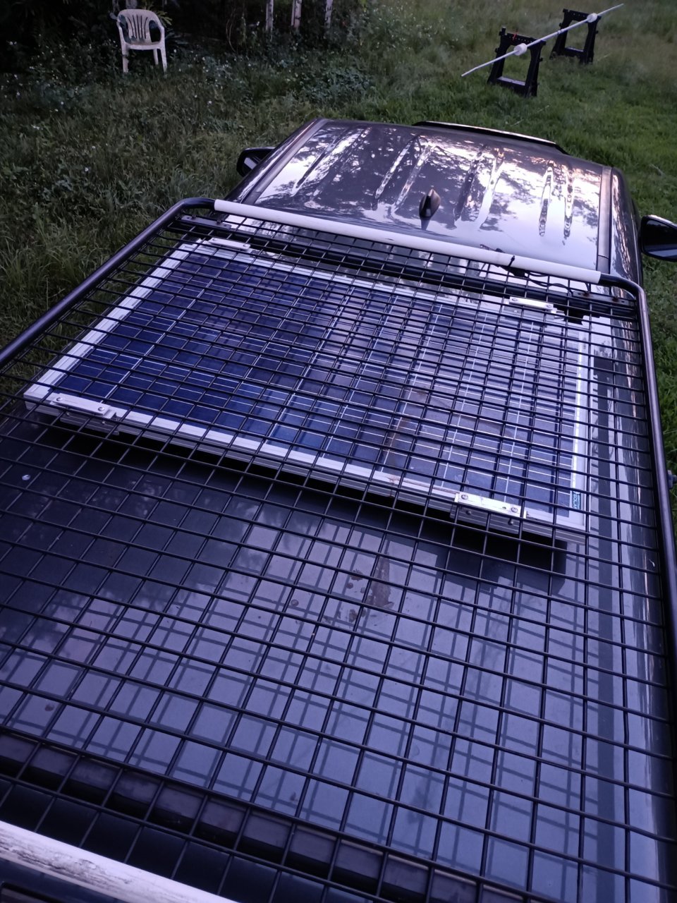

    How’s the efficiency when it’s under that rack

    No idea, but I'm not going to ruin the use of my roof rack so it doesn't matter.
    My fridge runs 24/7 and my 100ah LiFePo4 battery stays above 80% as long as I'm parked outside.

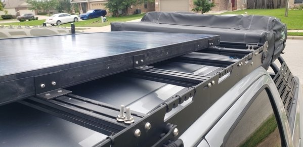

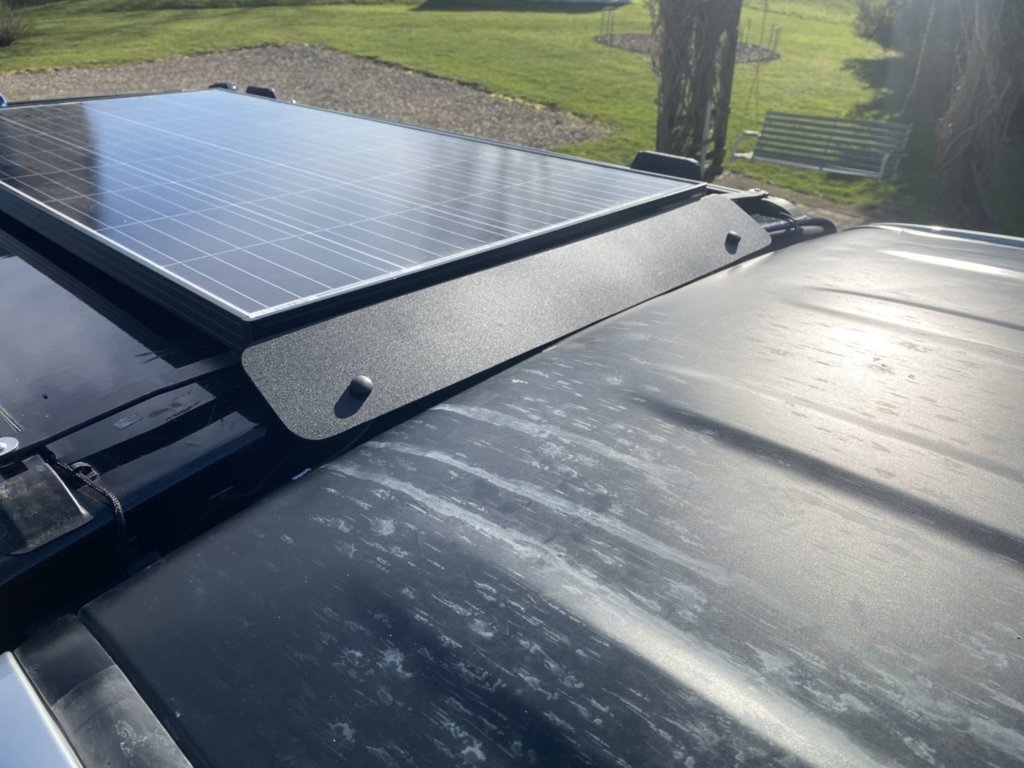

    I just mounted a solar panel to my roof rack today. I was wondering in anyone has had any issues with them flying off even when bolted down? Worried about wind getting underneath the panel at high speeds. My rack does have a wind deflector tho. It’s bolted down with z brackets into t nuts that fit into the chanel.

    Mine has been on my roof rack for several years an never had any issues, it too is bolted down with 1/4" hardware to the extrusion

    That’s exactly how my set up is except mine has only 2 z brackets on each side as a pose to 3 like your set up. My panel is smaller though. It should be fine then. I get paranoid about causing an accident if that thing flies off my roof lol.

    For a rigid panel, putting spacers under the rear bolt-down points, or making custom brackets to slightly increase the height of the rear end of the panel (1/4-1/2" higher in the rear would be enough to make a difference).
    You'll have a little more drag at highway speed, but the panel will also produce a small amount of down-force due to the negative angle of attack. It's not going to be enough to affect your handling or road-feel, but it should be enough to eliminate most of the risk of the panel blowing off the roof. If you get hit by an extreme sidewind or tailwind, there might be some issues, but in the level of wind that would require if you're moving 60-80 mph forward that panel would likely be the least of your issues.

    Mines been mounted like this for 2+ years now.
    I made a small fairing for mine last year.
    I had a smaller panel up there mounted the same way for 2 years prior to the larger panel.

    When I bought mine, BougeRV were rated the best. I'm not sure why some people are so down on flexible panels. I have mine mounted on my fiberglass cap. The nice thing is it flexes to the contour of the fiberglass to mount flat. And the way it mounts, it isn't going anywhere. I don't know if or how much the roof of the fiberglass cap flexes, but I don't think it's much at all.
    As for vibration, I'd venture a guess that the solid panels mounted to a roof rack flex and vibrate at least as much due to the air moving over the panel while at speed.
