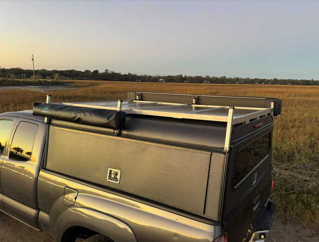

    This is the panel I have on my cap: https://www.amazon.com/dp/B0BJJYZJ5X?ref=ppx_yo2ov_dt_b_fed_asin_title&th=1
    I have vinyl down first and then the panel, which has five 2" strips of VHB tape to hold it down...and it is down! It's been on the truck for just about 2 years now.

    I used vinyl, like you'd use for a wrap. That way, if I were to remove the panel at some point in the future, it would be easier and less likely to damage the paint.

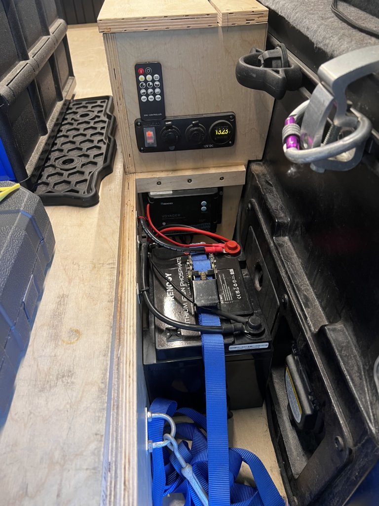

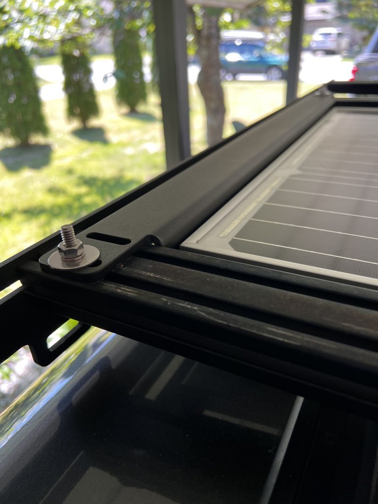

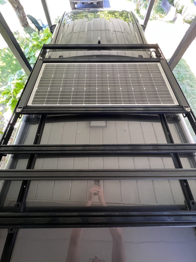

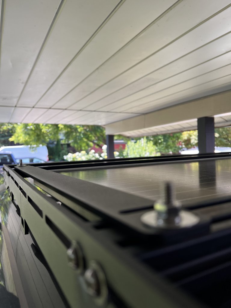

    mounted 100w panel on my canopy roof rack to power my fridge and some camp lights + phone charging at night. 50ah renogy battery is all I need at this time. created these mounts with a friend of mine to mount the panel under the cross bars so I can still take advantage of all the space on the roof.

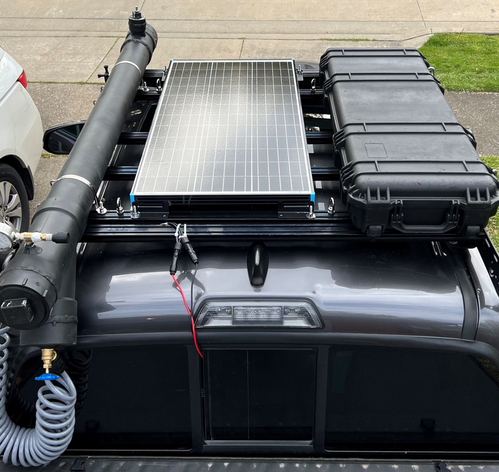

    What is the PVC pipe on the left? It looks like the potato cannon that rules them all
  13. Jul 10, 2025 at 6:08 PM
    #73
    Tronfunkblow
    Tronfunkblow Well-Known Member
    Mar 24, 2022
    #393351
    340
    California
    2017 DCLB TRD OFF-ROAD 4x4
    MT64s, Icon RXT Leaf Springs, Topo Topper
    Shower tube
    would be a helluva potato canon though

    Yup. Pressurized water tube. Holds 4.5 gallons. Users a schrader valve to add pressure and a pressure relief valves insures the tube doesn’t blow up
