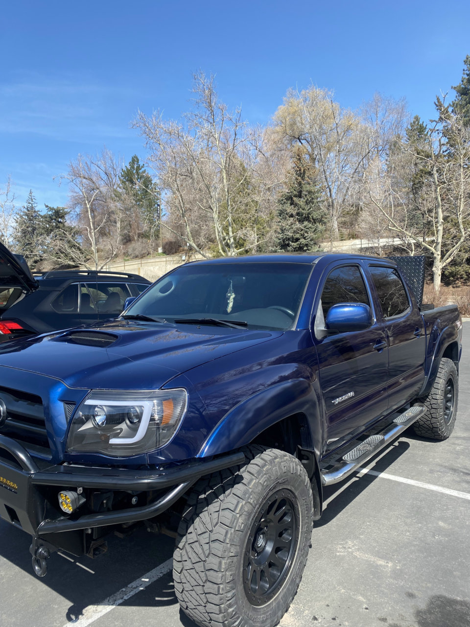

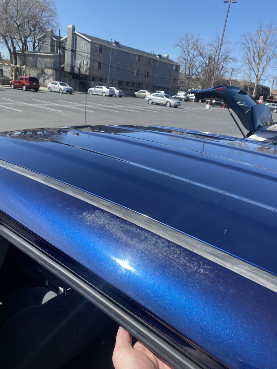

    Hello all,
    I clayed and waxed my truck today and noticed some oxidation on the roof. Does anyone have any tips or tricks to keep this from spreading? As far as I know this is the only spot on the truck so far. Its a 2008 and it lives outside so I know oxidation is almost inevitable but id like to prevent it getting worse. If there is a similar thread out there point me to it and I will delete this one. Thanks!

    Oxidation is UV damaged clearcoat which Ultimately needs to be removed. I would start by wet sanding the effected area followed by compound, polish and protectant of choice. Its a multi step operation but is really the only way to properly remove said oxidation. Considering the age of your paint and the fact you park it outside all the time I'd apply the protectant every three months.

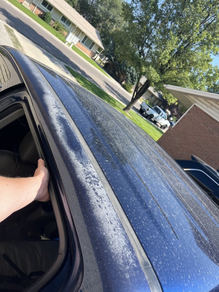

    Your clear coat is failing. This is typical with Tacos starting around 10 years or older. You can try all kinds of things but nothing really works other than a new paint job. Once the clear coat starts failing it’s progressive, it doesn’t stop. Some things may slow the process down, but it’s temporary. Also it usually starts on the roof or hood area where it gets the most sun exposure.
    My clear coat started looking like shit at 10 years. After a year of that I got it painted. 4 years later still looks like new.

    Unfortunately, as others have said it did accelerate shortly after I posted that. On the bright side I no longer care about scratches. Maybe I’ll repaint one day. My hood and tops of doors are most effected.
