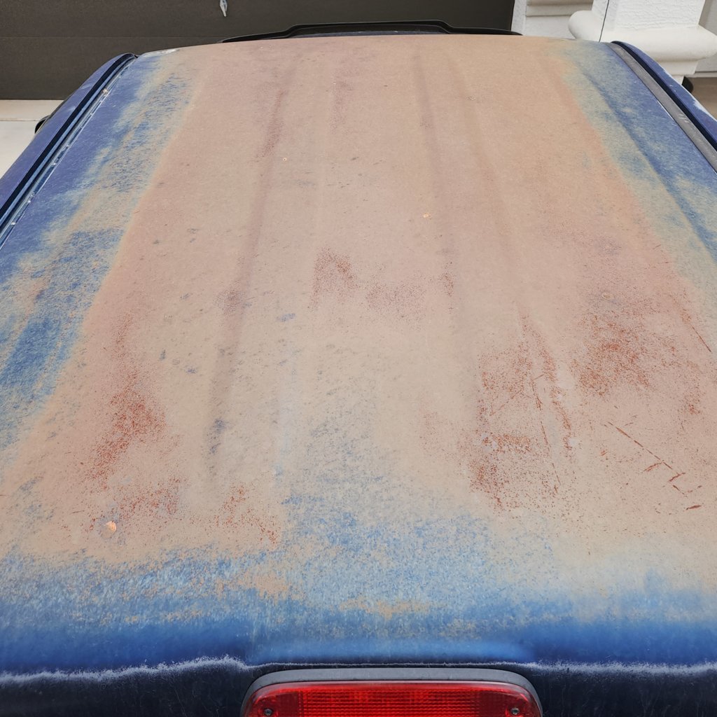

    Are you ready to see one of the worst roofs on a Tacoma you have ever seen? AZ sun is no joke! The previous owner clearly did not give a hoot.
    I am looking for some advise on how to tackle this. I would like to fix it myself because, honestly, I don't really care what it looks like. My concern is just to treat the problem. I don't need it to be perfect as it will be covered by a roof rack anyway so I am open to wraps, repainting, whatever, just need advise on how to deal with the rust problem.
    If certain types of products are suggested, if you would be so kind as to provide some examples. I have been watching a ton of YouTube and there is so many different opinions and products thrown in my face, not sure what would work best.
    I am eager to hear any and all suggestions.

    Just did mine, was every bit as bad as yours. southwest truck most of its life. 80 grit da, metal etched, epoxy prime and bc/cc. Looks great!

    What kind of epoxy prime and base coat then clear coat did you use?

    After removing the rust and repainting, protect it by wrapping it in vinyl. It's what I've done for the past 6 years and it's preserved my roof paint. I just rewrap every couple years. Easy stuff.

    Omni from the local auto paint supplier.

    05 TRD Off-Road, SR5, 6 speed
