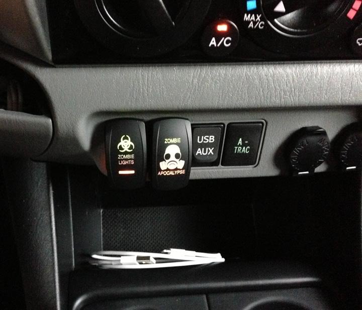

    So with all this lighting I wanted a somewhat OEM look to the switches and their locations inside the cab. I chose to use switches from OTRATTW here is the link
    http://www.otrattw.com/proddetail.php?prod=VVPZC59-1TL
    The switches I used are the V1D1JCNB SPST
    Additionally, I wanted a clean install as well as a safe install. So with that in mind I decided to add a fuse block, main fuse, almost all lighting on relays and I used 16 gauge wire.

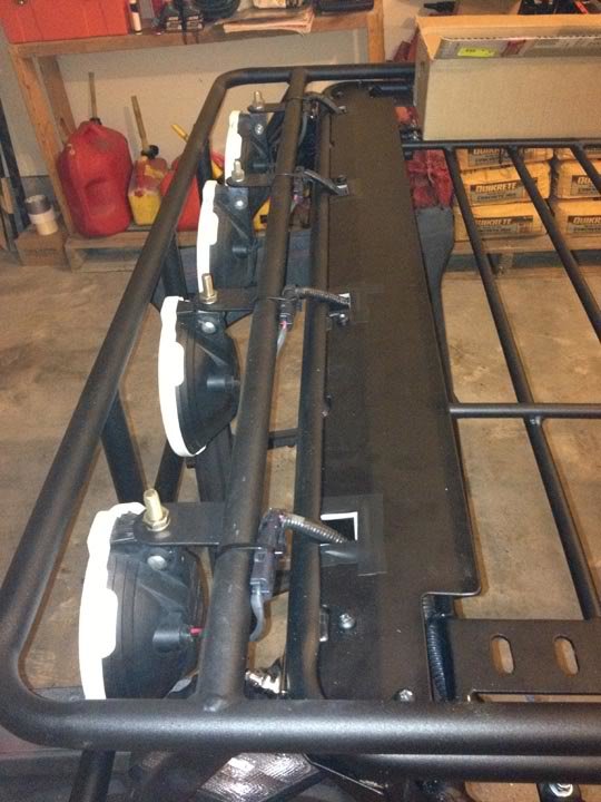

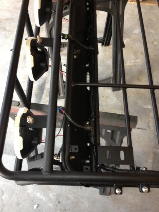

    Ok well I cheated a bit and installed all the lights before I placed the roof rack on the taco.

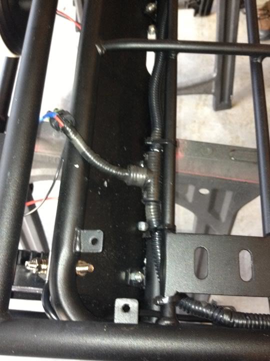

    So with the lights installed I turned the rack up side down and used the first half of the Baja Rack wiring harness to connect the 4 Hella 500s. I then wired the 2 side LEDs and ran the wires inside the conduit of the Baja Rack harness.
    I mounted the side LEDs at an angle on the front Air dam and the rear LEDs at the Baja Rack rear mounts. However, due to the included LED mounts being too short and would have forced the rear LEDs to be angled down and the fact that I wanted them to sit lower, I fabricated my own mounts and drilled an additional hole in the rear rack mount.
    Once the harness was secured with zip ties I then had to cut out pass through squares in the bottom air dam of the roof rack. I used some rubber door edge to finish the edges of the cutouts so that the wires do not get cut.

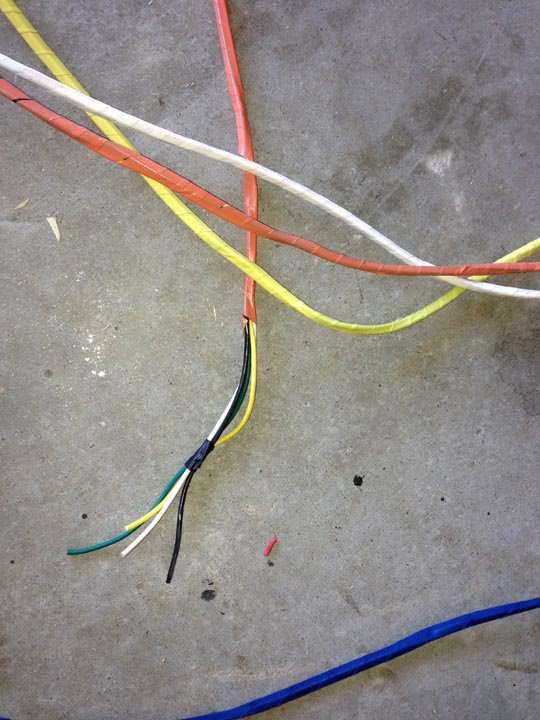

    Next, I decided to use one of the Baja Rack mounting bolts as a common ground. It should be noted that the Baja Rack wiring harness brings all 4 Hella 500s to two red wires rather than one. I assume this is done due to the amps the lights require. The harness is not designed for specific lights and some lights may be HIDs or high amp lights. So if you look at the wiring diagram we maintained this layout and brought both red wires for the Hella 500s to one 20/30 amp relay.
    So the total wires that were grounded was 4 wires (2 from the Hellas, 1 from the side LEDs, and 1 from the rear LEDs).

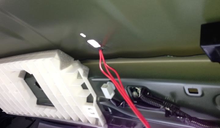

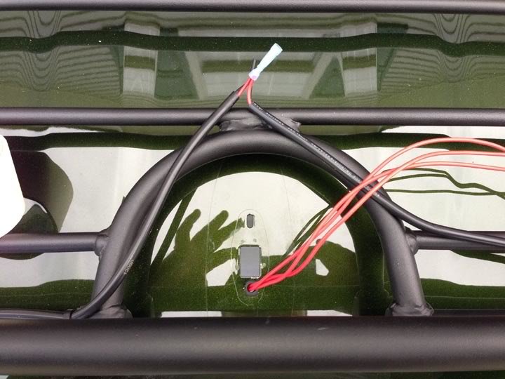

    I then had to decide how to get the red wires off the roof and to the engine compartment. The Baja Rack wiring harness is designed to run down the rear window and under the cabe but I did not like the look of the harness hanging down in the back so I decided to go through the cab. I considered three options:
    Drill hole under the water drip rail (rubber strips on roof) and run down the inside of the A pillar.
    Drill hole in rear roof mounted brake light and run wires under the head liner and down the C pillar and along the drivers side under the door seals.

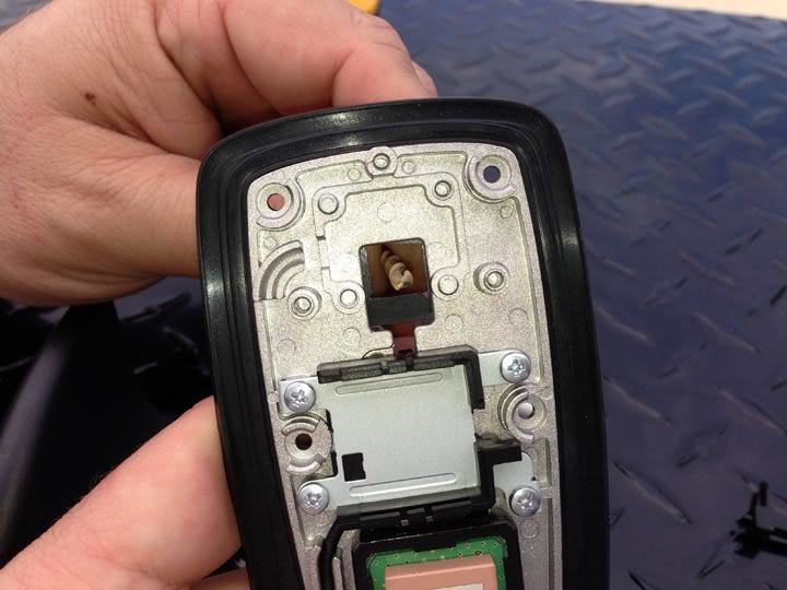

    Drill hole through the shark fin XM antenna and run wires under the head liner along the drivers side then down the A pillar under the plastic molding and into the dash.
    I decided on the XM antenna method for several reasons. The holes were already there and the additional hole would be covered by the rubber antenna seal. Additionally, my free subscription to XM has expired and I will not be buying a subscription so the antenna otherwise would not be used (however, this method would not affect the operation of the antenna). Lastly, the antenna is close to the rack than the break light.
    So I removed the head liner then removed the antenna. I drilled a hole in the front of the fin and inserted a rubber grommet. I then cut out the hole in the rubber antenna seal. The metal antenna insert already had a hole so there was no need to drill it out.
    I punched through the rubber boot near the parking break to get the wires into the engine compartment.

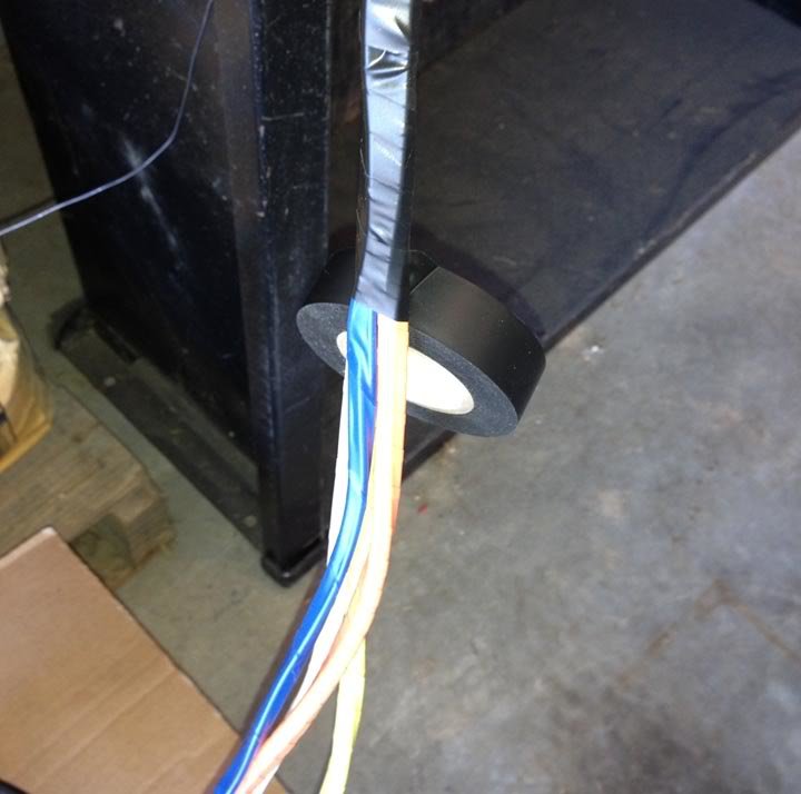

    Next, I needed to build wire harnesses for the switches. I needed 4 wire harnesses and each harness would have 4 wires. You can see the wire diagram for details.
    Next, I ran the wires to the switch locations and into the engine compartment through the same rubber boot. I used a dremel to cut out the switch holes on the center console and I had to modify the switch holes in the dash to fit the switches.

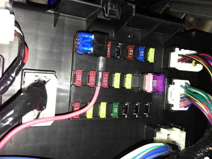

    Next, I needed to tap a fuse for the LED back light in the switches. I tapped the gauge fuse under the dash. This fuse is a 7.5 amp fuse and I used a 5 amp fuse for the switches.

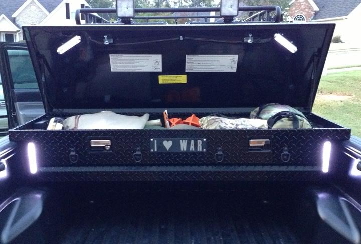

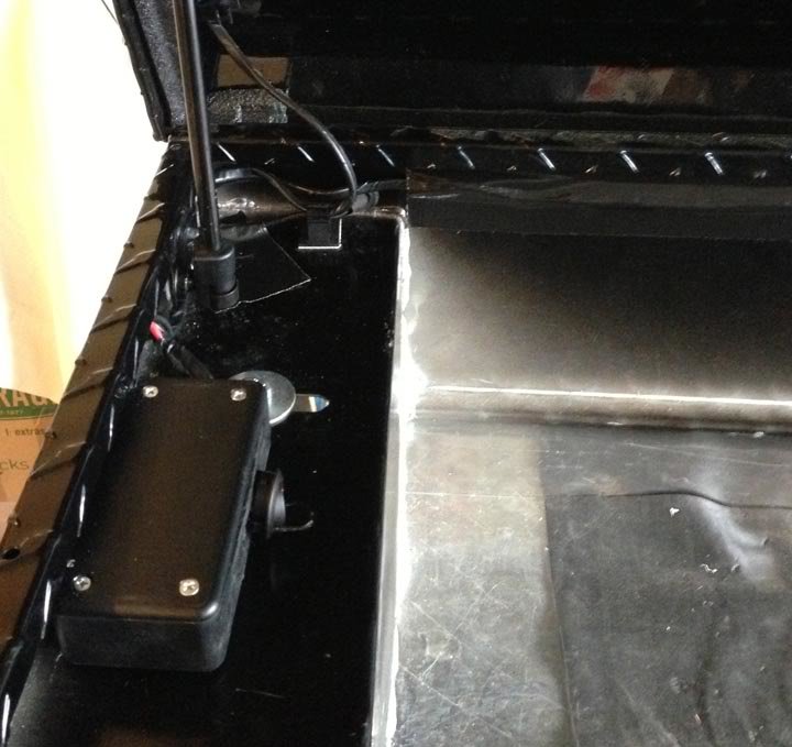

    I located the LEDs on the outside and inside of the tool box but I wanted to have the ability to pull the tool box out of the bed if needed so I used a connector and wired the common ground to the drivers side frame and I tapped the hot wire to the drivers side rear light for the power. I wired a switch inside the tool box.
    Here are the pictures of everything completed.
