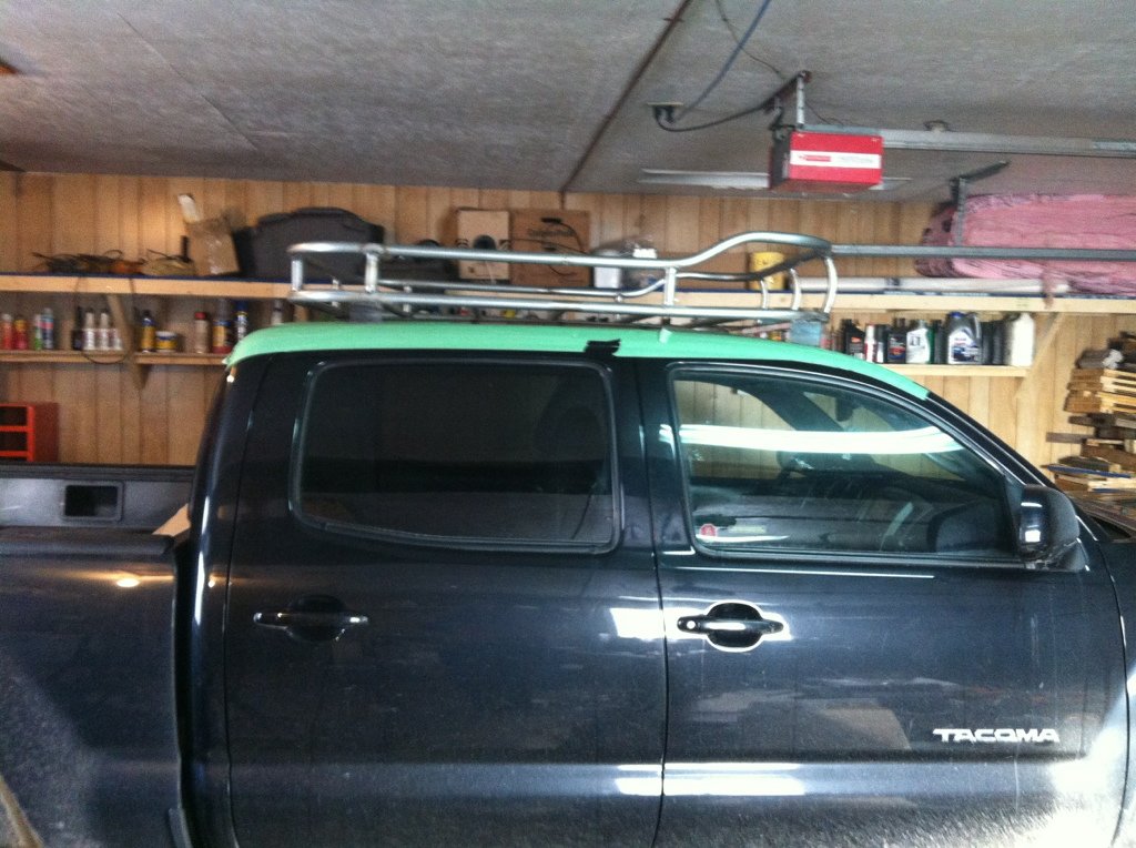

    What length bolts did you use?

    To go through rubber, 1-1/2"

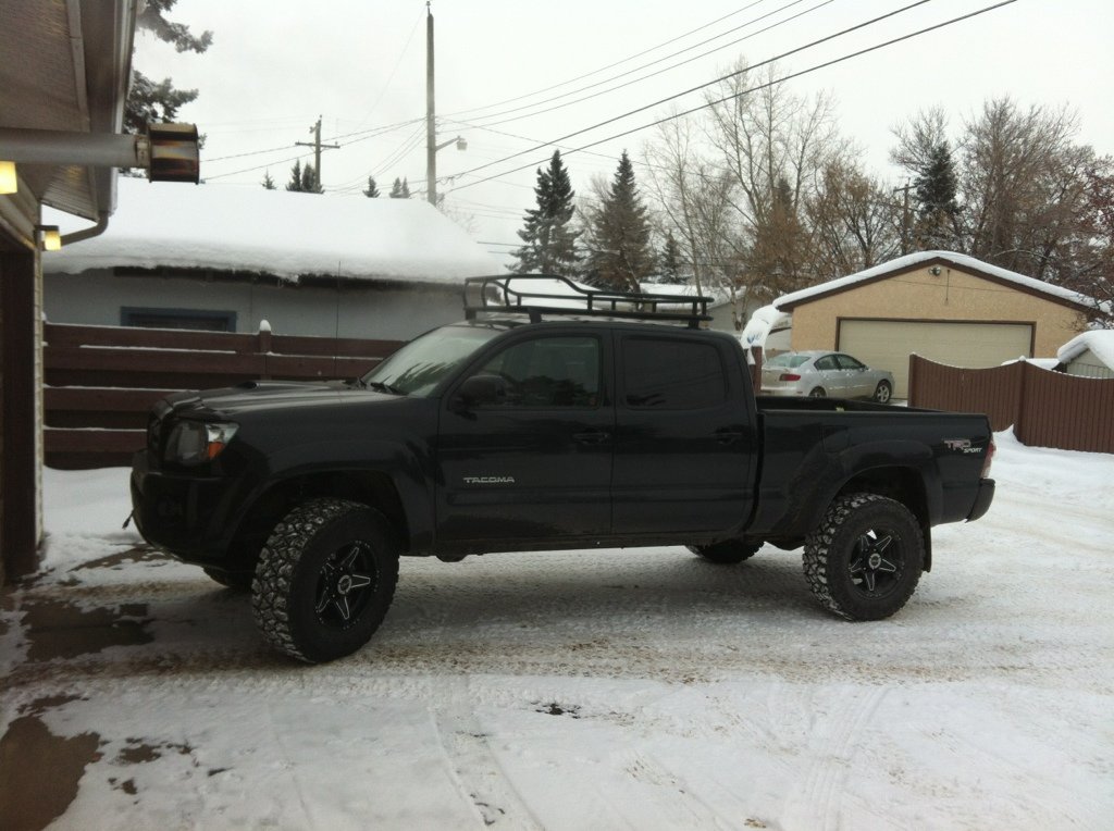

  5. Dec 8, 2012 at 1:27 PM
    TRD 09
    TRD 09 [OP] Well-Known Member
    Aug 25, 2012
    #85544
    538
    Alberta
    09 TRD sport
    00373596-A46F-4207-9DED-25EFE96B15D7-605_a9a07162e25f408a357e3d056179a41b674be29c.jpg
    Roof and light mounts are done, ready for paint and lights

    How did you bring your wiring into the cab?

    Left one front bolt out and ran through that hole.

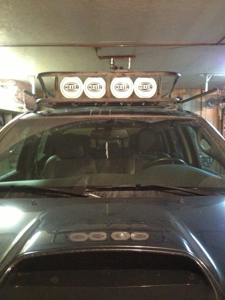

  8. Dec 9, 2012 at 1:03 PM
    TRD 09
    Aug 25, 2012
    #85544
    538
    Alberta
    09 TRD sport
    7DCB5A9E-999A-4EF1-9DAC-75070915E2FF-189_71f4a39a9a4bc29194f471ffbab59e0cb98e1827.jpg
    Here it is, finished! I'll be adding lights in a few weeks, after that SLIDERS!!!

    Did you use EMT for that rack? Looks good! How much weight do you think it will hold?

    1" EMT for the perimeter hoops and 3/4" for the floor, I'm 200lbs and I stood in it just fine before putting it on the truck, I'm not planing on putting much weight in it, it will be used to mount lights, shovel, axe, and a hi-lift jack

    Thanks, not much equipment hole saw, grinder, welder, I'm an electrician so the EMT bender is something I have available from work

    Looks good! I ran my wires through the center hole, and down the B-pillar. Just another option for you.
    I used EMT as well, terrible stuff to weld on... How did you paint?

    I just sprayed it with rubberized rocker guard, it will probably get powder coated in the spring, I'm probably going to have front, rear, and maybe side lights for camping/hunting so it might be too many wires for the hole, I might try going through the CHMSL, I'm going to mount 4 switches in the overhead console where the sunglasses compartment is now

  17. Dec 19, 2012 at 4:35 PM
    TRD 09
    Aug 25, 2012
    #85544
    538
    Alberta
    09 TRD sport
    3DAD33B1-97A2-46F5-85C6-8011919DC753-542_db1f433b4290f4bfd05727857382c12d1f8e9a74.jpg
    Finally got some lights mounted, now I just need to find time to wire them

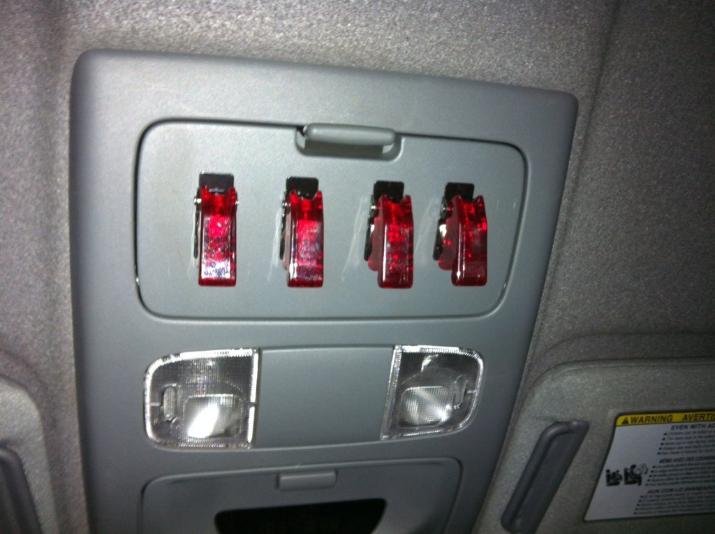

  20. Jan 10, 2013 at 10:43 PM
    TRD 09
    Aug 25, 2012
    #85544
    538
    Alberta
    09 TRD sport
    The rack is 56" long, 44" wide, 6" high on the rear and 9" over the lights, I used a 30* offset.
    I finally mounted some switches for the lights, the 4 switches will operate roof front, roof rear, bumper lights, and a spare
    9E493432-FE1F-43DB-BB6B-53301E7C64BF-187_9380b9edffd9fa4194fb5eb1be821a8741fbc832.jpg
