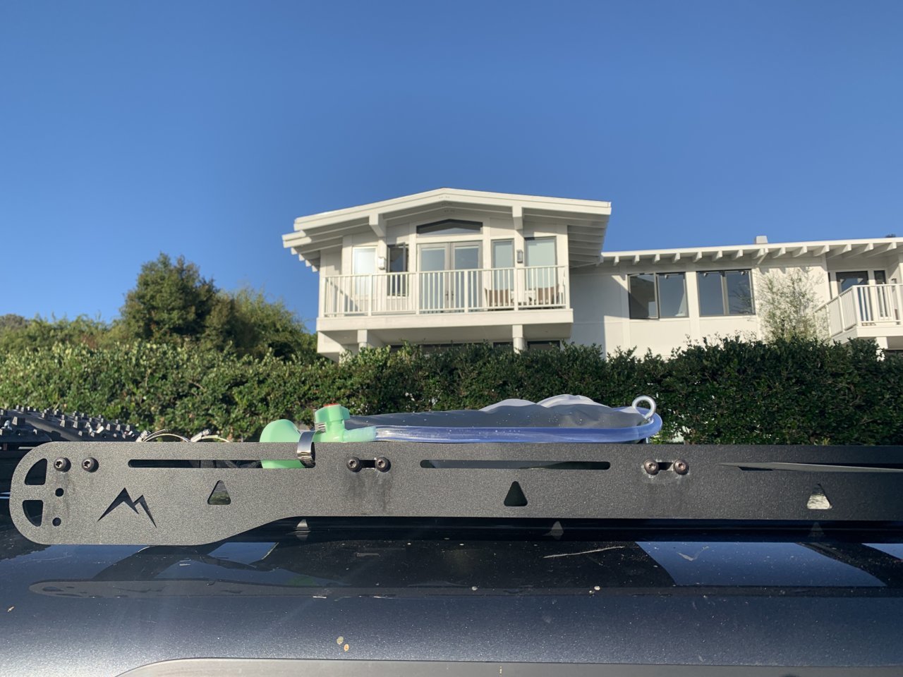

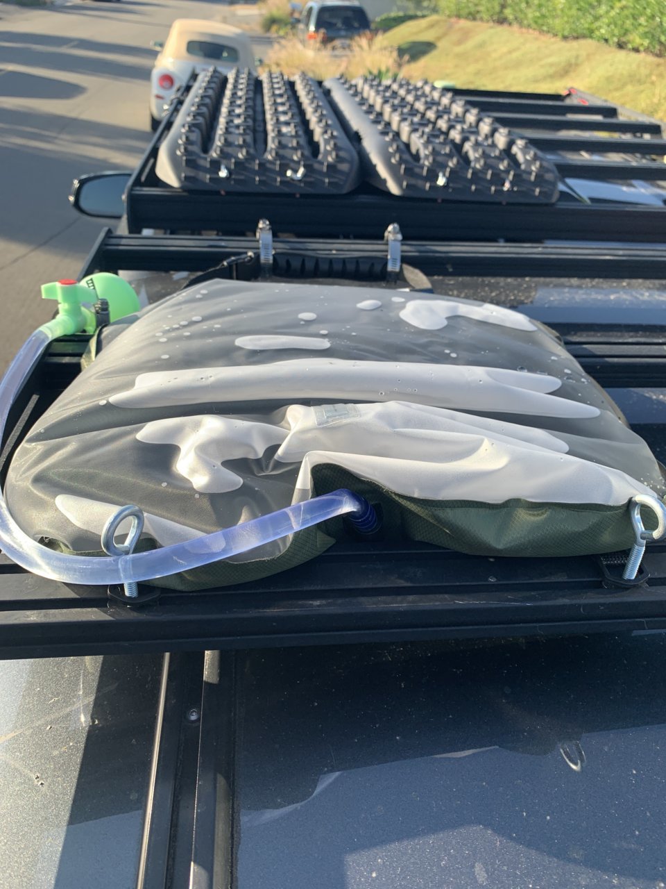

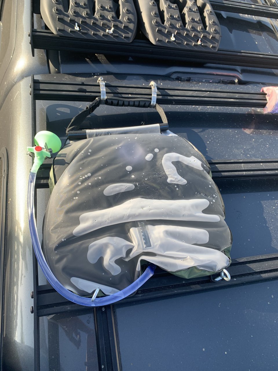

    Just ordered a cheap $20 Amazon solar camping shower bag and mounted it up to my roof rack. Really inexpensive so I’d figure I’d share on here. The shower isn’t pressurized, but the beauty is it’s mounted on your roof so it’s above your head and still comes out at an okay rate. I used two hose clamps to hold the handle up front and I used a t nut with an eyebolt in the back to hold in the little plastic clips. It doesn’t stick too far up the roof line and I didn’t notice any noise coming from the bag. Also, the shower bag didn’t leak very much. I used a hose clamp down the shower head, but cut it short so it’s easily removable for when you actually need to use it. All the hardware should be around $10, so this really is a budget friendly camping shower. KIPIDA Solar Shower Bag,5 gallons/20L Solar Heating Camping Shower Bag with Removable Hose and On-Off Switchable Shower Head for Camping Beach Swimming Outdoor Traveling Hiking https://www.amazon.com/dp/B07P6KPQHW/ref=cm_sw_r_cp_api_i_gvP-Eb5PJVGCF
