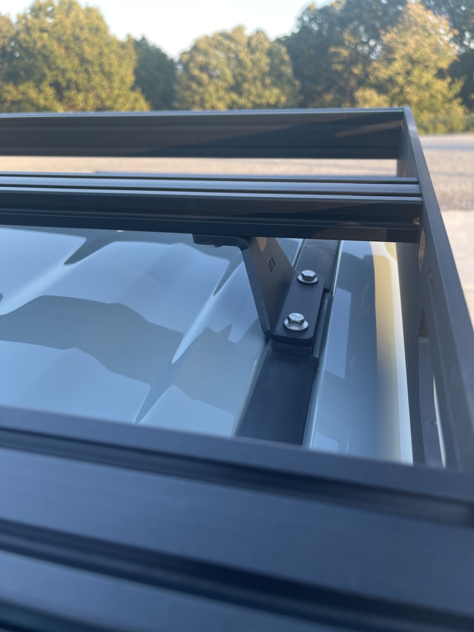

    Maybe I’m missing something, but isn’t the weight carrying capacity of a roof rack largely dependent upon the connection of the rack to the truck?
    I had the OEM rack on my last truck and installed it myself, so I know how it is bolted to captive nuts under the roof’s sheet metal. While people might say the OEM rack seems flimsy, I’m not certain I’d trust anything too heavy up there anyway given how it is attached.
    It seems to me that a stout aluminum rack (while admittedly looking good) might give you a false sense of additional weight carrying capability. Yeah, the rack maybe can hold 200# of gear, but those little bolts and captive nuts are the weak point.

    Agreed. This photo of the Sherpa Grand Teton shows the grounding point of one of the 6 brackets (3 on each side). 3 cross bars transfer the load to the mount brackets and then to the body.
    Thread: https://www.tacomaworld.com/threads/sage-the-work-truck.726842/
    Others have side rails bolted directly to the roof channel. I'm on board with this design but won't be putting heavy weight on it.
    Install video: https://sherpaequipmentco.com/pages/instructions
    Here's an install thread I found: https://www.tacomaworld.com/threads/sherpa-grand-teton-rack-install.635447/

    That's a nice build. Right now I'm between a few racks with @RCI-Offroad and the one you have leading the way. I just can't bring myself to pay for a uptop overland rack. The RCI one for me ticks the look box at a good price. I think I'm just sitting around for black friday for my rack final choice since I'm not in a rush and probably won't install until spring by this point since I'll get the roof wrapped in flat or gloss black before install.
    I see the RCI one has the three base plates, I can't tell how many bolts per foot on the rubber blocks/and bases though.

    The rear two feet of the rack will have 2 bolts per foot. The center two feet will have a single bolt per foot. The forward most two feet will have two bolts per foot. All of our mounting bolts have a rubber washer system and rubber block pedestal that seals the roof from moisture. It is a remarkably effective system. I have an install guide here for you to reference as well! https://rcimetalworks.com/wp-content/uploads/2021/09/Tacoma-Roof-Rack.pdf
