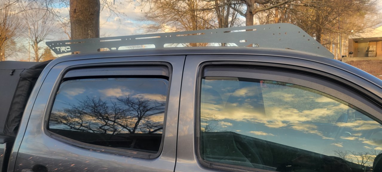

    Hey all, I find myself constantly climbing on top of my Tacoma(Access cab 2014) to have a seat and enjoy the sunset. I am currently just sitting on the roof. I want to get a half roof rack purely just for sitting, but really just need something basic to sit on. These Roof racks like the Rhino are pretty expensive and I was curious if anyone had setup like a half rack on their taco.
    I have some limited tools and could be interested in doing a DIY setup using the Unistrut. Also, I was thinking a basic crossbar might also do the trick. I could build like a board that just wedges on top of one of the bars. I am reaching out to this community to see if anyone has any advice on custom builds or come across any request like this before.

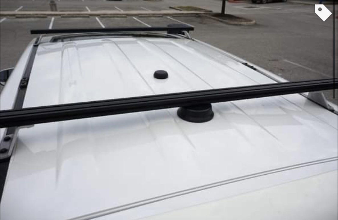

    If you’re fine with crossbars, my vote is go to SherpaEquipmentCo website and order some universal foot mounts. For access cab just need 2 sets. Can add some 10x20 extrusion from Tnutz.com or buy precut bars from Sherpa but they’ll be a bit more expensive.
    I’ve built an entire rack like this albeit with vehicle speciifc mounting feet on a GX. Relatively inexpensive compared to what’s out there.
    edit: last photo I have of my gx470 rack with just the bars:

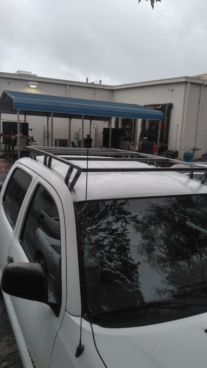

    I made one from 1 1/4" 14gage square tubing (steel) I had a half sheet of plywood strapped to it for quite a while. used it as a hunting stand a few times. ill take a pic when i get home. $40 of steel and a few hours made the strongest roof rack I've ever seen in person.
