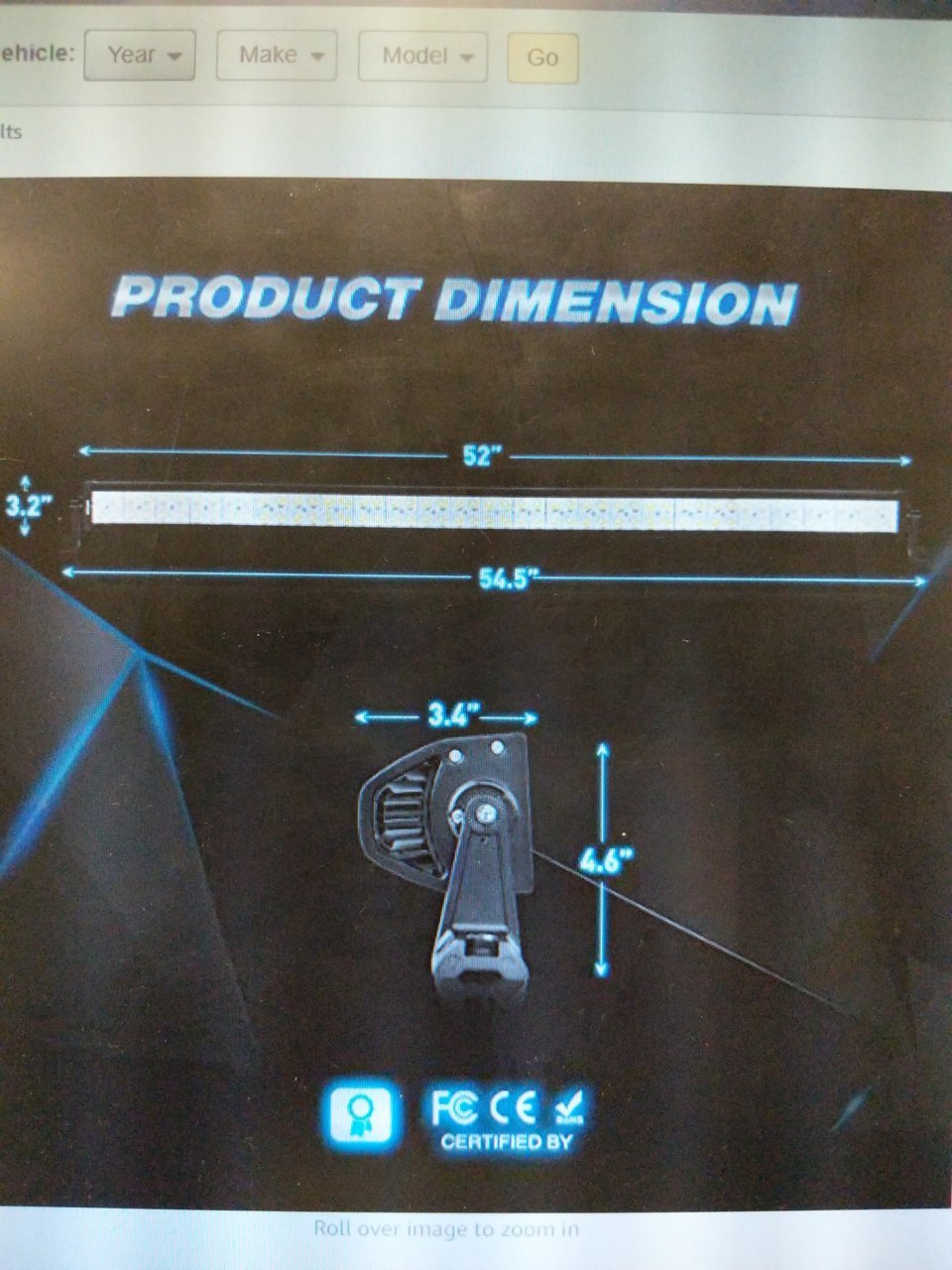

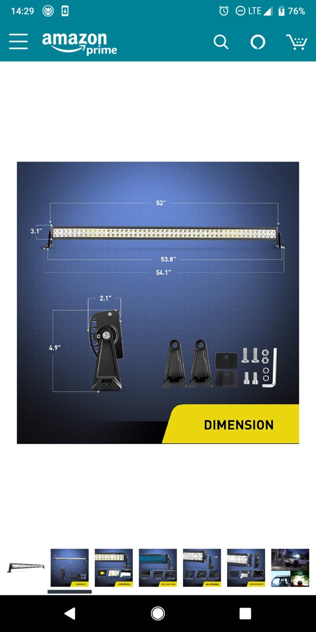

    That will definitely fit the 42" in the rear. The 52" bar is 52" exact without the mounts, so, definitely going to need something out front...
