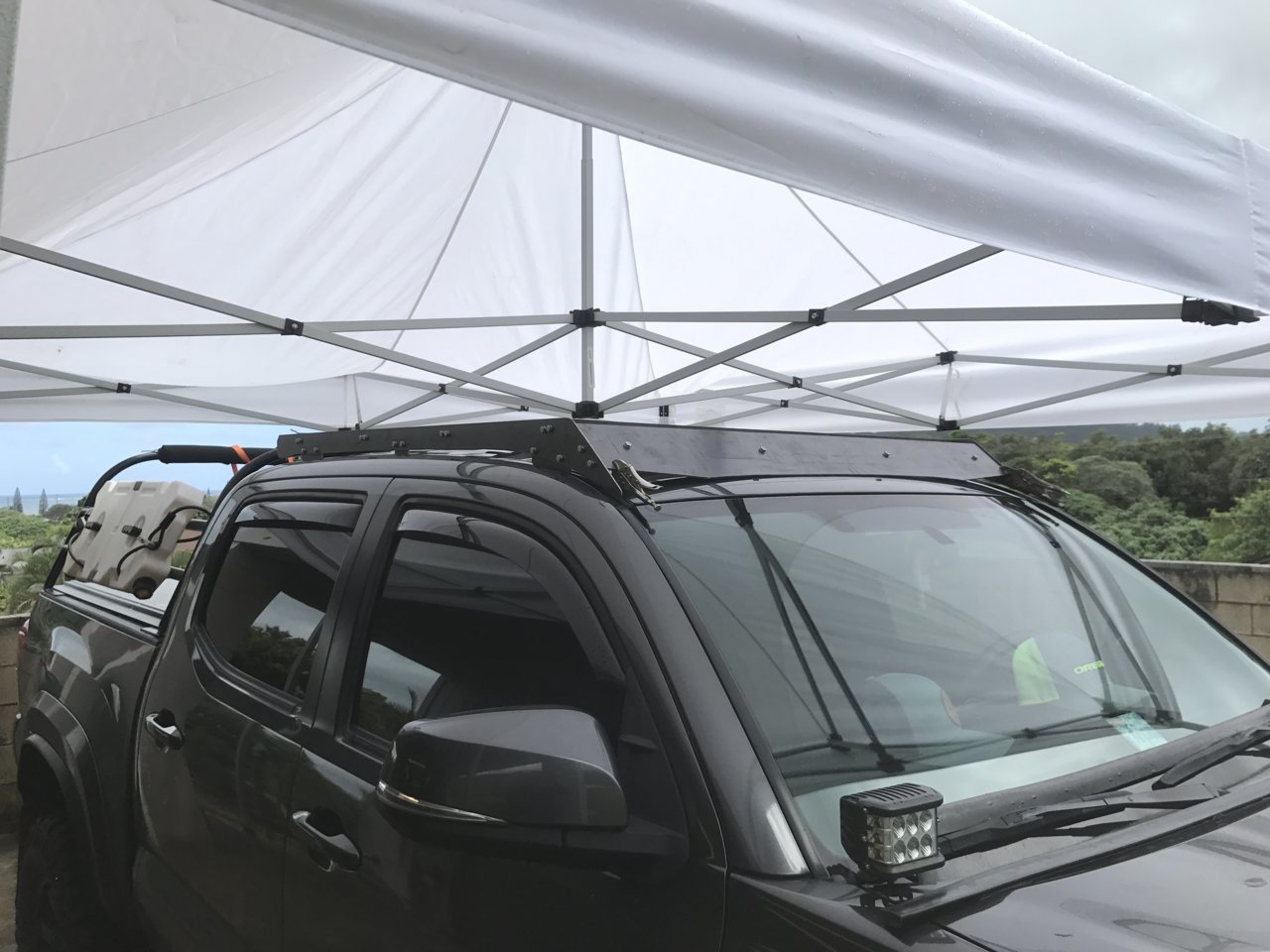

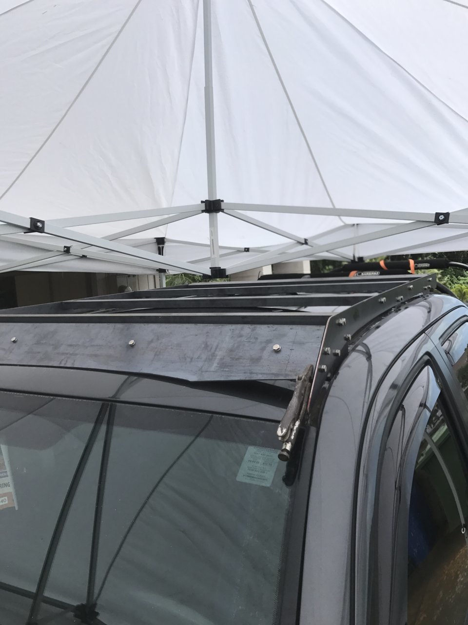

    How did you mount the c channel? Just bolt a piece of angle in there? That’s what I was wondering

    I had to cut everything to size and then drill one hole on one part and then mark the other part and drill a matching hole
    Everything is bolted together. Roughly 55 bolts are holding the entire rack together.

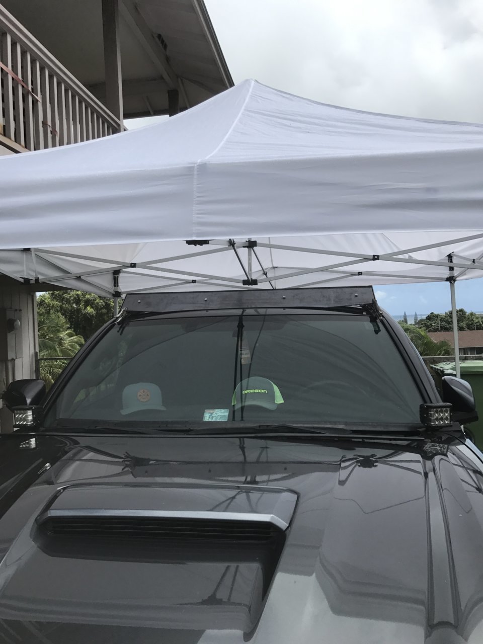

    Sub'd for the win. Nice build. I'm in process of building mine from aluminum of similar outline. This is so inspiring that you did it in 3 days. It's taken me 3 months to cobble together parts and the side channels the way I want them, and still have to cut holes for bungees and hand holds. I went with extrusion from 80/20 because it's pretty strong, and you can mount accessories to it easily. It's just expensive as hell, but buy once cry once. Have to do bushing swap and finish my suspension lift today, then on to the rack.
    Great job again, so awesome.
    PS - on the wind fairing, did you cut straight across and find it was noisy, and then do the cutouts like prisnu, or did you mimic their fairing for other reasons?

    As far as the fairing, I know I didn't like the victory 4x4 and caliraised style, where there was just one long curve across the entire thing because I thought it looked strange. So I opted for the side angled cuts right from the beginning. I did have to adjust my center to clear the roof as well as I had to use a small piece of angle iron that I bolted to the back for rigidity.

    I’ll be doing the same with the 80/20 and aluminum. How wide of a piece did you use to cut out your sides?

    3/16", with the angles that will be welded to them being 1/4" x 1. I took it to a local fab shop with a cardboard blank, and had them plasma cut it for me, for some unknown reason. Came back all jacked up, so I had about an hour of grinding with angle grinder to get the shape perfect to the roof line of the truck. On the second side, I just bought the piece of rectangular 3/16 and cut it myself in about 25 mins with a jigsaw and metal blades. Spent the last week or so installing new suspension setup, little bit everyday. Will get to the rack next week.

    That’s my plan is to jog saw it. I was just curious how wide your sides are could you have cut them out of 4” plate or did you do 6”.

    This looks sweet! One question- how did you mount the cross bars to the side plates?

    I fabricated brackets from the c-channel for mounting the side rails to the roof and the cross bars and wind fairing to the rails

    Thanks! That's what it looked like in the picture with the paint. Looks like only 1 bolt connecting the cross bar to the bracket you made?

    Yes the cross bar to bracket connection is plenty strong enough with a single bolt. I used two bolts to mount the cross bar brackets to the side rail so that it would not be able to rotate
