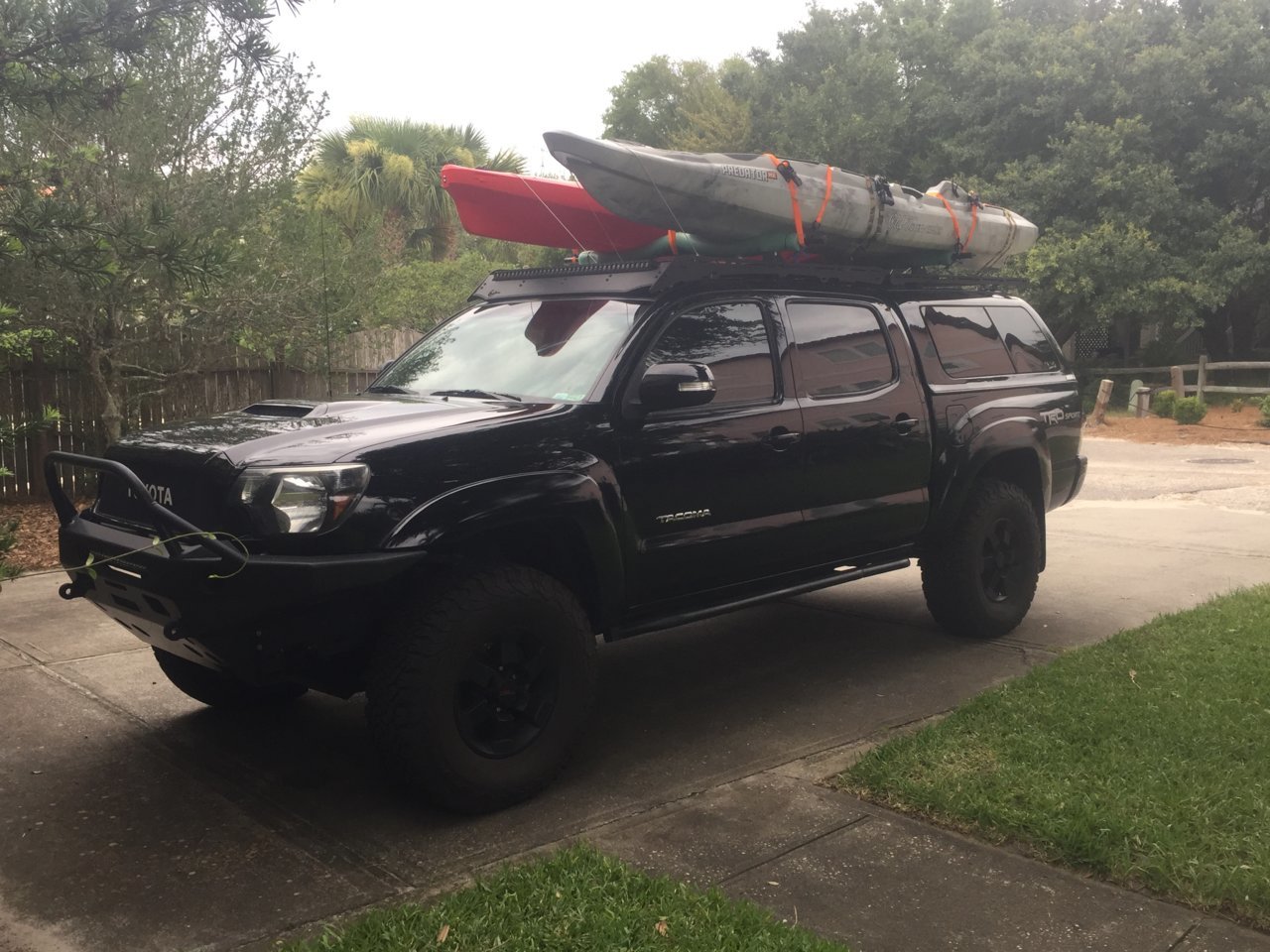

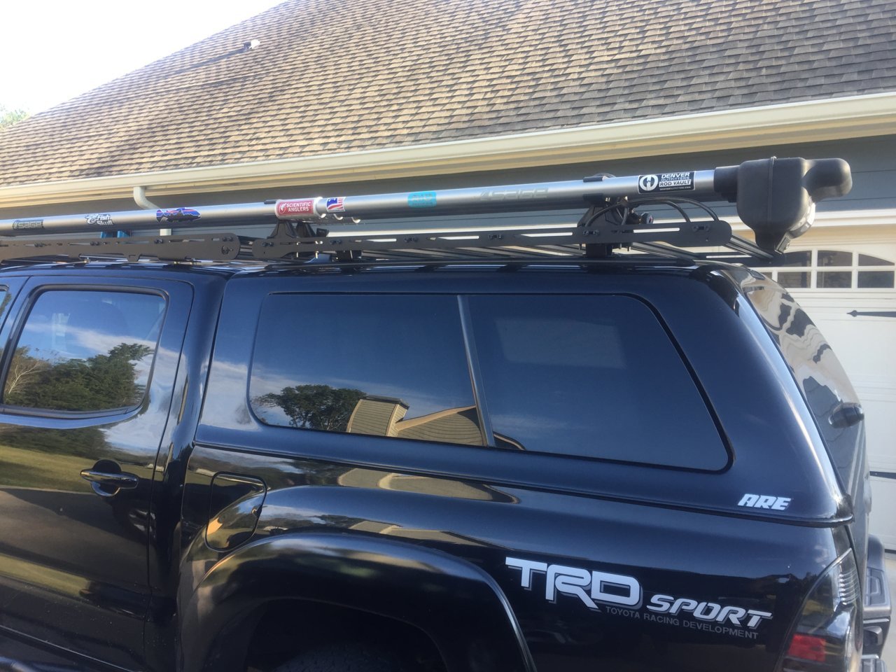

    I’m running Prinsu cab and top rack and use it to carry kayaks and a fly rod holder. The rod holder simply clamps around the Prinsu crossbar. For the kayaks, I ended up using my old Yakima towers to mount the wider round Yakima crossbars on top of the Prinsu rack. Took a couple trips to the hardware store to get the right nuts and bolts, but took 2 kayaks 6 hrs down the interstate with no issues.

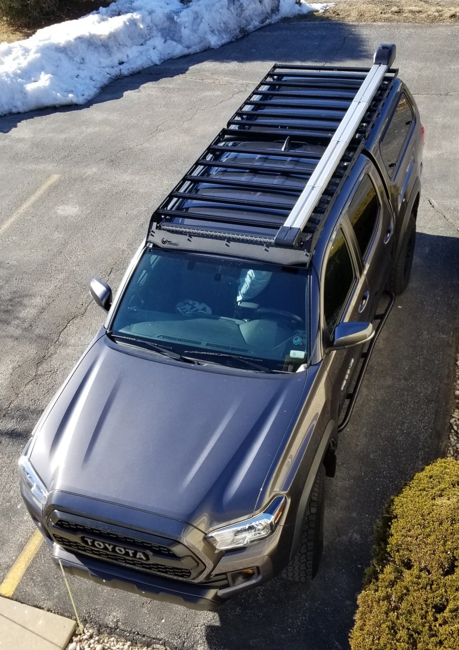

    Bought a Trxstle rod holder. Clamps to my Prinsu but needs the low profile clamps. 20200301_145155-02.jpg 20200229_150204-01.jpg

    Wow I love how low profile this sits. Do you have a picture of how it mounts?

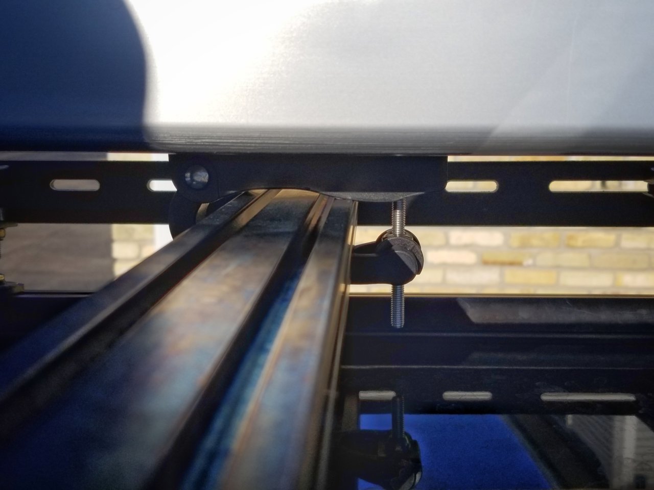

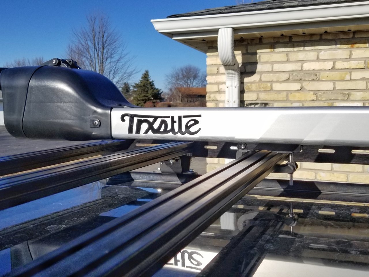

    Sorry, got distracted. These clamps wrap around the Prinsu bar, not perfect but good enough. The standard Trxstle clamp is taller and has locks, I had to buy the low profile clamps because the rack fits so close to the cap.

    Yeah that is nice and low profile. Looks awesome. Thank you for taking the time to take some more pics!
