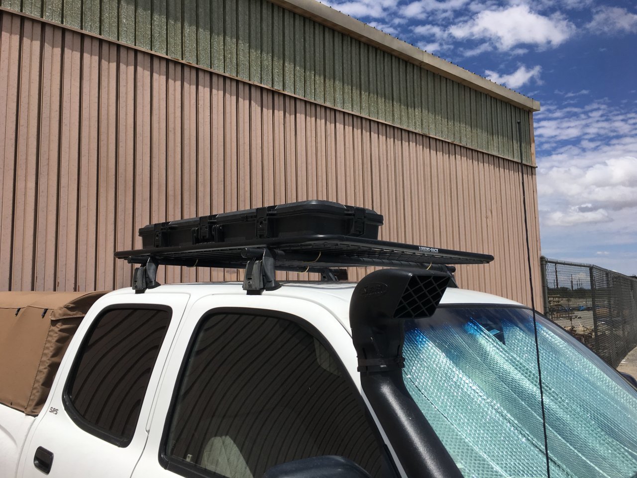

    569A082F-E5B1-439B-88B6-32C219BBBCA0.jpg Just get a Prinsu
    TragicBronson likes this.

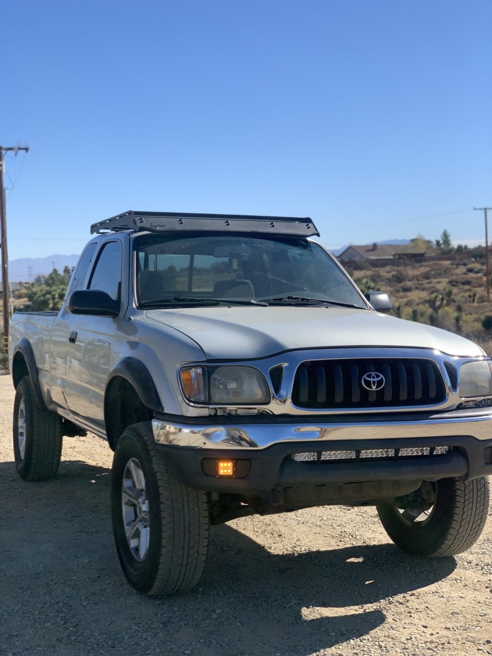

    When I bought my truck, it came with a dealer installed roof rack already. I ran that for years. Never really liked the way it mounted. (Rivnutted to the roof). It was really attached out in the weakest part of the roof. But I was able to load it with some light(er) camp items.
    Here is what I'm talking about where it mounted.
    I, later, ended up adding a basket (that I found on craigslist), just to making loading a little easier... but I never really liked the way it made everything so tall. The basket just clamped to the roof rack. It was alright, it did it's job, but I wanted something lower profile.
    This is with the dealer installed rack, with the basket mounted on it.
    This winter, I decided to change it up. My son found a Vijay rack on Craigslist. There are a few different brands that are all, basically, the same as Vijay. They are a steal knock off of, basically, a Prinsu. BUT... they are actually for 2nd Gen. It's made to bolt to the factory locations on a 2nd Gen. This requires one to drill and rivnut the roof, to mount on a 1st Gen. I've put enough holes in and cut off enough sheet metal on my truck, that I really didn't give a crap. I knew it was a rack that I liked, that I got for a hundred bucks, so I was gunna send it regardless. But some may not feel comfortable with this. (The same would be said for an actual Prinsu specifically for 1st Gen though, cause that's the way you have to mount them)
    Here's how a 1 hundred dollar Craigslist special 2nd Gen Vijay rack looks on a 1st Gen.
    Better pic
    It actually mounted in a pretty solid spot. Right at the gutter line on the roof.
    As far as the Yakima rack systems. I have no experience with this truck BUT I used to race road bikes when I was younger, and also worked at a bike shop, where I installed a lot of Yakima racks. They do, in fact, hold a lot of weight. They clamp at, pretty much, the strongest point of the roof. And if people have a problem with the Q towers damaging the paint... it's 100% user error. Either they mounted to a dirty surface, or they have the Q towers to lose, where they move around.
    I suppose the entire premise of this response is to say there are quite a few options here. They all work, some better than others. But there can be creative ways to look at it.

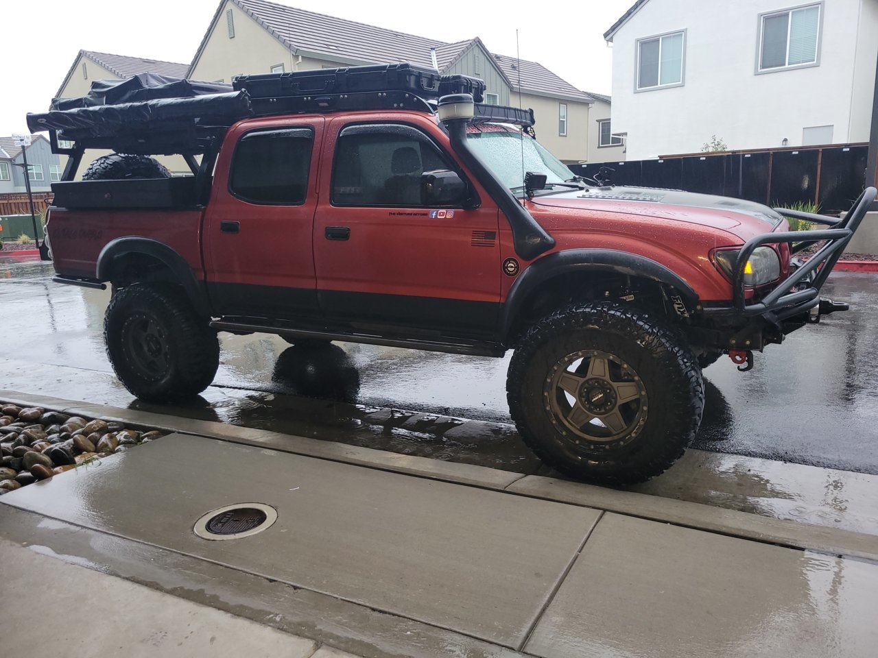

    The basket is no loger up there. I switched to a Prinsu knock off, because it looks cooler, and allows 2 Pelicans instead of 1.
    I don't really have much weight in the Pelicans. 1 Pelican is recovery gear, but I've gone through and switched everything to soft shackles, straps, synthetic winch line extension etc. The other side is Kitchen stuff and miscellaneous, there's no real weight there. Our pans are Cast Iron, but they are lightweight Cast Iron. That would be the heaviest items in that Pelican (2 pans).
    With the weight of the tools, spare parts, extra fluids, down low (on the bed rails), the truck is actually pretty well mannered (in terms of "tippy")
    Now, with the long travel making the truck 7 inches wider than stock in front (rear will also be going about 6.5 inches wider than stock) the way the truck is loaded, the center of gravity is probably actually lower than it was stock.
    The rack I have up there now is actually a Prinsu knock off for a 2nd Gen. So it's wider than it would be for a 1st Gen specific. It put the Rivnuts way out past the dented rails and close to where the body starts to roll down. The sheet metal there also doubles up in that area. The "feet" of the rack are basically bolted to the strongest part of the roof. I've never had any problem with any wind noise with this rack. I do get some wandering in cross winds, but I'd say that could be attributed as much to the RTT as it does the rack.
    As far as gas milage... Once I lifted the truck the second time, and increased the size of the tires the second time, and started adding the weight of the sliders, skids, winch, full size spare, RTT, RTT rack, etc, etc... Gas mileage went out the window. I, seriously, don't even care what the gas mileage is.

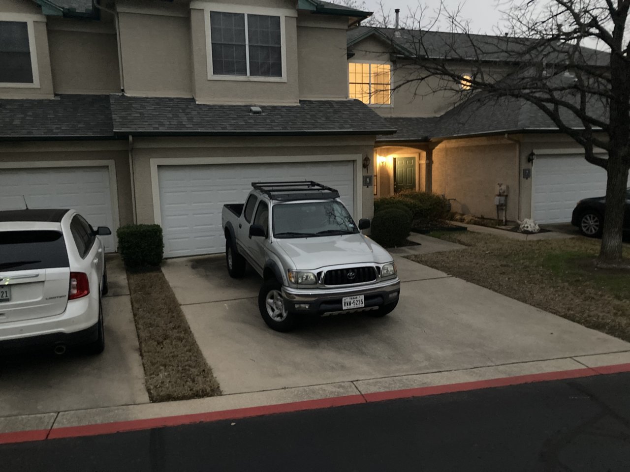

    Hey bud,
    I just installed my own Prinsu roof rack that I got for a discount back on Black Friday from CBI. My Tacoh is a double cab 4wd 2003.
    Long story short. Gas station is not a major “driver” in my daily driver. I’ve had a Marginal gas decrease - still 13/16 city/hwy give or take. I think my mpg is “normal” given the age of the engine regardless of the roof rack!
    edit: keep it simple stock and don’t exceed boundaries. Just like life.
