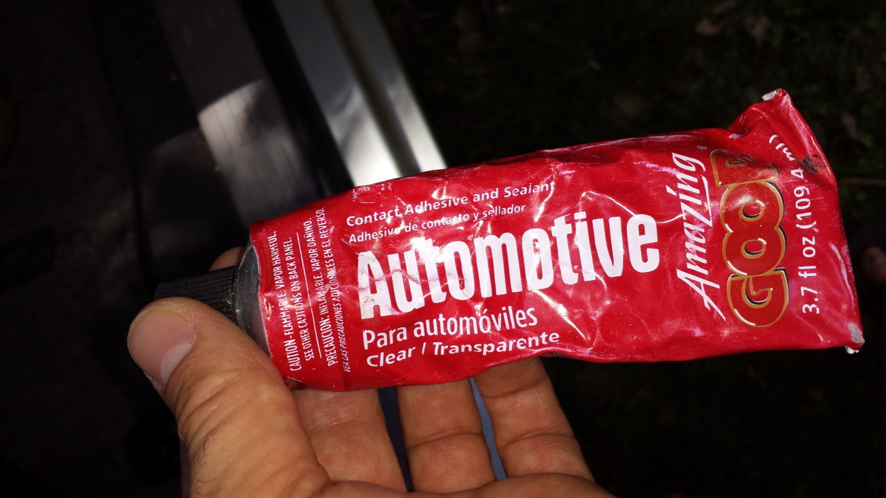

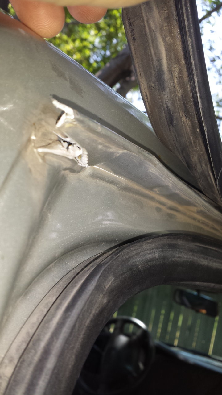

    No clue what the automotive grade calk is. All i have is this automotive goop. That crack is not metal cracking, just metal bending. I hope. So plan is to fill it with goop and bent it back with channel locks unless someone say that makes life hell for a body shop in the spring.

    did you try to use a plunger yet? that has worked for me in the past. put the plunger on the dent (stick it) and then pull.
    If that doesnt work, try a mallet. from the inside. hammer out the dent on the inside, then go from there.
    if none of those work, i guess bondo is an option, lol

    I think it is Too small for the plunger, SkunkMan17. But Thanks, i will look into it. I think one would have to weld to it and pull it out.
    Yes hammering from inside was the goal today. I think that normaly ends up best. But i could not confirm it is was double walled there or not. If i take it to a shop i would rather they pound or weld and pull it best they can and not bondo. Fill, in my LIMITED experience, doesnt last as long as paint on metal even when crumpled. But i might be wrong.

    PDR guys will use a combination of pushing from the inside and pulling with glue tabs from the outside.
    I had a car a while back that got hit with some light hail and was able to get it in satisfactory condition by myself. Watched some YouTube vids, talked to a couple friends that are in the PDR business for tips.
    The tools that I bought cost WAY more than having a PDR guy do it, but I got the satisfaction of doing it myself and now I have another set of tools in my arsenal.

    Wether or not glue pulling works depends on how much tension the dent is under. There’s also the possibility the dent can be pulled too far, but in that case, there are knock down tools to get the metal to go back in some.
