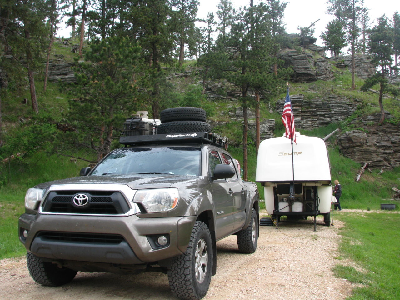

    Extra spare for both truck and camper mounted on a Baja Rack. Tires are secured by a length of threaded rod through the bolt holes of the rims with a piece of flat stock beneath the rack's rails and a large wing nut on top (<$5) to 'sandwich' everything together. We've made several trips from NC to western states with this setup and never had a problem. Gas mileage is 12-14. Photo from a dispersed site in Black Hills NF.

    Just out of curiosity, is that 12-14 pulling the camper?

    Yep - higher # is when mostly flat and dpeed 55-60. The Scamp's rounded nose helps. I get 9-12 pulling my brothrt's stick built which weighs about the same.
