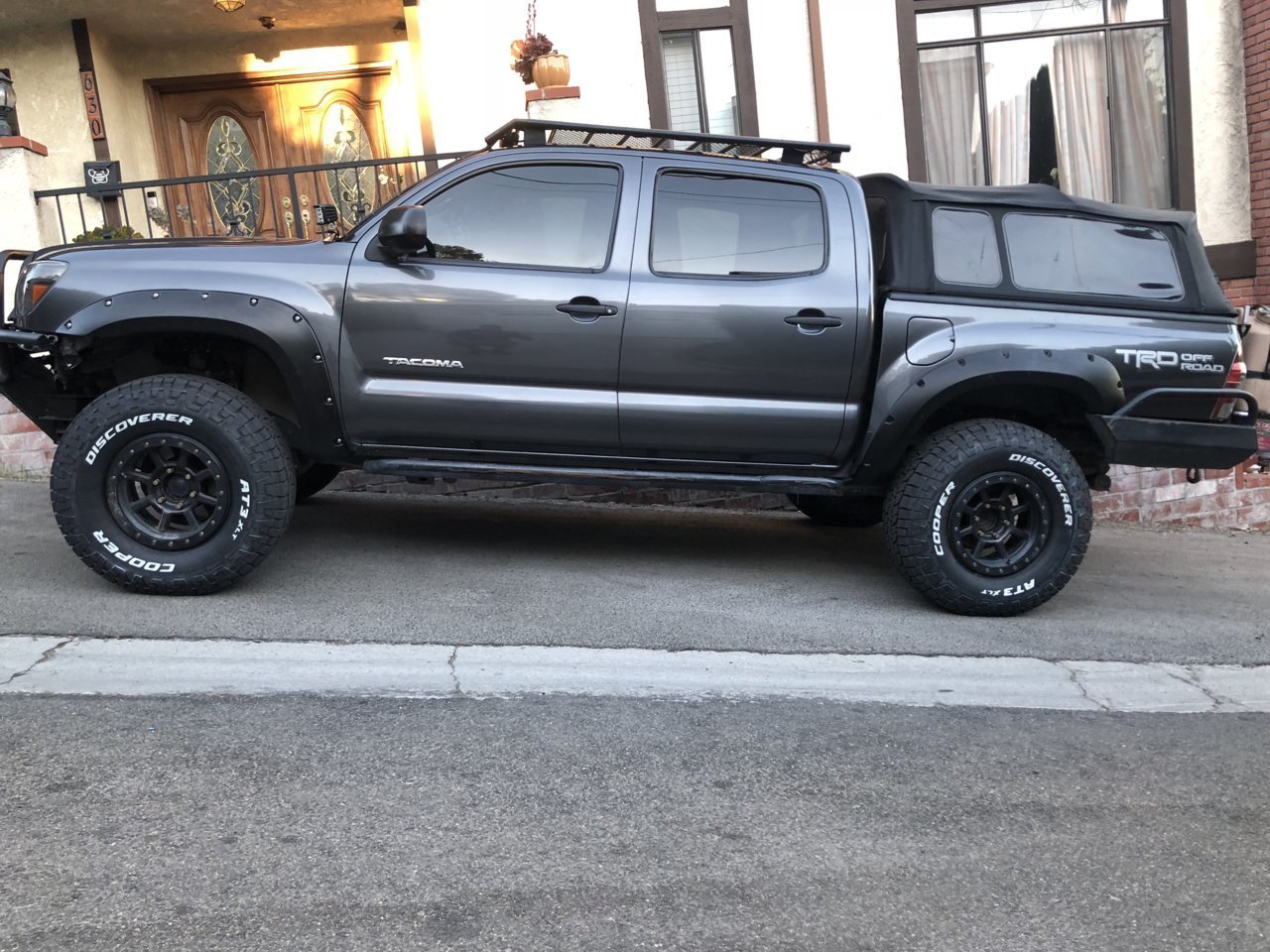

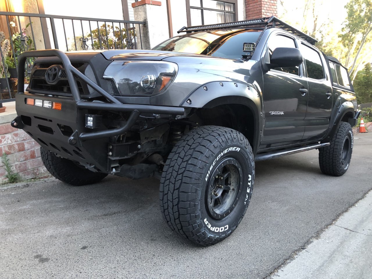

    Here's a customer's truck with one:
    Not the best picture of the rack, but you get the idea.

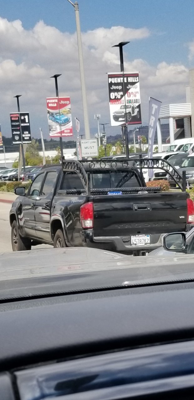

    Just be careful you don't end up with something like this:
    TS7xTaco, FishnTx and Cowboycove[OP] like this.

    Hahahahahahahahaha. Omg. Literally a fence. We are on a Disney job right now. I dont doubt he'd make some funny sh!t like that.
    GHOST SHIP[QUOTED] likes this.
