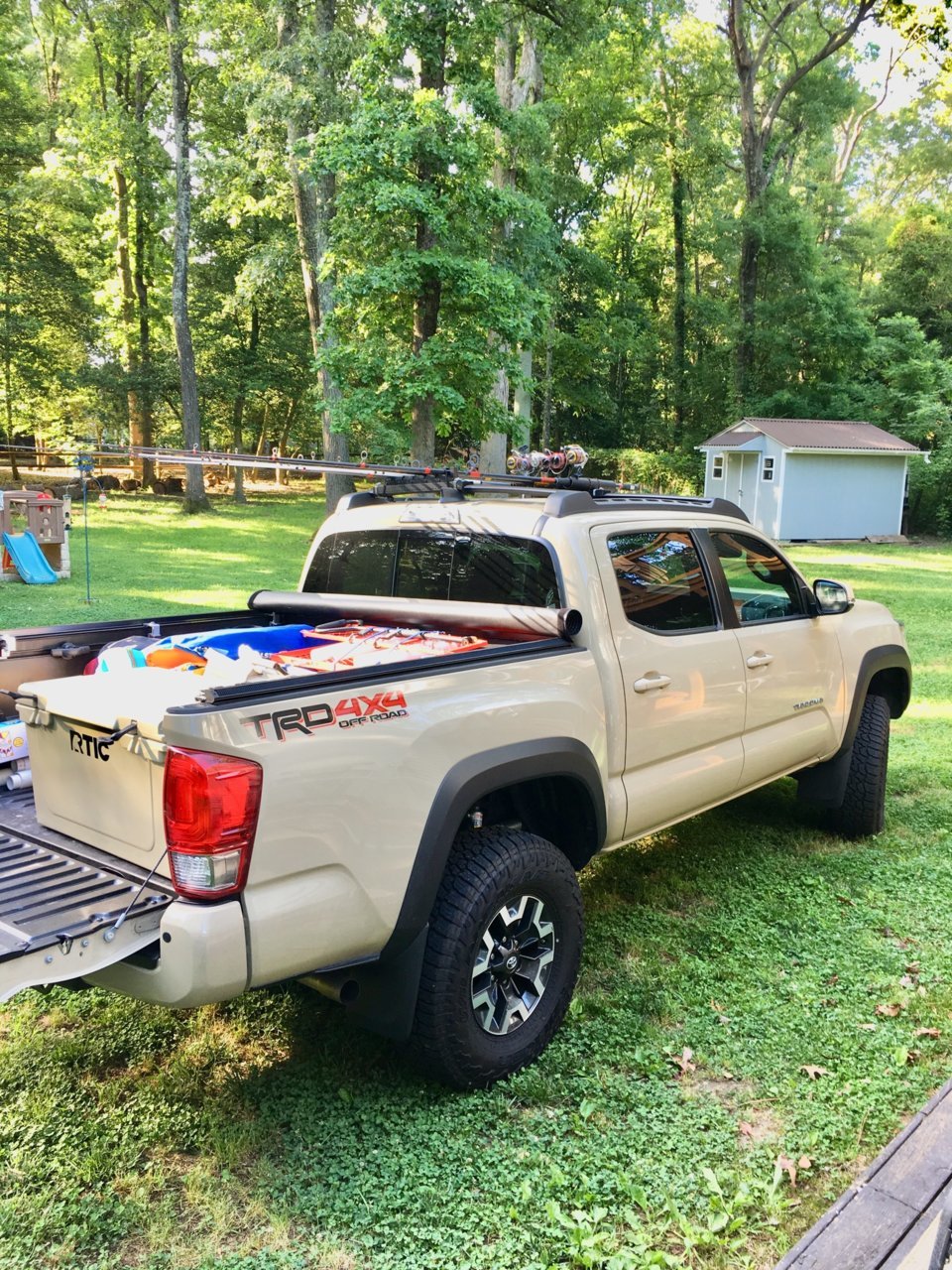

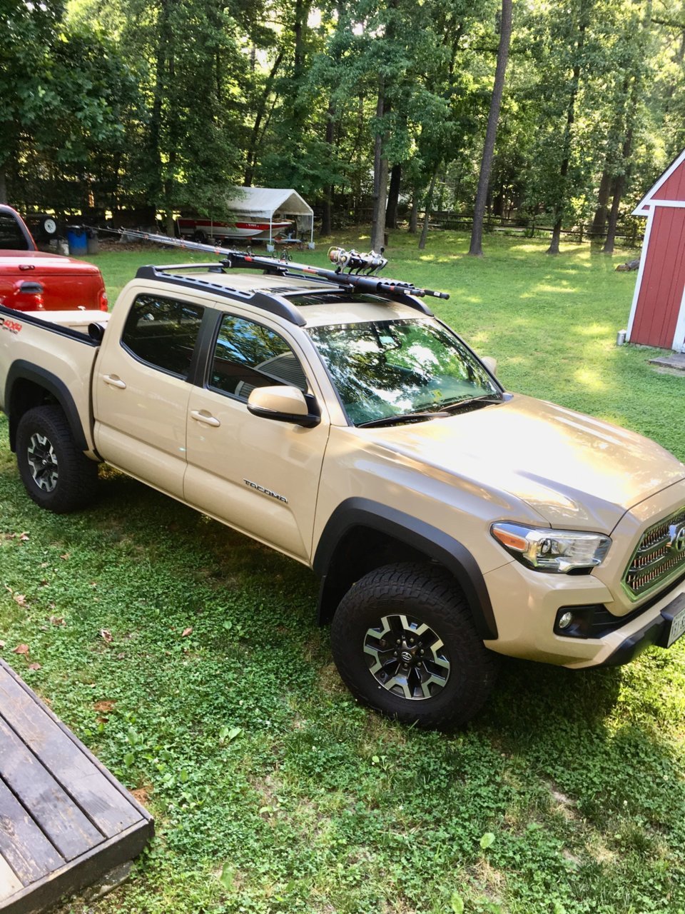

    Put my OEM rack to good use, built some DIY fishing rod holders a few weeks ago

    What are the details on the rod holders?
