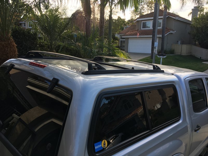

    I spent $35 at a junk yard on this factory rack (tracks and bars) off of a 97 4Runner. It was in perfect condition and wasn't missing anything, it just needed a little cleaning and some touch-up paint on one of the bars. Five holes on each side and some silicone and I was done. I love the factory Toyota look, and the fact that I can now add whatever attachment I want to. Looking for a luggage basket now so I can mount some LED's. IMG_6295.jpgIMG_6309.jpg

    Thanks for posting this. I had been debating adding a factory rack from a pull-a-part lot. What did you use for the hardware?

    All I had to buy was the correct size bolts and screws from Home Depot, and then I used lots of silicone to seal the holes. I also put some rubber caps on the bolts on the inside of my shell to protect my head. Super easy. 5 holes on each side and tighten it down, done!
    Let me know if you want to see some pics. I also mounted an affordable luggage basket to it that looks pretty great.
