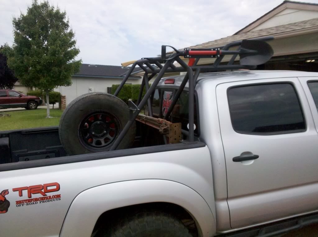

    But... There's these.
    I'm not looking to support much weight up front at all; a light, maybe a shovel or some traction boards...

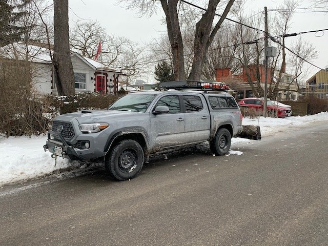

    I have an ARE topper with rhino racks and a cheapo extended roof basket that I reinforced so it extends about halfway over the cab roof. I've had it on there on and off for a couple of years. My 180 lbs son walks around up there sometimes to load/unload. We don't exceed the 220 lbs roof bar dynamic max but we have had more than that up there when parked.IMG_1107.jpg
    DangerPudge[OP] and Key-Rei like this.

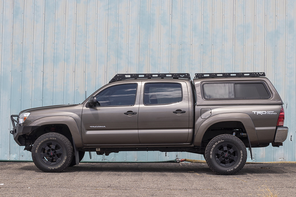

    2012 Silver Tacoma TRD Off Road Access Cab 6MT
    Full OME BP-51 kit, TRD Pro 16in wheels, go fast camper, some other cool stuff.
    Like this?
