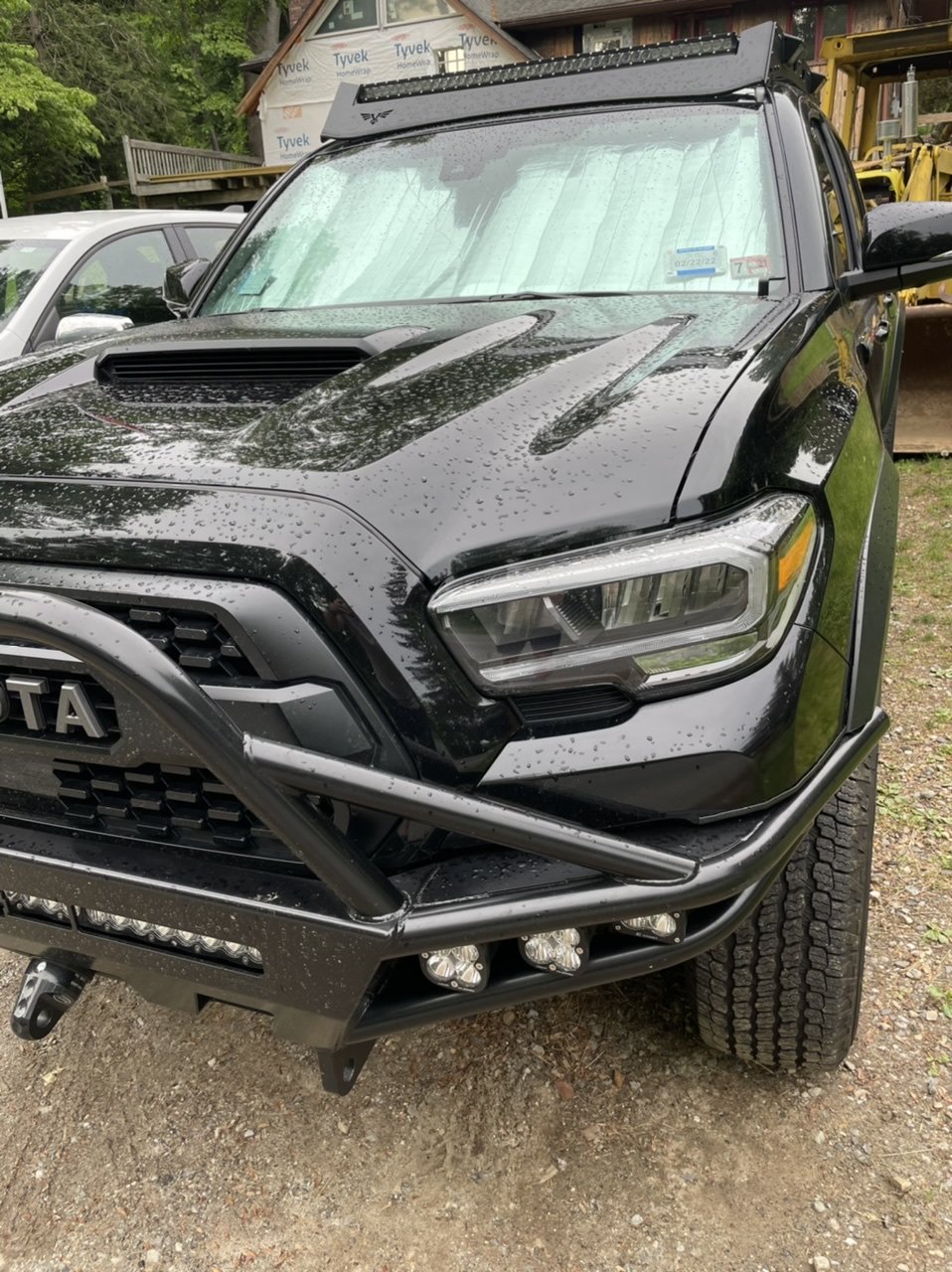

    Hey everyone,

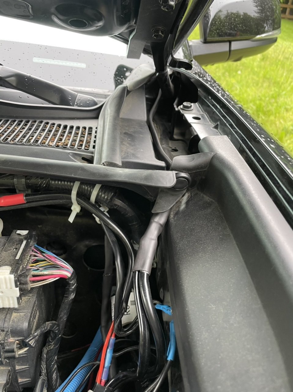

    Haven't seen anything here that specifically mentions routing wires from under the hood to lights/accessories on a roof rack. I had some success rewiring my roof rack lights yesterday so I'll share what I learned and hopefully help someone else in a similar position.

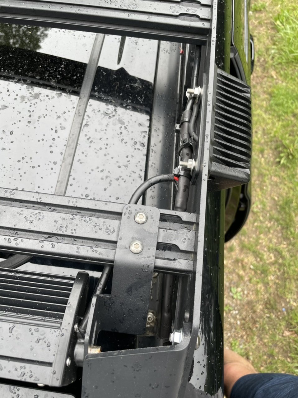

    I need to run 4 wires (2 hot, 2 ground) for my setup consisting of a 42" light bar and 270 degree down lighting. Previously I unsuccessfully tried to tuck my too-large wire bundle under the windshield gutter, so this time around I began with slimness in mind.

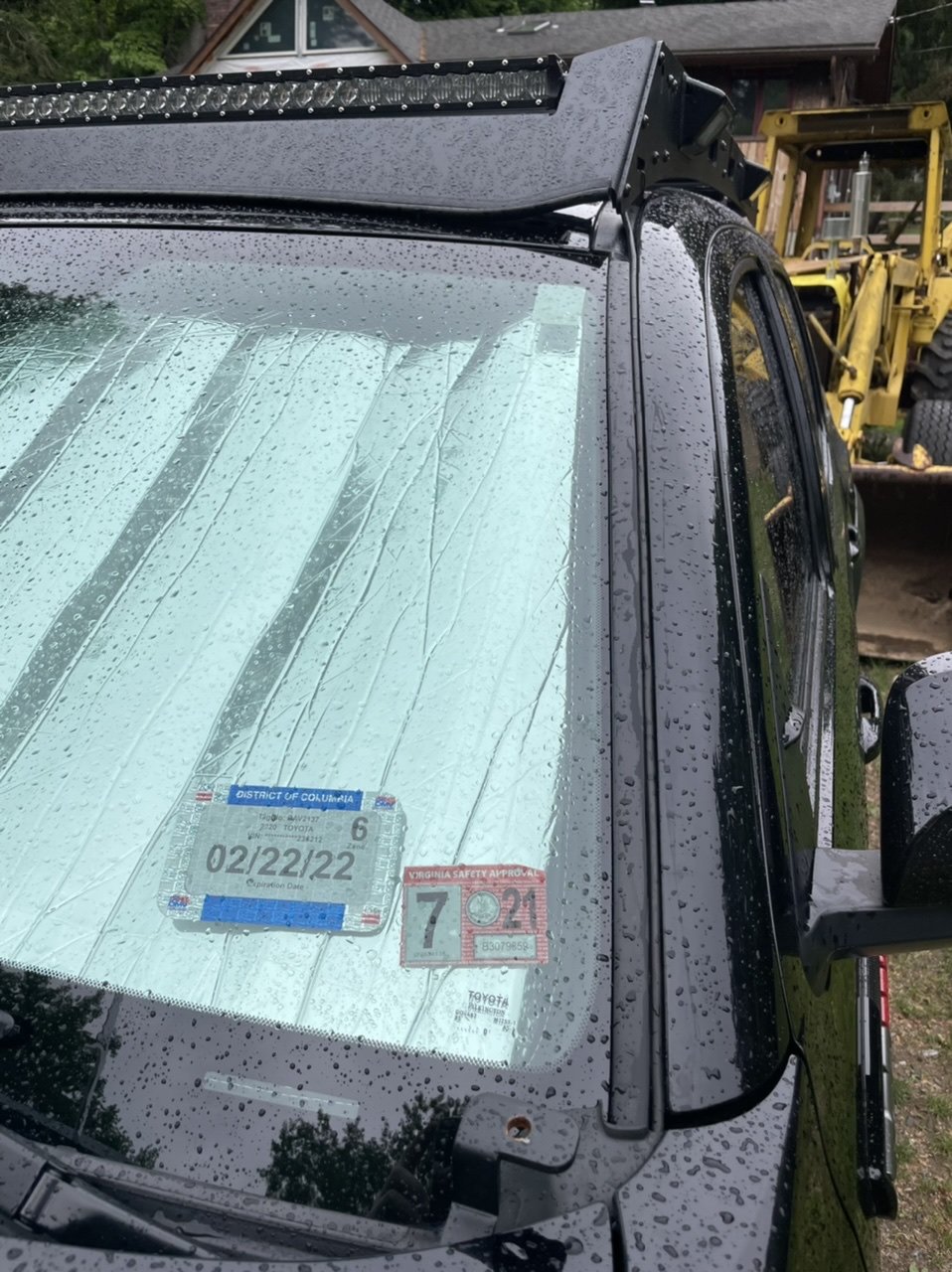

    I started with some bonded 16ga 4-wire trailer wire from Home Depot and wrapped that in 5/8" 3:1 heat shrink for protection. Routing from under the hood, through the grommet in the windshield boot, and tucked that bonded 4-wire vertically into the crack on the OUTSIDE of the windshield gutter using a deadblow hammer and a piece of cardboard to tap it in place.
    The fit is super tight and did not require any adhesive. It's nearly invisible except at the top where it pops out to go under the roof rack's fairing. I think this is a pretty solid method for routing roof rack wiring.

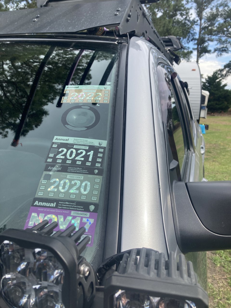

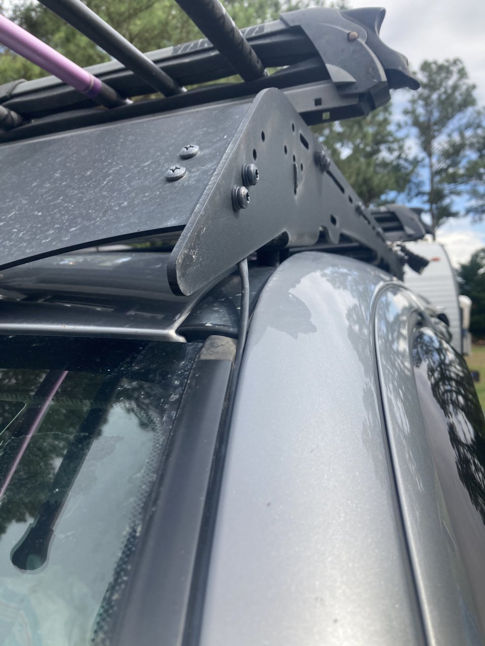

    This is great for those looking to run wires to the roof. When I first decided to run scene lighting it took me a while to find a place to run the wires. I ran the same rout as you but ended up using a black pvc wire sleeve. Instead of a hammer and cardboard to shove into place, I had a plastic trim removal tool that worked really nice as well.

    Do you have pictures of how yours turned out?
    I also used a trim tool to make room for the front edge of the bonded wire and then used the hammer to get it fully seated in the crevice.

    It honestly looks identical to yours other than a different rack and light set up. Once diode dynamics releases ssc1’s I’ll be redoing everything up there. I never realized how useful side lighting can be until I had it. I don’t think I’ll ever not have it again. Still debating on if I’ll run passenger/driver to different switches though. Which if I do, I now know I can fit 4 16g wires in that little channel thanks to your post.
