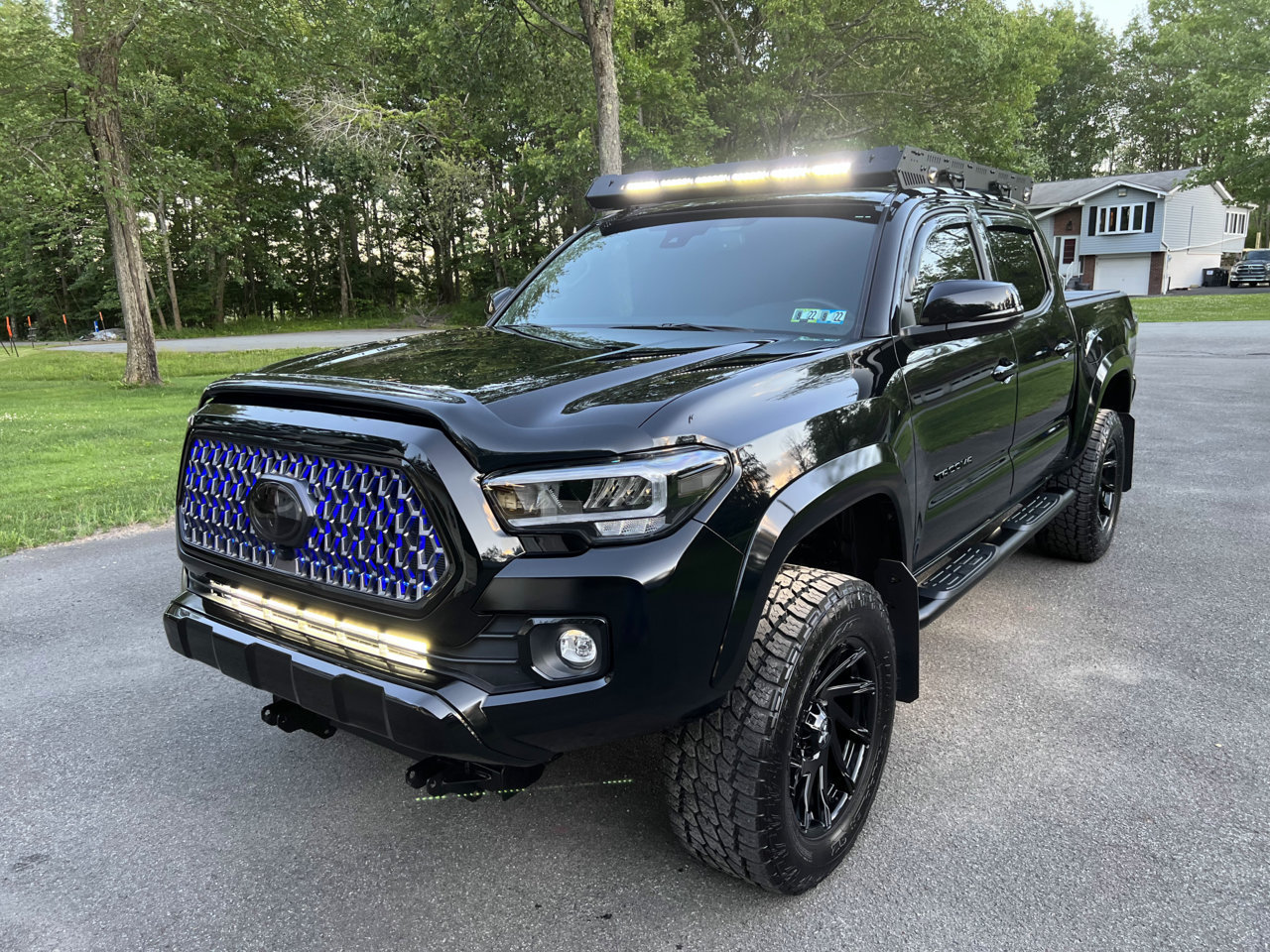

    In my UpTop rack I have a Extreme LED 38 inch bar. I converted the outside section from amber to white and combined the two feeds into one. So one switch lights up the entire bar.

    Truck looks good

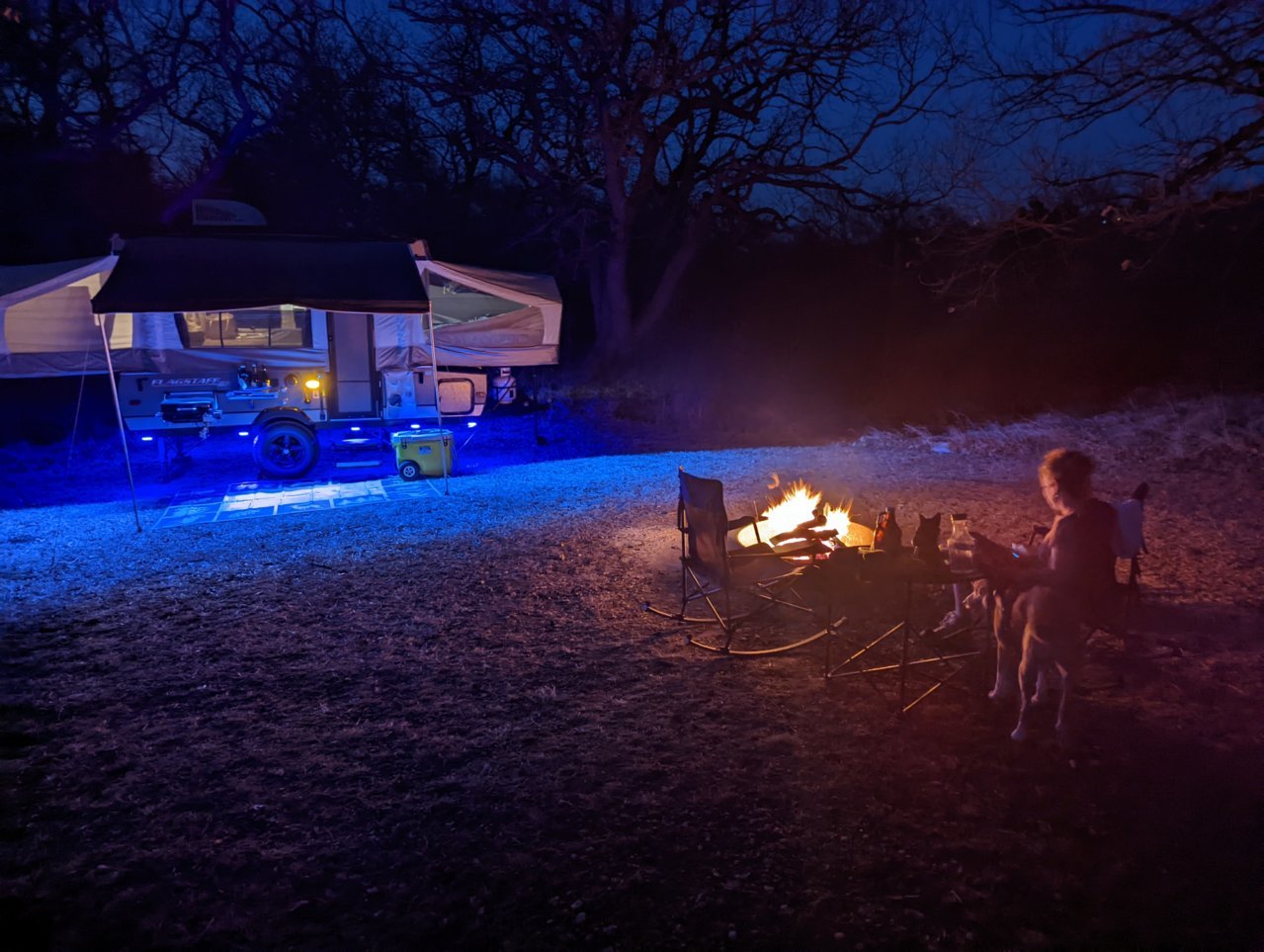

    I personally think that overheads are for looks. There are better solutions to light. Cue my opinionated rebuttals to your use scenarios: :cookiemonster::cookiemonster::cookiemonster:
    -- Kept on while camping where there is no other light. How does this work with battery etc, ? And are they effective - meaning not just a blast of light
    I find that most overhead lights when camping are harsh and useless (with the exception of having light over my cook station).
    I have discovered that downcast footwell or puddle lights are FAR more effective for general camp lighting, plus they aren't nearly as consumptive on your battery. Edit: Extra bonus, foot lights don't piss off your neighbors. There was a recent camp trip where I had to go visit my neighbor 250 yards away and yell at him to either shut his lightbar down or point his truck in a different direction, because that shit was blinding as fuck.

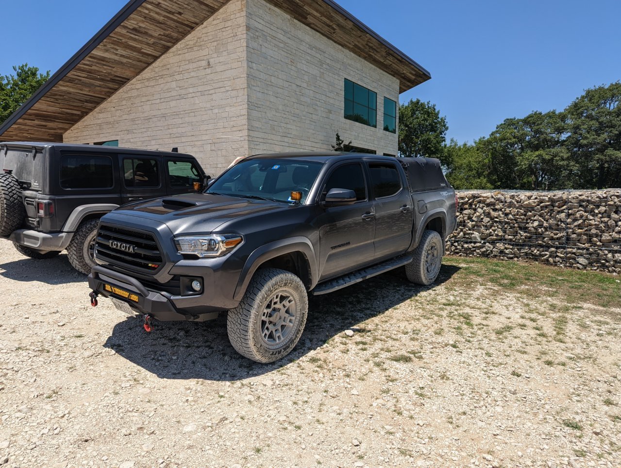

    Possible. However, you get more bang for your buck with bumper mounted lights. Overheads might be used as a supplement in my opinion, but they should not be your primary. See below.
    -- Snow driving (which is something I do most every day in winter, although not much at night)
    Not ideal. You want lights as low as possible for snow, dust and fog (and with a well defined cutoff). You want to light up the trail without lighting up the airborne particulate. Running overheads would be the same as running your brights in the snow, only magnified. You just blind yourself.
