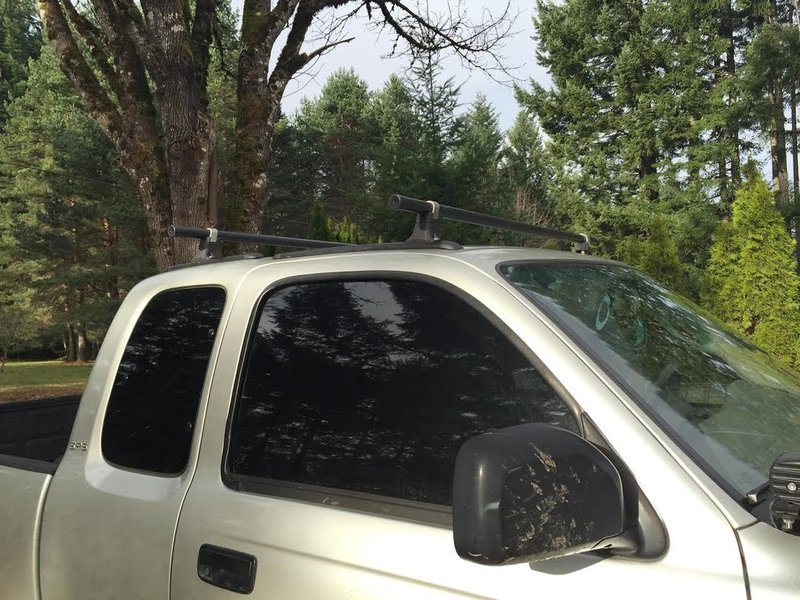

    Hi, Heres how I did mine. I had a rack shop install tracks on main section of the cab and on the hump. So 4 sections total. This allows you to adjust the cross bars in right location for all applications. I didn't go with 2 full length tracks due to it being common to want to lift away from roof right at the start of the hump. I can take more pictures if you want more. just let me know and hope this helps..
    Tim

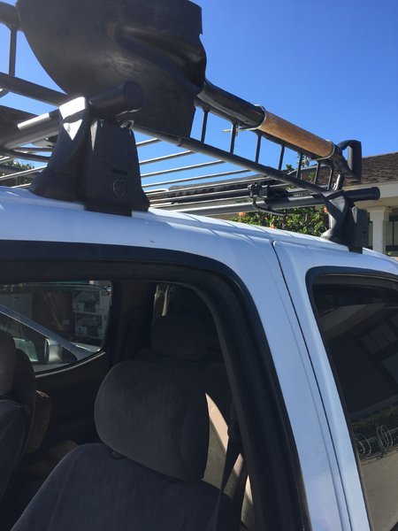

    Yakima Qtowers w/the correct Qclips or the Tule equivlent should work. No drilling and I believe you can mount the rear towers with your rear flipout windows. I would double check that with either Yakima or Thule though.

    That's about the neatest rack install I've seen on a truck cab. I've always had Yakimas but they were on my topper. Good job!
