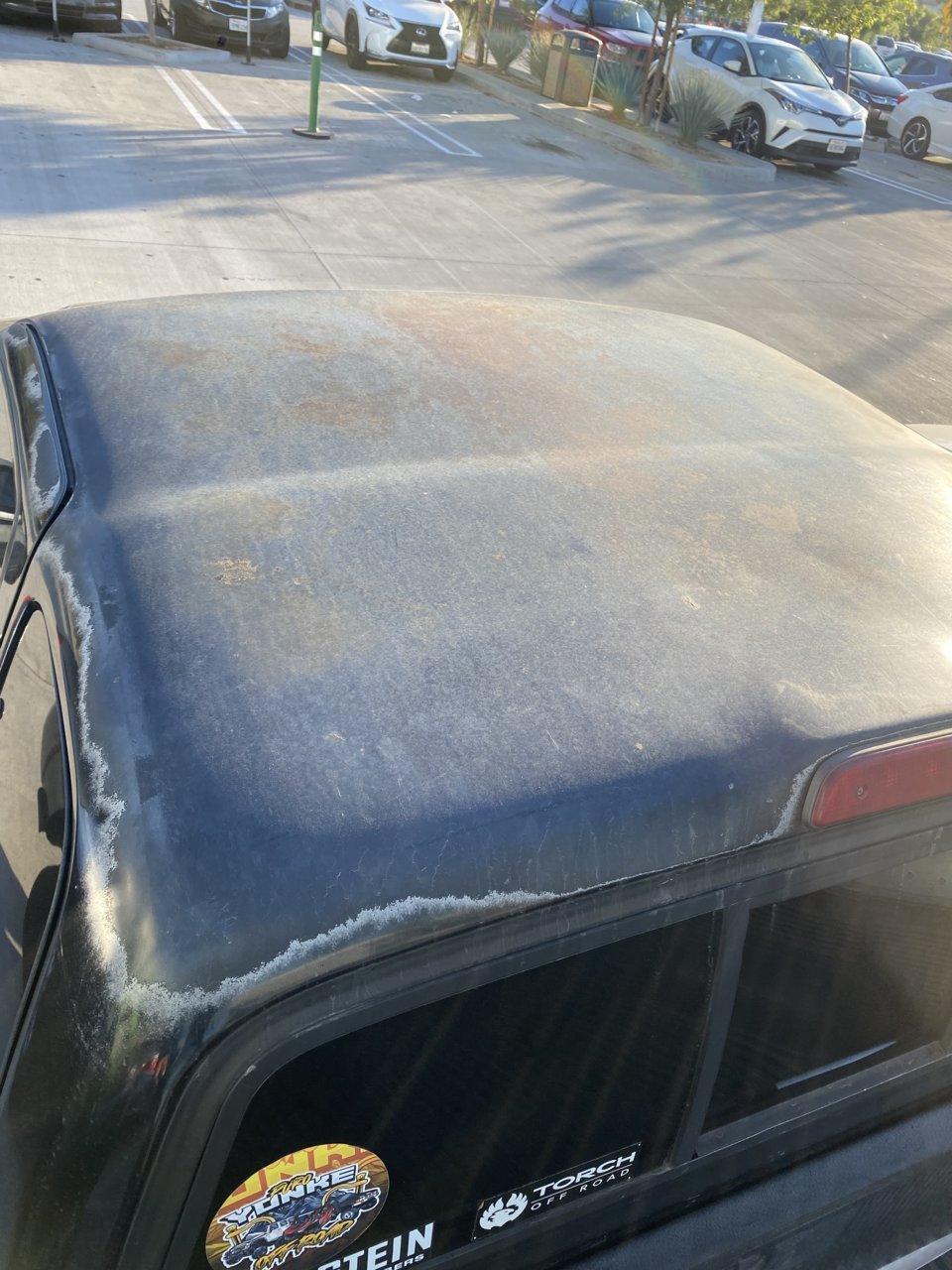

    I would start by getting the roof fixed
    and then now that you have a nice roof, don’t drill holes in it

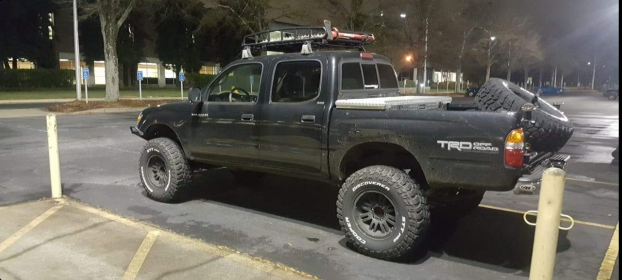

    I had a higher profile Smittybilt rack with round halogen lights mounted to the front, so it had a negative effect on my mpgs at highway speeds and make a good bit of wind noise. The rack itself started to rattle where it was mounted too after a couple years.
    I took it off, but because it required drilling I had to plug the holes. Used rivnuts and bolts. If I could do it all over again I would never have installed it in the first place.
    It was good for having extra tie down points when carrying large items in the bed but that was about it. If you really want a roof rack, get one that doesn't require drilling your roof. There's really to upside to doing it and it will just create headaches for you years down the road.

    I don't have pictures but Smittybilt sells the mounts for the Defender roof rack separately so you can buy them to possibly mount other custom racks. You have to drill 8 half inch sized holes and it uses wellnuts (rivnuts made with rubber basically) that you drop into the holes and then thread the mounting bolts into
