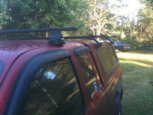

    This is a pic of my setup:

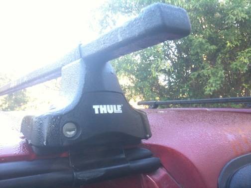

    Here is how the Thule wraps around the door. I'm sure the Yakima is very similar.
    Even though you don't have a camper shell this might help you for future reference. On the back I have what they call "artificial rain gutters." They are like $50 for a set of 4. Then I have the Thule gutter mounts. Other folks with camper shells have rails, or tracks, installed on the top. These work well too but the artificial gutters were already on the shell when I got it.
    Hope these help.
