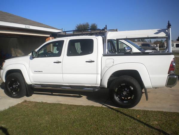

    moto metal 16x8, 165-70R16 r/t, baja roof basket, customize tops,avic z2 upgraded,all pro rear bumper
    Cost me lessthan $100 to do it....with sides, probaly $100....and you have extra 800lbs top load. That is if you have a ladder rack....

    Are you using the cantilievered bars out front over the cab as well as the basket ?

    The roof basket is made by Baja Rack. Can take around 300 lbs. The Trac Rac ladder rack is another 800lbs. I haul a lot of speakers when we have gigs. The basket can take at least 3 big cabinet loaded with 15". The Top rack carries a big stage kinda platform with all the stands. Never had a problem... The bars that I used was from Home Depot. Kind of those bars they use in Road Sign... But I only use it on soft tops. I have couple of pics in my profile.
