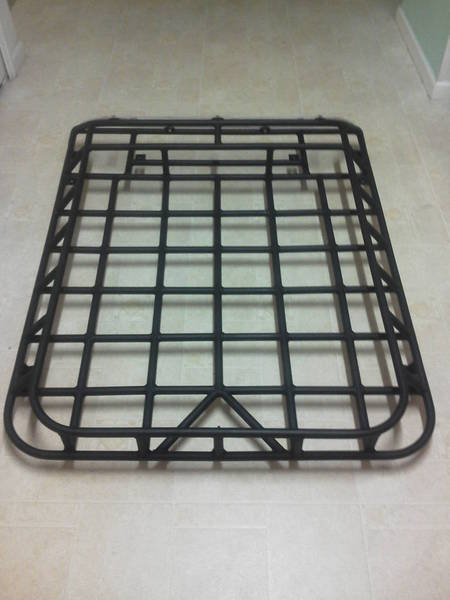

    It was originally going to be an 8x8 inch grid. after a little talking, Ryan decided he wanted a guard to protect the back side of the light. I drew that into the plans, but never adjusted the floor for it. once it got to that point in the build, it just made more sense, structuarally and aesthetically, to go with the 6x7 inch grid. It only translated into about 4 feet of extra steel, which I had, so i figured a tighter, stronger floor would never be a bad thing.

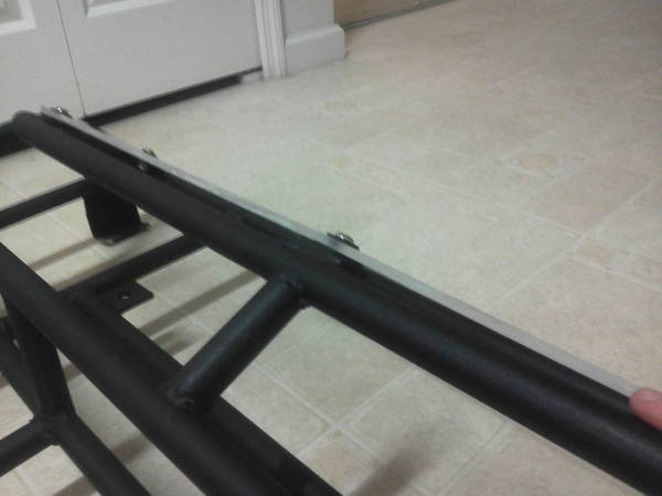

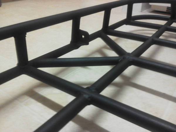

    Final product. It will be going on Ryans truck this saturday.
    it was dark out when i took these, which is why the rack is in my kitchen :eek:
    Had to alter a rear portion of the floor to make room for the shark fin antenna the new trucks have
    1/4'' acrylic wind fairing/light guard on the front. should be pretty durable stuff. you can guage the thickness with a little part of my finger on the corner of the picture.

    what are the the mounts on the roof rated to hold? i know OEM rack hold what 100 or 150 pounds.

    i don't think they're rated, but they'll hold A LOT. reason the factory rack is at 150 is for two reasons. 1: the crossbars are only so strong 2: keep those out there with less common sense from loading up a roof rack and then hauling ass around a turn like the truck's empty, and flipping a top-heavy truck.
    interesting fact about #2, years ago yakima and thule racks were rated for 250 lbs, but due to a series of lawsuits, they had to lower the rating to the current 150 or however many lbs they are currently rated at, for the very reason of topheavy hehicles rolling over.
    as for the bolt hole strength, it's strong. you have 8, 6mm bolts. compression wise, the roof is very strong. think about the "i rolled my truck" threads where a truck that has not only been upside down, but done so with force, has a roof that is only compressed an average of a few inches. shear strength is also quite good. i've actually had a winch line on my roof rack while wheeling once (under tension) becasue i was getting dangerously close to rolling.
