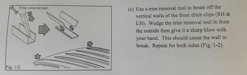

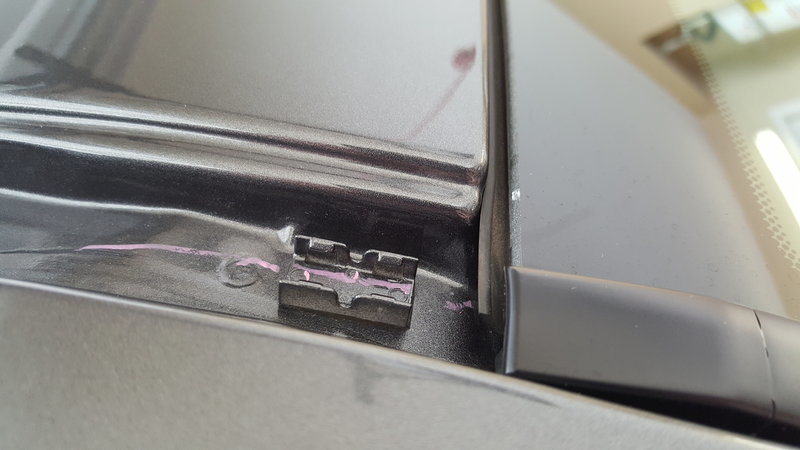

    I'm in the middle of installing my factory roof rack now. For this step are they referring to these towards the very front? 20170124_104114.jpg 20170124_104047.jpg

    How hard was the trim to remove? Do you think its possible to reinsert if the clips aren't broken? Also do you think you can remove the trim starting from the front? I only want to grab the front two bolt holes for a light bar and cant find any info on it. Thank you.

    I left mine and didnt break the walls off.

    To answer my question yes those are the ditch clips that I had pictured. I had to cut them with an exacto knife. The trim was very easy to remove. I'm pretty sure I could put the trim back on even though I cut off the ditch clips just using some double-sided tape if I ever wanted to remove the roof rack and put them back on.

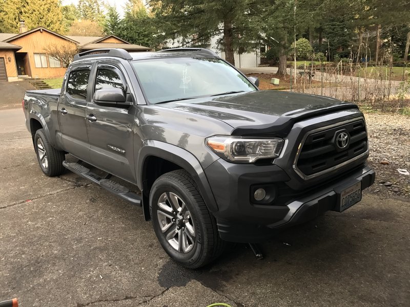

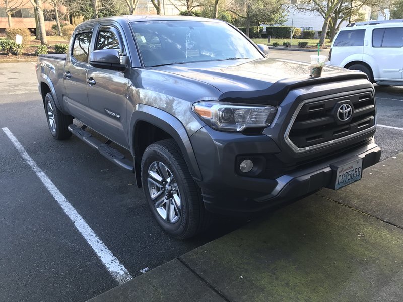

    Just installed today
    Here are the pictures before and after

    Make sure you seal the bolt holes, otherwise water will pour in during rain or washes.

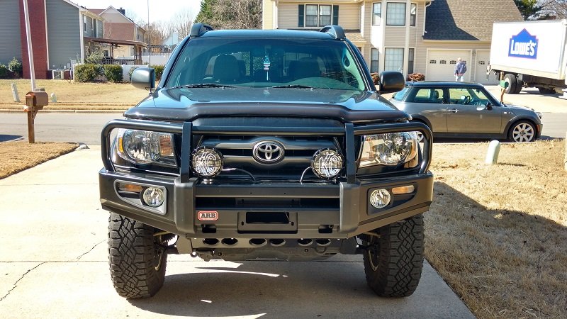

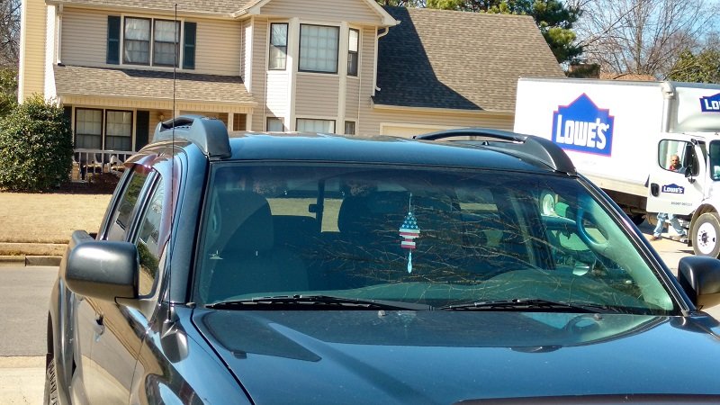

    So this weekend I finally got around to installing my new OEM roof racks on my 2nd Gen (updated model PT 278-35140 that fits 2nd & 3rd Gens). Has anybody else noticed that the Passenger side crossbar appears to be a different shape (almost like it's bent at an angle) compared to the Driver's side which has more of an arc to its shape?
    The install went great and I love the look, but I've noticed after looking through a other of pics here that the 2nd Gens appear to be the same shape on both sides and the 3rd Gens seems to look like mine...just curious if anyone else noticed and if it's maybe a design difference between the old model (PT 278-35130) and the new model (PT 278-35140)?
    Here's a pic where you can see the "bend" I'm talking about on my 2009...

    Sorry to bring this thread up from the dead but I think that's just an optical illusion. The driver's side looks like it has a bend when you're angling the truck in that direction.
