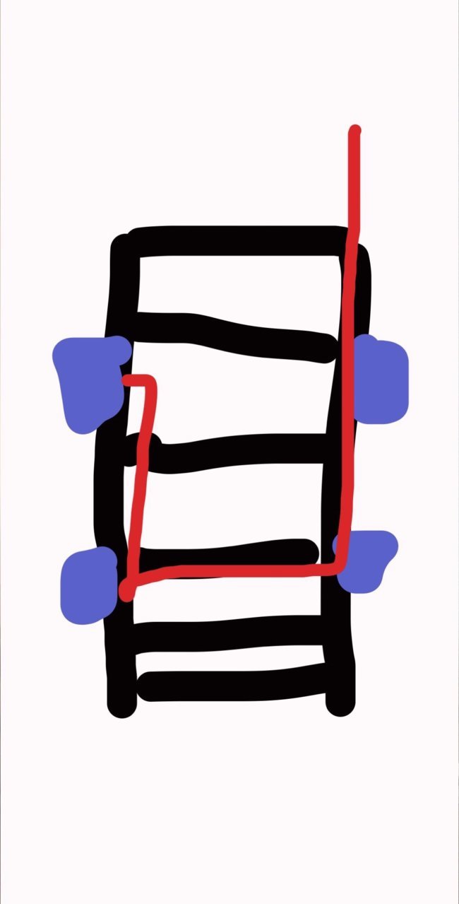

    I am trying to figure out how to run overhead scene lights on my Prinsu rack. Does anyone have any pictures/diagrams of how they ran their wires for their scene lights from start to finish for a clean look?

    Along the crossbars and down the windshield

    Here’s a crude drawing of how mine is ran. I tapped the grounds into the ground on my lightbar and ran two positive wires down the windshield to control each side independently8AAFEEF5-AF49-4292-9C8A-3428CF3476CF.jpg

    I did the exact same, no tape or anything, stuff that thing in there. Also lmao looks like a fire truck

    I used zip ties lol

    I have seen this and this is a slick way. I have a roof rack on a bed camper shell and think after seeing these I may just run the wire down between the shell and the cab to the frame and run it to the front from there. Thoughts?

    Yes Sir, That's a good idea to run both on cab n camper rack wiring between the cab so you can route the wires together. :thumbsup:
