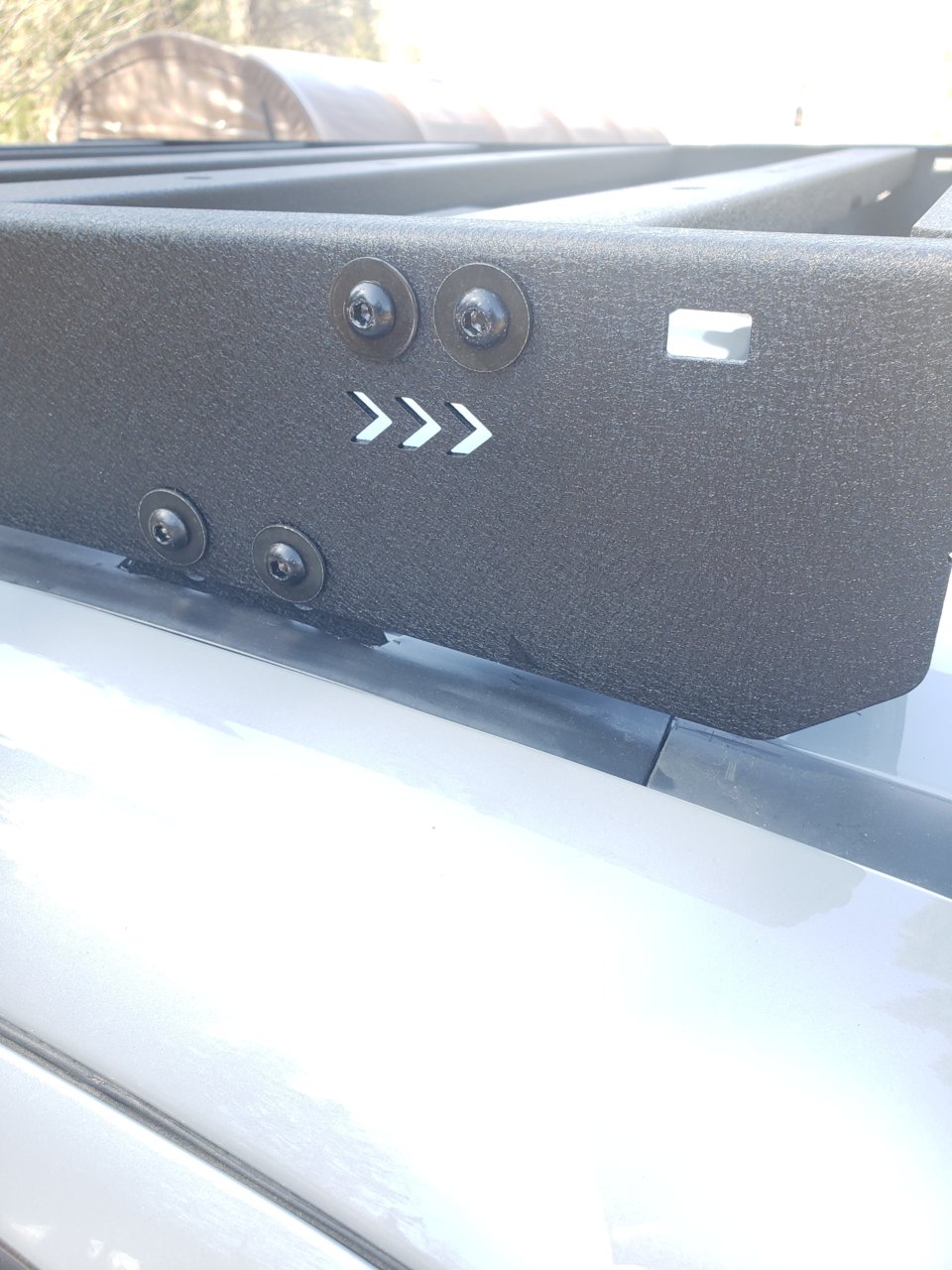

    Just installed my roof rack a few days ago, I sliced up the weather stripping enough to fit the mounting brackets.
    If you're in the northern areas, use marine silicone sealant, they are designed to withstand salt.
