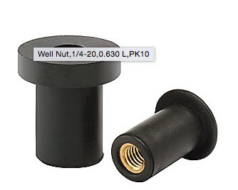

    These are what you place into the 8 holes you drill for the compact Defender rack (the full size rack requires more holes), these are what expand underneath the sheet metal and keep the rack mounted firmly to the roof. The compact rack I got is rated to hold up to 150lb

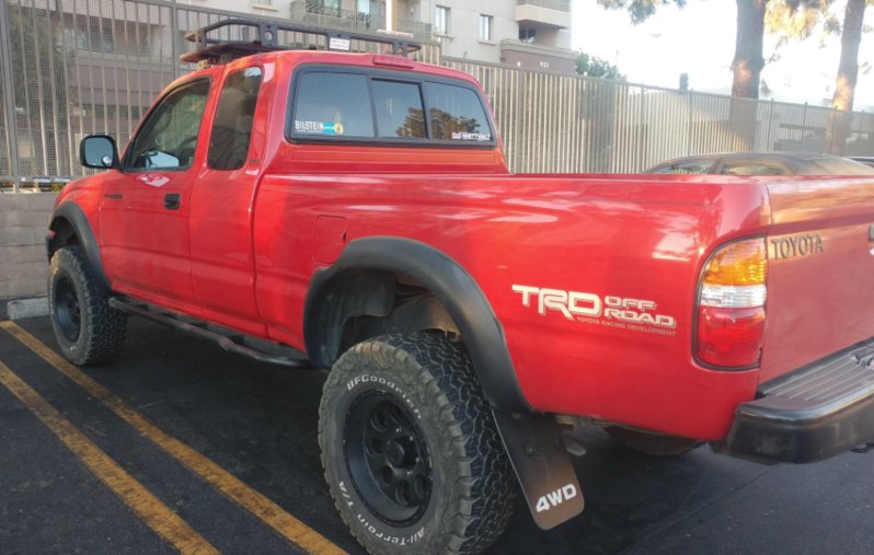

    Ask and ye shall receive :D
    Screen Shot 2016-09-09 at 5.12.23 PM.jpg Screen Shot 2016-09-09 at 5.12.32 PM.jpg
    Compact Smittybilt Defender roof rack, had to drill eight 1/2" holes in the sheet metal for the well nuts to go in. No need to remove the headliner or do anything from inside the cab, just place the well nuts in the holes, line up the rack and attach it to the well nuts with the provided screws. The screws expand the well nuts inside the holes as they tighten, holding the rack securely in place. I love it, taken it off road on several very rocky trails and have had no issues, except for some squeaking coming from the hinges. Some WD-40 fixed that right up.
