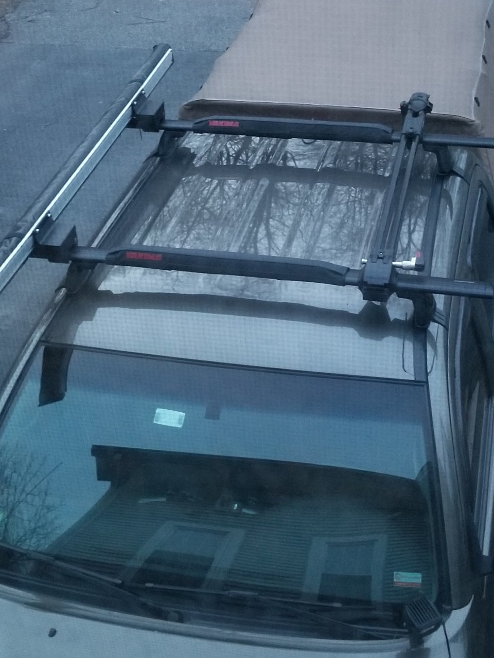

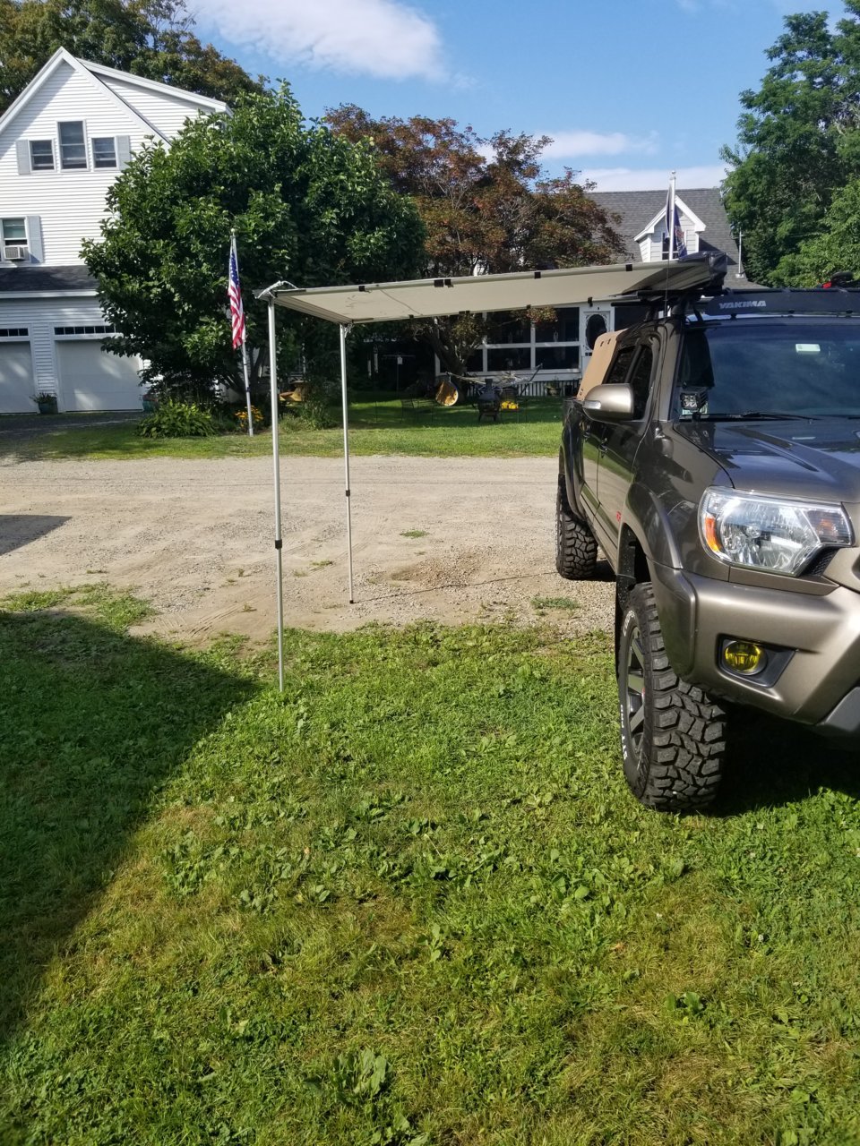

    With aftermarket Roof Rack such as Yakima and Thule you don't need to remove those. The landing pads actually sit right on top of them. I have the Yakima Jetstream System with an awning and bike attachments.

    That's an older pic but you get the idea

    How noisy is that rig with and w/o the awning?
    This looks like my next mod. Close to ideal even.
    And, damn you sir, in advance.

    Zero notice of wind noise

    Its not making shade where you intended ...lol

    Yeah that was just unrolling it for the first time
