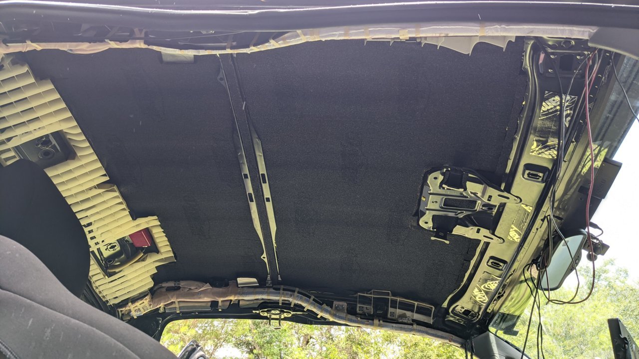

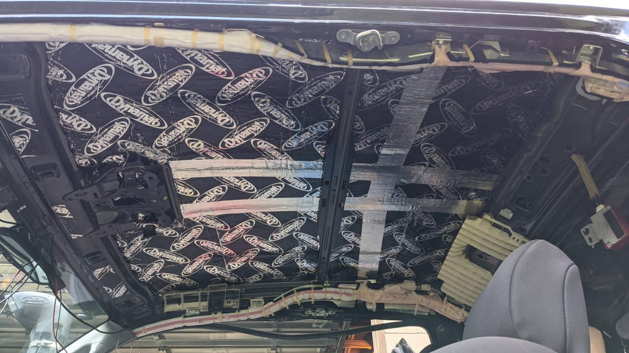

    Key-Rei
    Key-Rei Well-Known Member
    Jun 20, 2017
    #221942
    7,863
    Key
    Florida
    2010 TRD Off-Road 6Spd 4x4 209BSM
    Locker anytime Fog Lights anytime Full LED light conversion TRD cat back Rear cat delete Exaust Y reroute away from actuator Alloy Clutch master 2000 4Runner "Dog Leg" shift leaver Marlin shift seats and bushing Rear seat delete Rear diff breather extension Chrome grille swap Debadge Rear seat delete Honda blower motor beefy plug and wire mod Anytime 12v and USB with volt gauge in bed Blue Sea fuse box Hella AND 70's Caddy horns Low profile recessed hex drain plug swaps Alluminum battery strap 7pin relocated Backup cam on anytime Various other creature comfort and personal taste mods.
    This is from my second gen Access Cab, you should be able to estimate position in reference to the half door latch, but be aware, it is a very thin gauge stamped steel bracket, sharp is all get out, will cut you up, and it's really not structural.
    I don't know what you're planning to do but if you're wanting to drill into it to support something from the outside, I don't think it's going to do it, it'll bend, I could easily pull it away from the roof skin by hand in order to slide the Dynamat in, and if you're planning on hanging something from it from the inside through the headliner, I wouldn't hang more than about 5 lb from it.
    Another way to locate it is pulling the dome light, the dome light is used to support the headliner in the middle by clipping into that crossmember.
    But again there really isn't much at all to it, it's just there to support the headliner, Mount the dome light and that's it. Again this is from my second gen access cab, but the third gen should be the same, and I suspect the double cabs are the similar where the dome light affixes to the middle center of that cross beam.
