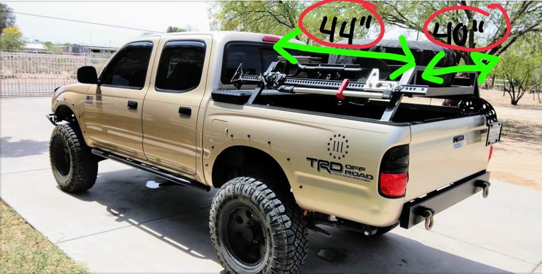

    I've looked online but can't find very many rooftop tent bed racks for 1st Gen Tacomas. Anybody have any suggestions. I'm assuming the second gen and third gen bed racks won't fit in a first gen correct? Below is a picture of my truck and how it currently sits. Really would like to put a roof top tent on it in the near future. Yes there is a bed rack on it right now but I honestly don't think it's the right size for a tent. And yes some of you may know that I built it with my brother but right now building another one to fit a tent is out of the question.

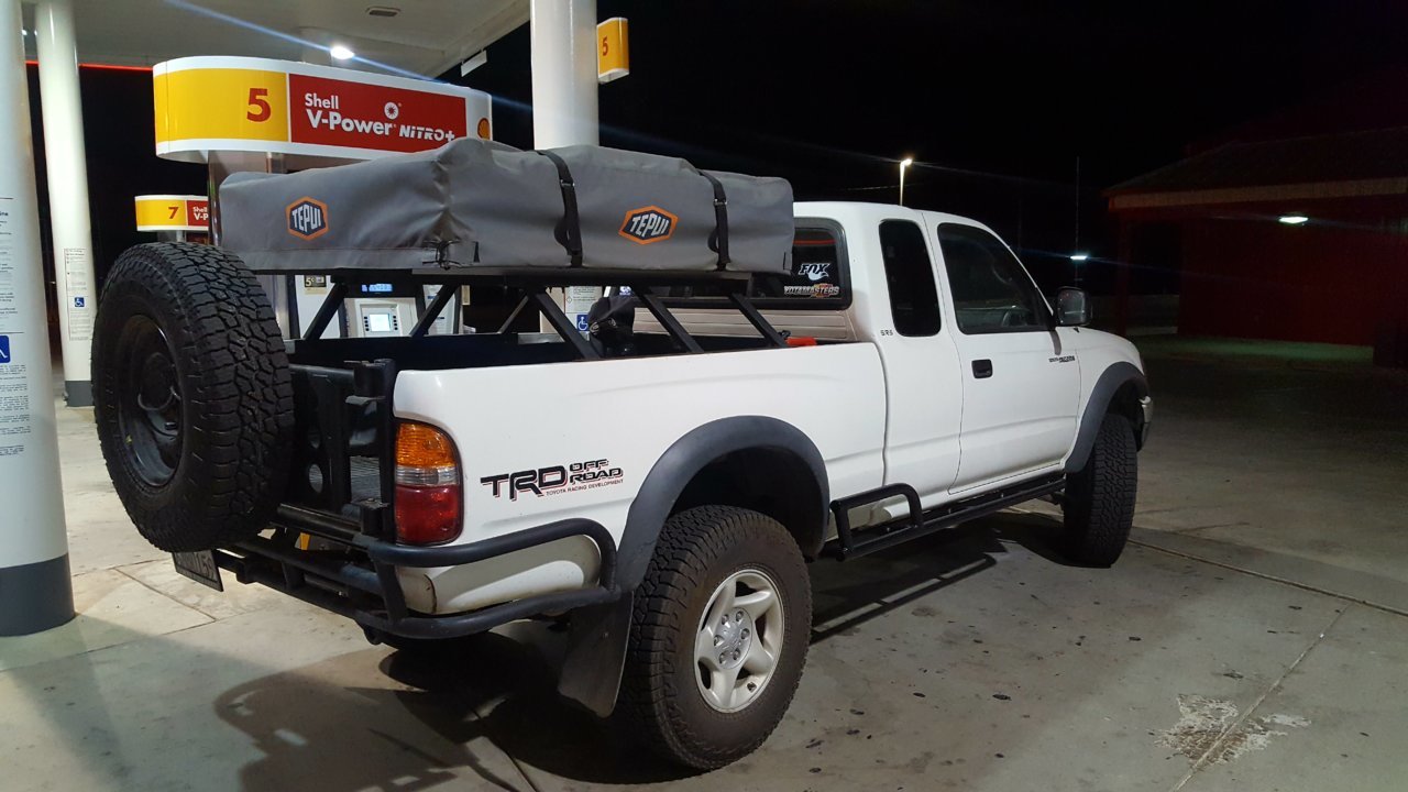

    Think you missed quoting/replying so hope this helps.
    Btw RTTs generally stick out the way you described. A simple google search will show this; here's mine -
    See how far it sticks out in regards to the rack itself? That's normal.

    I totally see where you're coming from. It does hang out past the rack self. By any chance do you have the dimensions of the top of your rack?

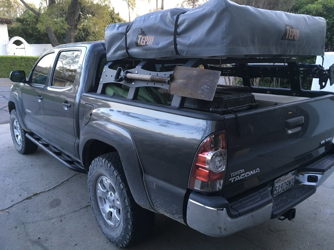

    You’ll be fine with your existing rack.
    The mounting rails on my tepui for instance are 32” apart. My RCI rack as mounted is 47” wide x 45” long.

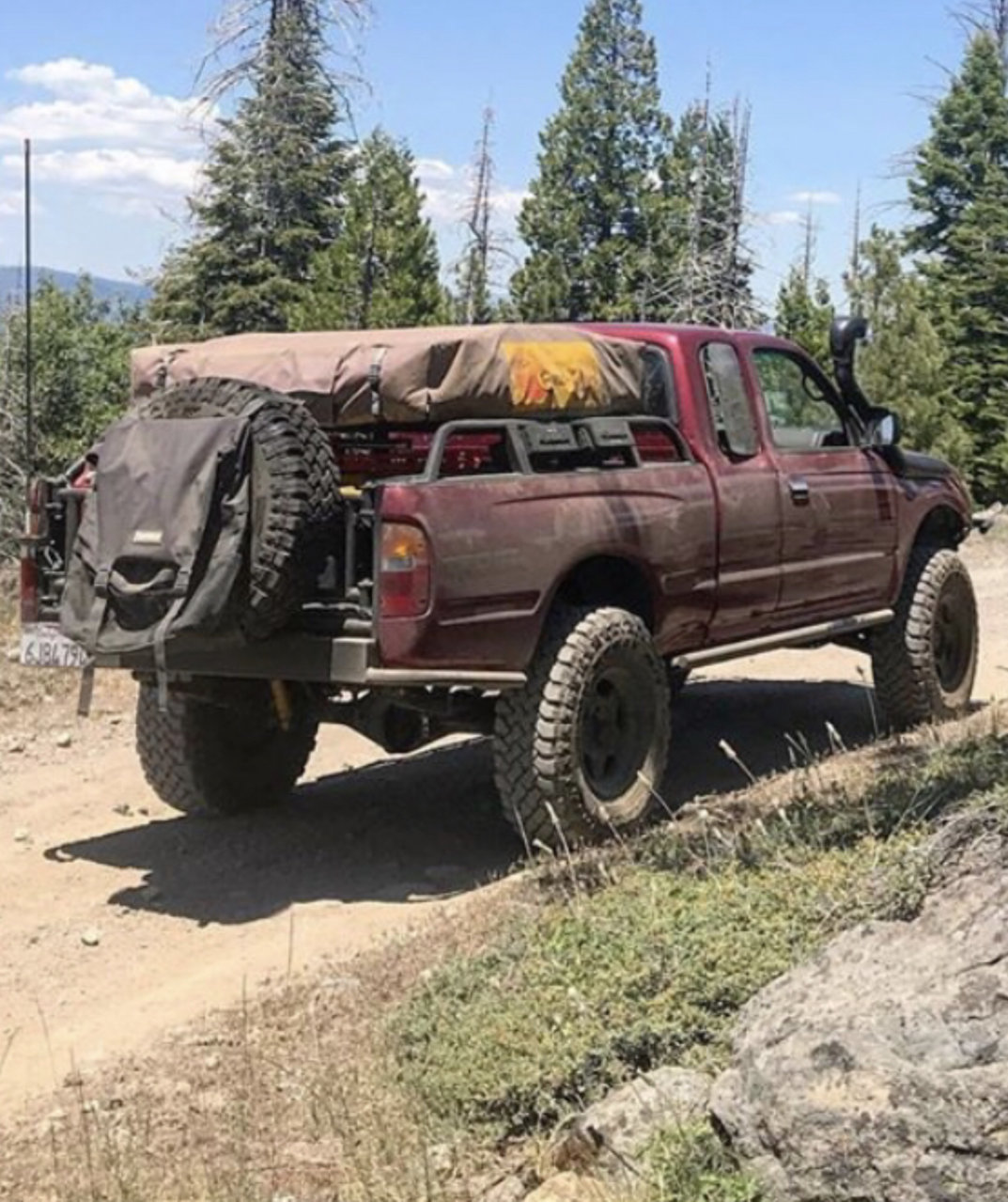

    Just guna post this cuz we’re both running swing out tailgates:thumbsup:D0066E66-2931-4E9A-92BE-FA21EEF303D0.jpg

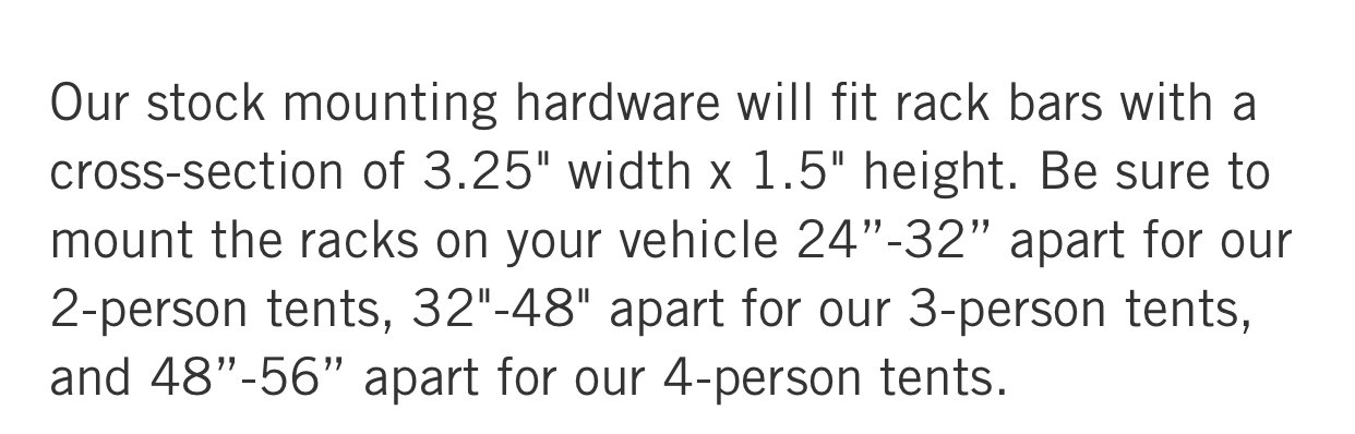

    @Ak4T777 as @omegaman2 said your current rack should be fine as long as the tent you buy has mounting points that fit. Size of the tent does matter as seen below. FC5F6D9E-F06A-4CDA-8551-E94CFD9E1608.jpg

    Totally fine mounting a RTT on those dimensions Our low pro racks are about the same dimensions. They only sit on the two mounting rails that are 27" to 29" apart.
