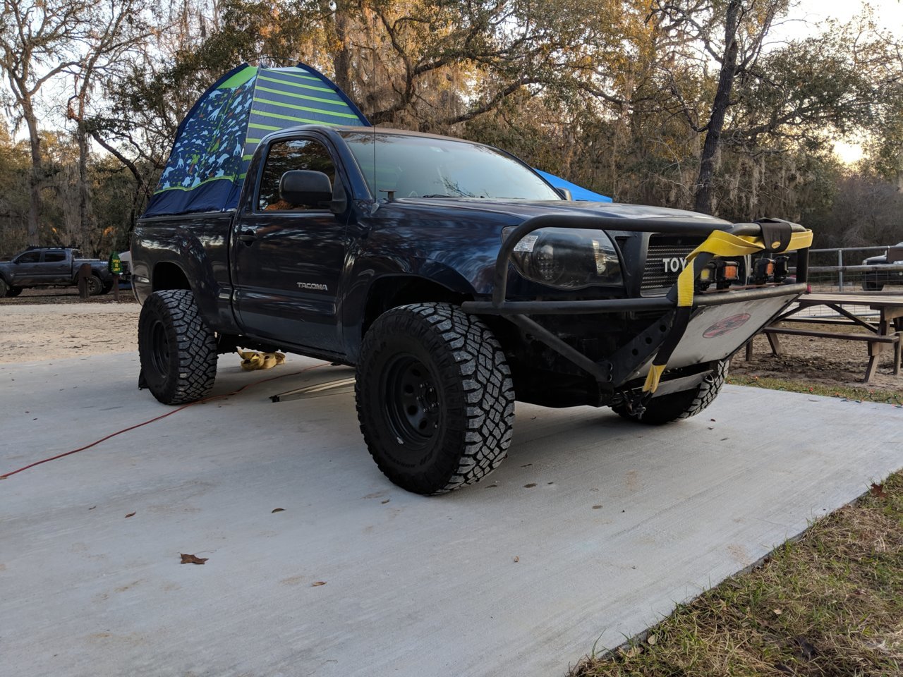

    I modified a tent to fit over my bed. It snaps into my covers snaps. I'm excited to see the end result of your project

    DINO tent FTFW

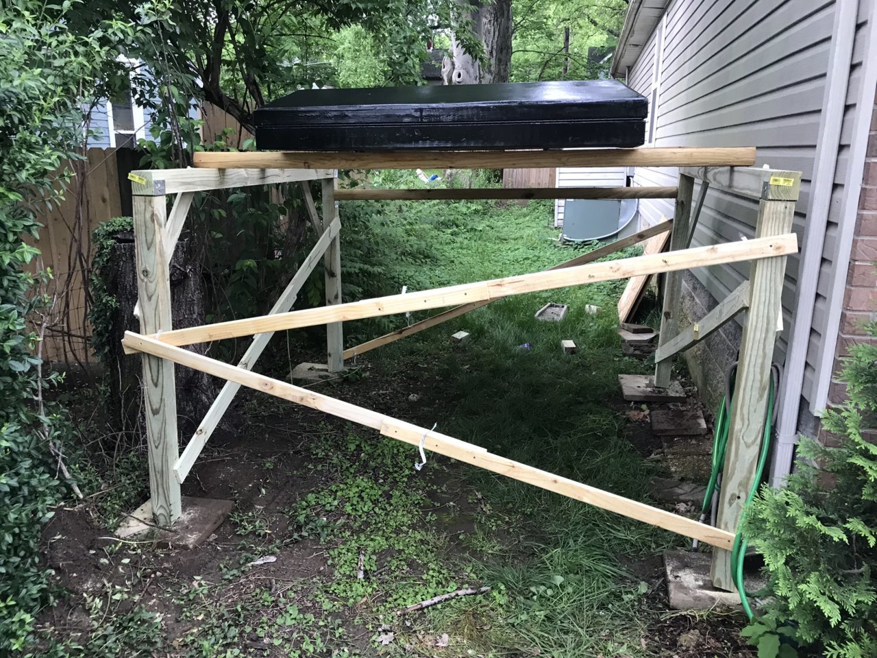

    Update #7 - Storage Frame
    1. I'm not fortunate enough to have a garage to rig a hoist + pulley system, nor is my GF capable of lifting this thing off the truck with me. Saw a couple videos of people building saw-horse frames just above the bed. Similarly, I've got limited space and it's a tight fit. 4x4 frame with some 1x cross bracing, eventually got the wobbles out and it's solid.
