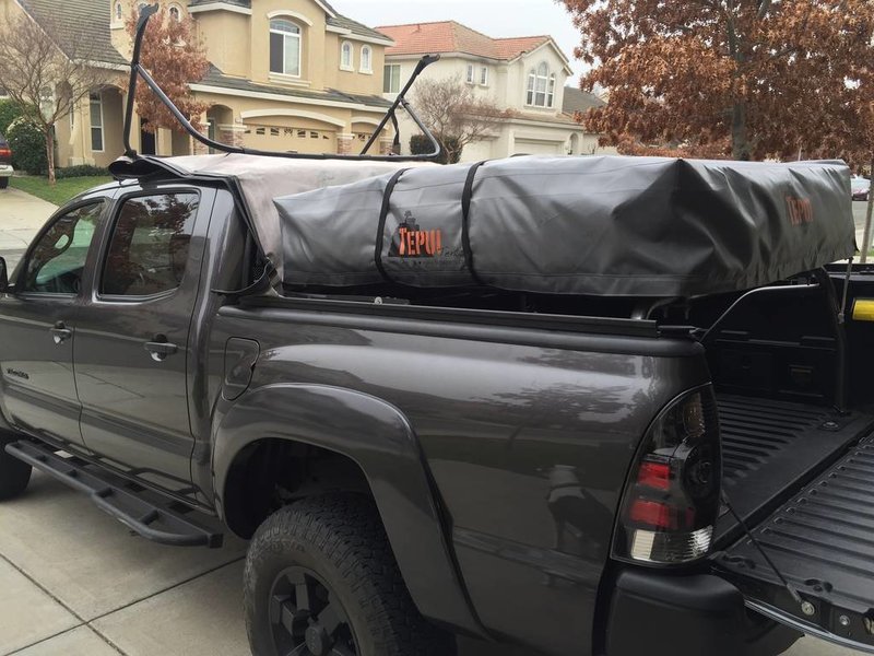

    I don’t own a RTT and no longer own a Softopper, so I cannot backup my opinion with real world data. But conceptually I think those racks could work, particularly in the inverted position. If the racks where left in the position pictured, the Softopper frame may not lay deep enough in the “trough” to give the RTT enough clearance to deploy.
    Look at the first picture in the OP to understand the “trough.” Even with the OP’s design there is still some positive (upward) angle on the Softopper frame when collapsed, but it appears it still provides ample room to deploy the RTT.
    My biggest concern with this rack and running a RTT would be that the entire load seems to be carried by the bed utility tracks. The OP’s design had the load dispersed onto the top of the bed rails, and secured into position via the utility track.

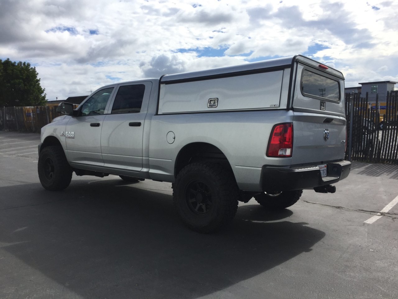

    Was thinking of building a sider for the tent to come out the side of an aluminum A.R.E Shell.... anyone want one built???
    Picture of the shell for reference, would be the best of both hard and soft shellIMG_3329.jpg

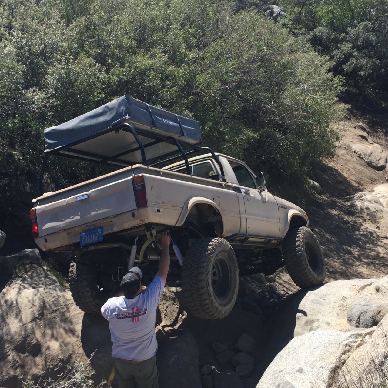

    "This" being the rack and setup for the RTT I built in the OP
    I had it on:
    Tundra, on top of a shell, on an pack rack
    80 Series Land Cruiser on the roof
    82' Pickup on above the cab height pack rack, then lowered pack rack
    97 Tacoma bed bars
    95 Tacoma on Flat bed folding of to the side
    and this (in the OP) setup Inside the soft topper
    It's out of sight, lockable both gear and tent, low profile out of the wind, easy to set up a and take down, not too tall
    I'm a big fan of low center of gravity. Almost rolled the 82' with the tent high on a a pack rack. Immediately cut it and was shocked at the difference, I'll never put a RTT above the cab again.
