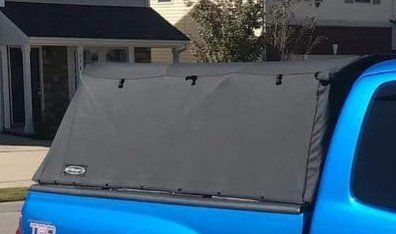

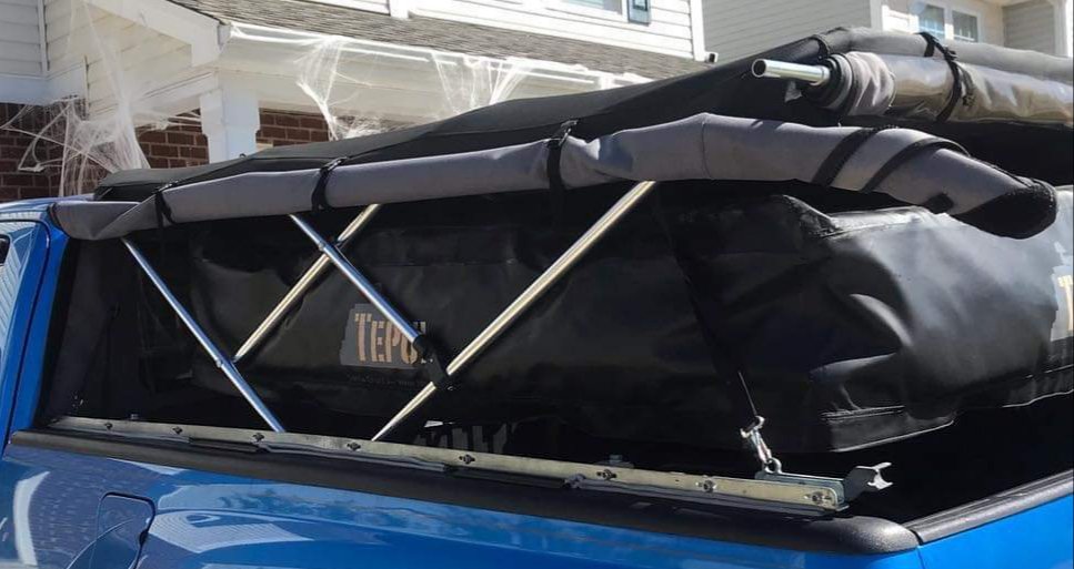

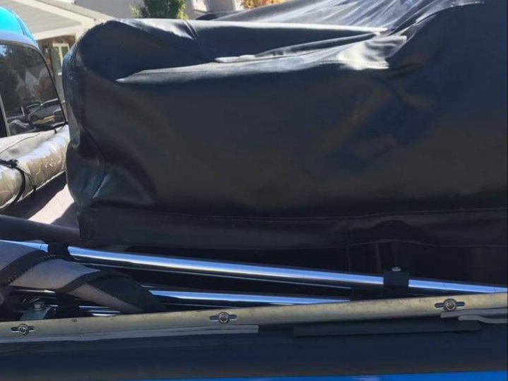

    Those are from Softtopper, I didn't modify or make them,

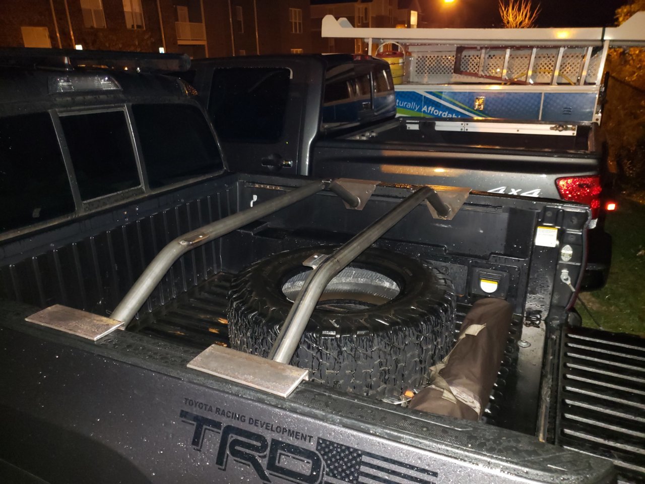

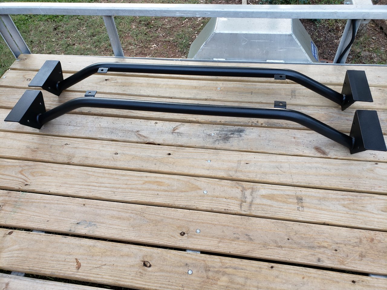

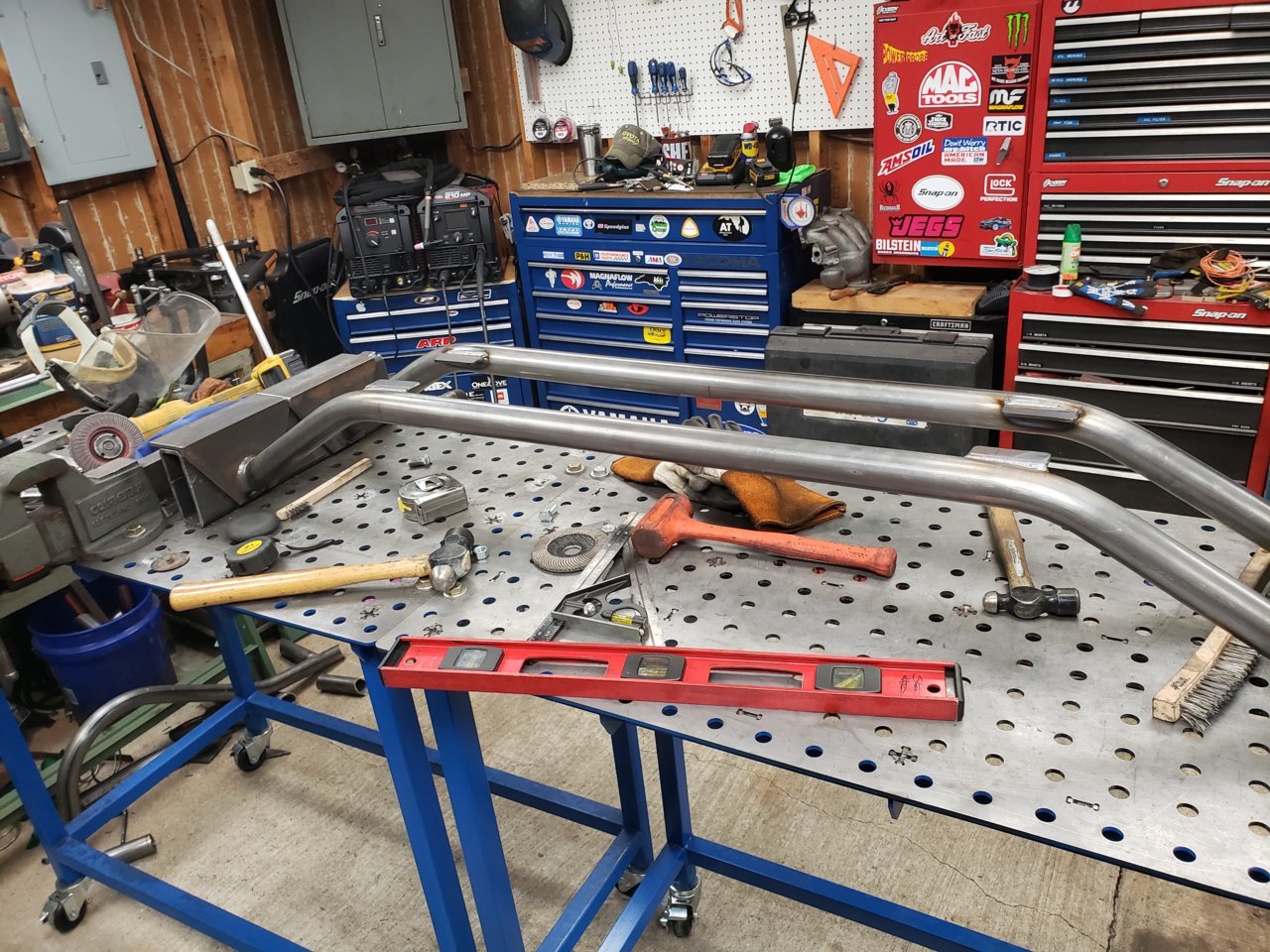

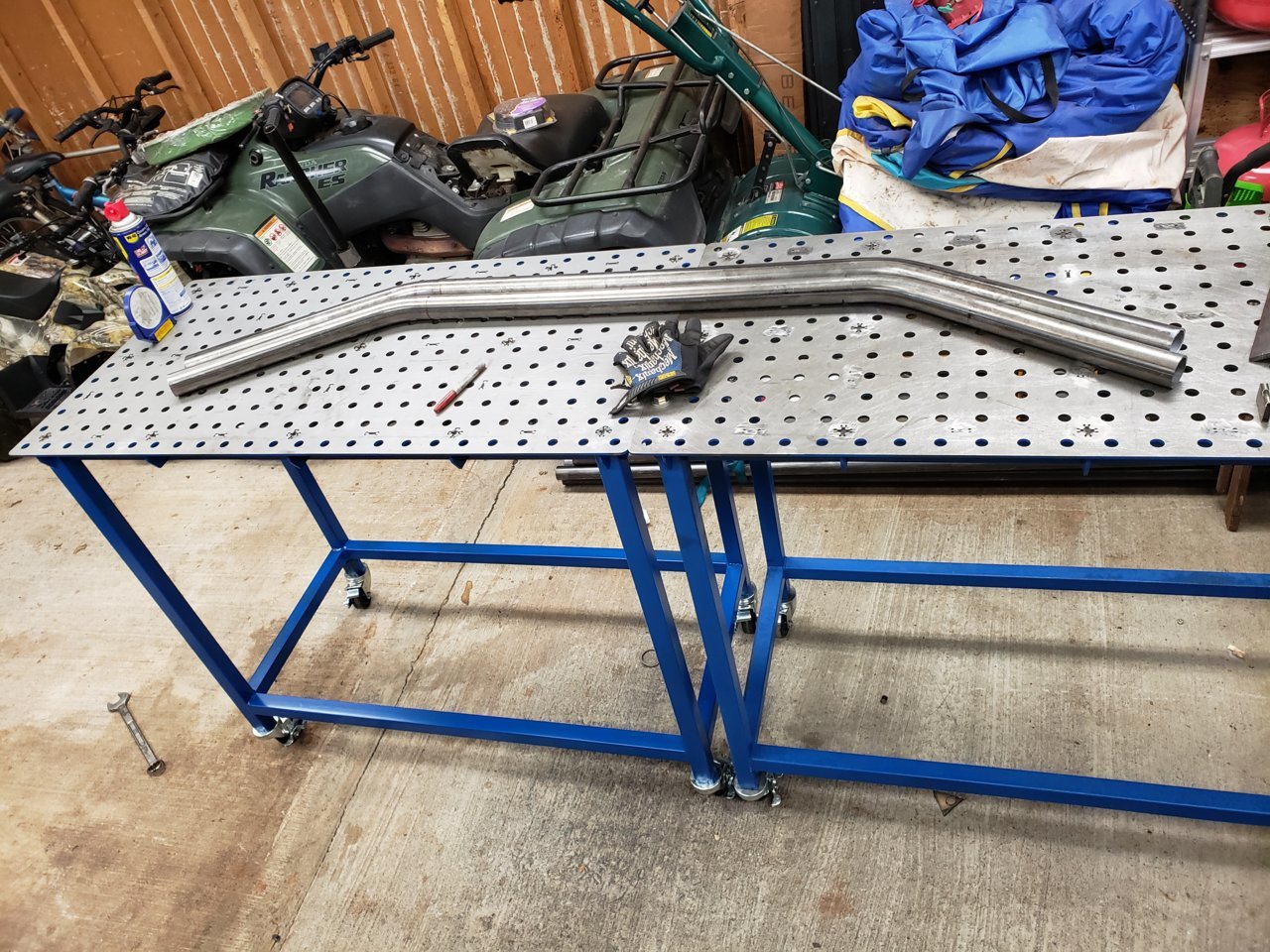

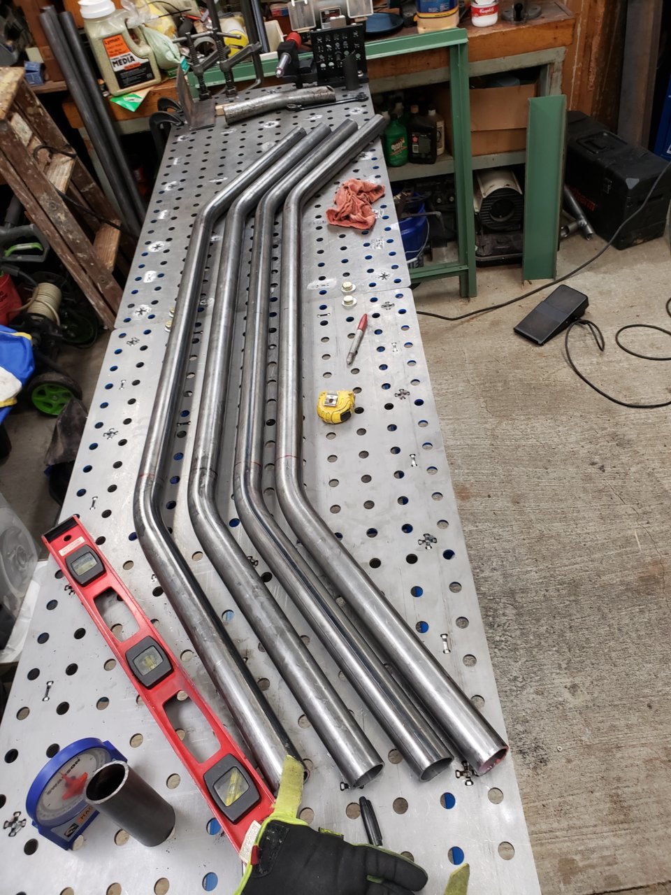

    I posted some pictures of these that I made out of tubing for someone who wanted this setup. I have all the tooling to make them if you would like a set. Drop me a message and I should be able to have them within a few days.$325.00 No shipping

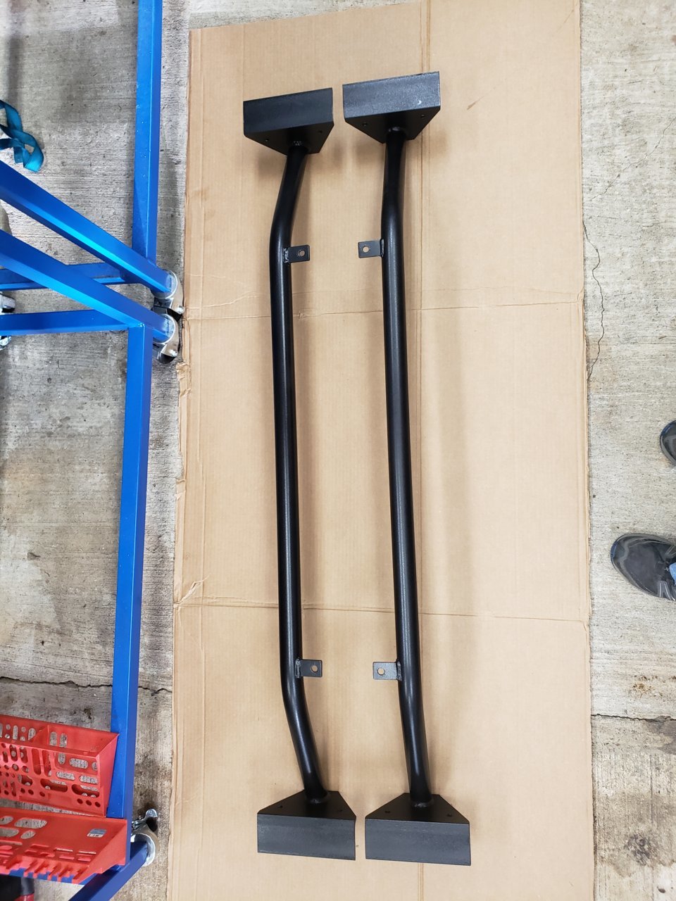

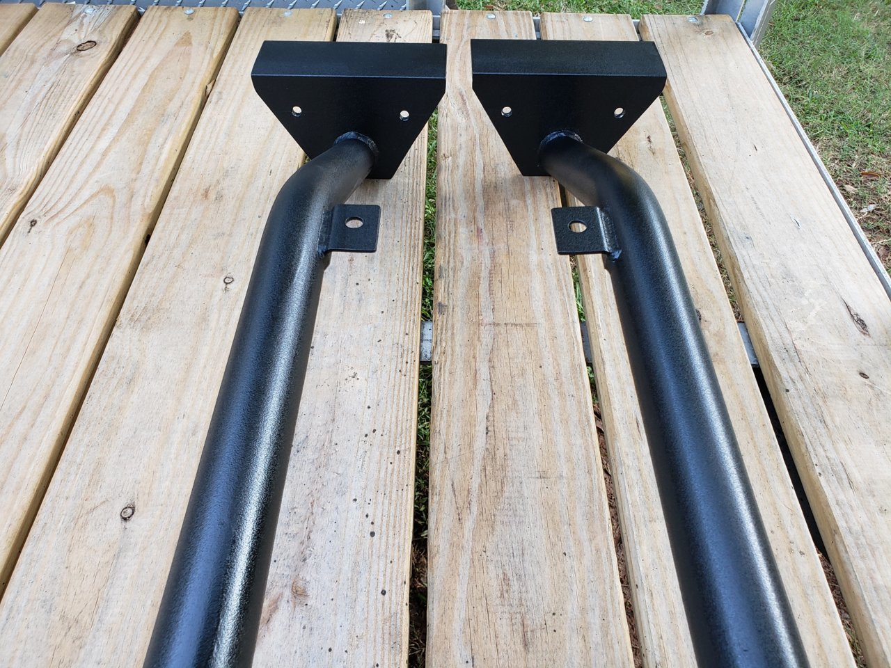

    Ready for shipping! No more shipping.

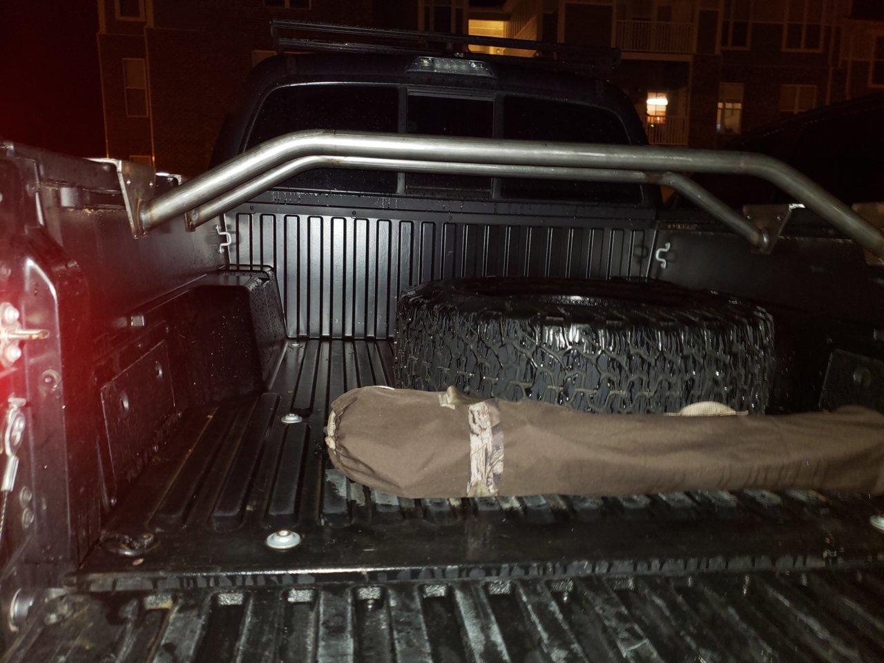

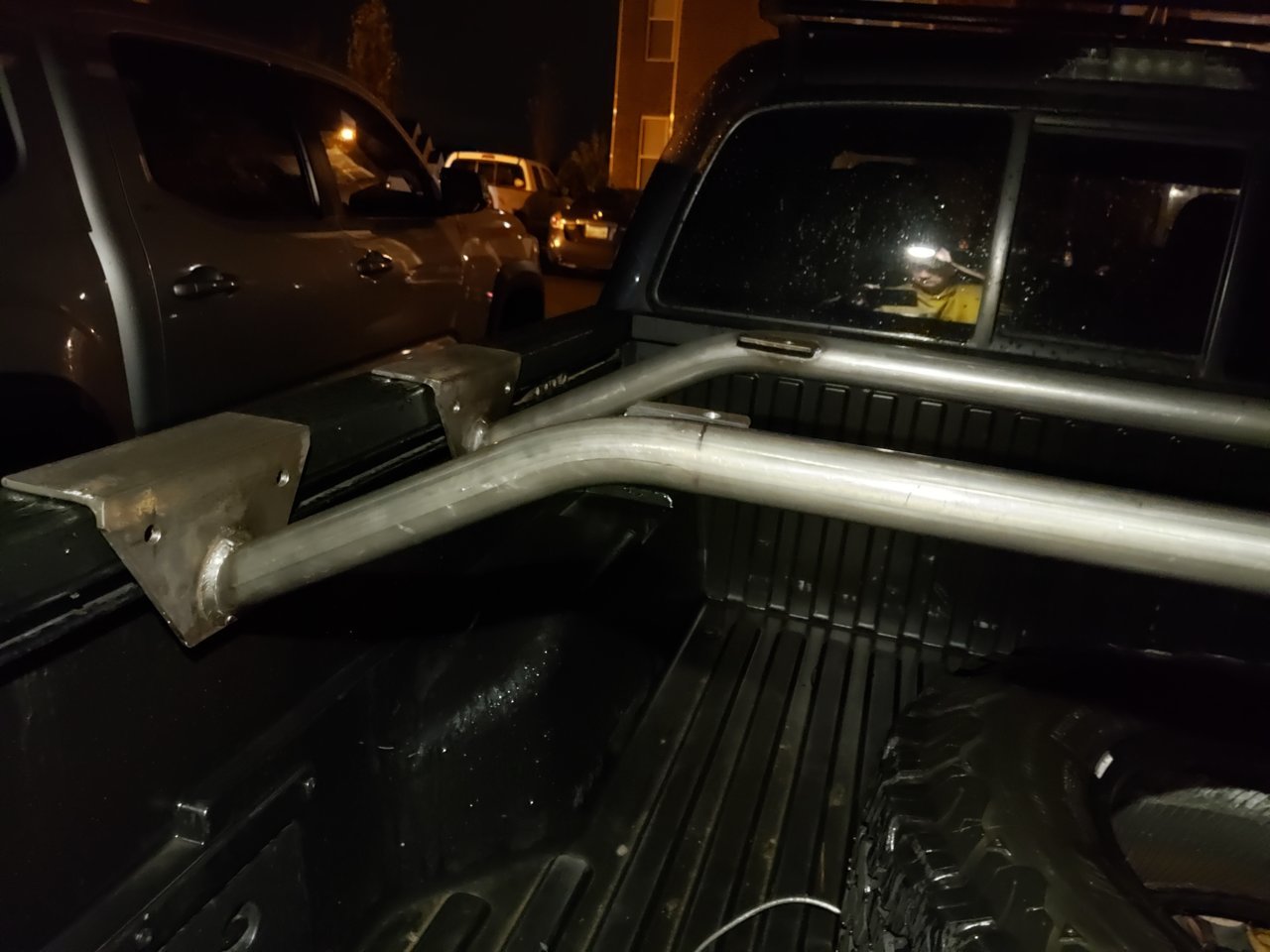

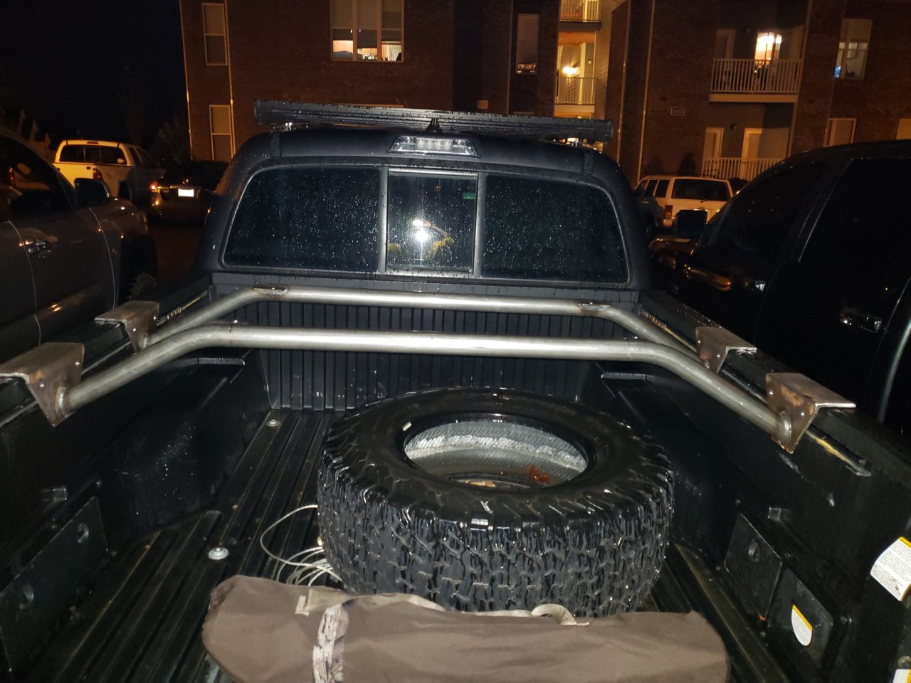

    Finally some pictures of a set on a truck and the fit is perfect they look great without a tent. These are being painted and shipped in the morning. These were made for a 2nd gen that is why the bolt holes aren't in line with the bed track.

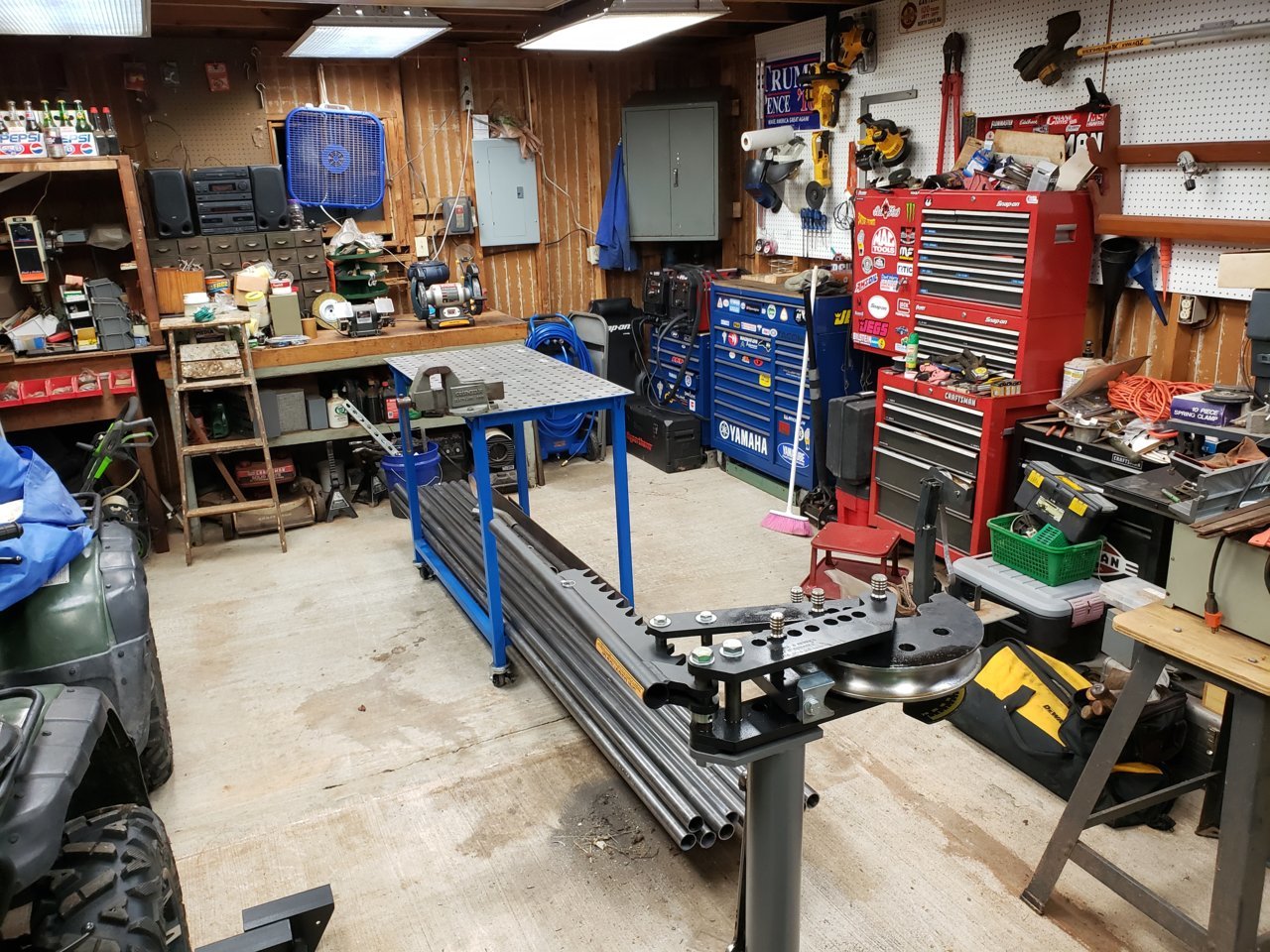

    I've got a fixture made on my certiflat tables. NO SHIPPING

    Shipping weight was 40 lbs and they shop from 28056, usually between $40/$120. They are made from 1.750 diameter tube with a .120 wall thickness, the same material sliders are made from. If you flip your truck you'll need a new tent but you can reuse the bars.
