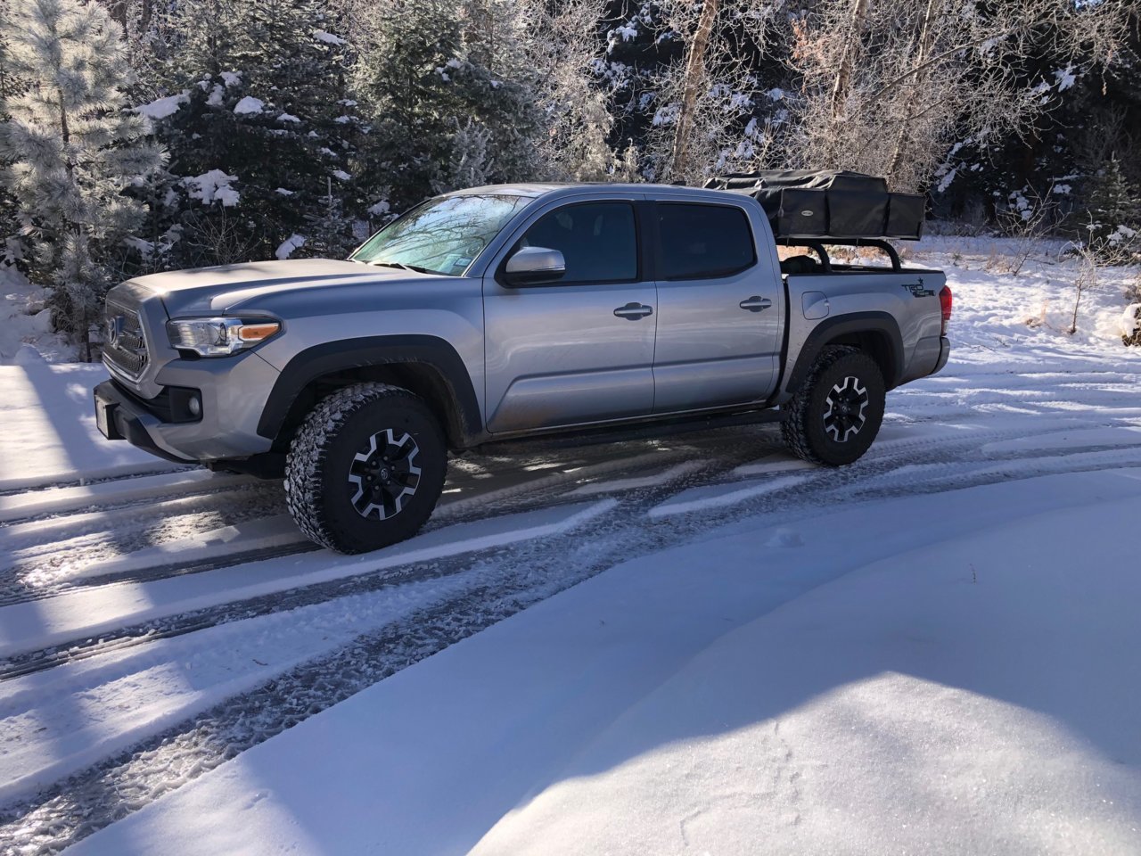

    I've had a 19 DCSB OR since September, I love it. I've actually been really impressed with the mileage I've gotten on this.
    I mounted a RTT a couple weeks ago on a KBB rack. Since then, I've noticed a ~4mpg hit that is worse at highway speeds and ~8mpg hit with any crosswinds or headwinds. I didn't have any hit in the mileage with just the rack. I can hear a decent amount of turbulent air flow with the tent on now, and I notice that when I am just coasting, the truck slows down noticeably faster. I've also noticed that it has trouble holding 6th at ~65 (no issue before) and is now using 5th much of the time.
    So, it seems like all this is because of how high up above the cab the RTT is sitting and acting like an expensive sail. My rack is the KB voodoo rack with the tonneau cover attachment. I don't have a tonneau cover on currently.
    So, let me answer a couple of questions preemptively; I know I shouldn't care about mpg, I know that none of us bought the truck for good mpg, etc, etc, etc. I'm not looking for opinions about mpg. I am concerned about the 4mpg hit adding up to quite a of difference in not only gas cost over the next 200k miles, but also increased wear on the engine having to work harder to maintain a given speed.
    I'm considering getting rid of the tonneau cover adapters and getting the regular adapter for the rack, this will lower it by ~2 inches at a cost of $80. It will still stick up over the cab. I could also get low enough racks that it will be even with the cab, but
    My question is how big of a difference should I expect? If I lower it the 2 inches, how much of my gas mileage do you think that will bring back? Should I skip the lowering ~2 inches step and just get bed bars that will place the tent at cab height? Is the ~4-5 mpg hit just what I should expect for having a ~200 pound tent in the bed permanently? I read others posts that say they didn't really say any noticeable drop with the addition of a tent, but it was immediate and very clear for me.

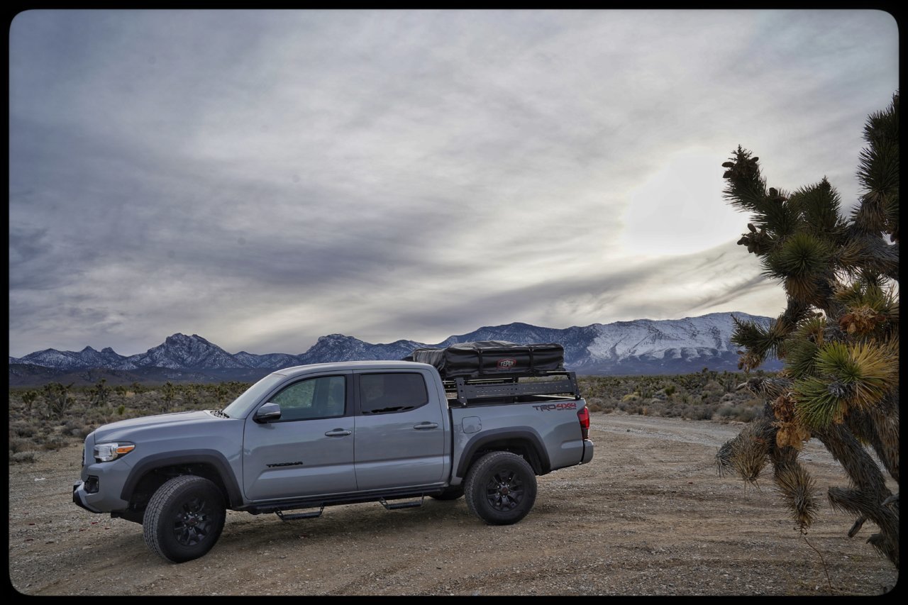

    Thanks for your help, really enjoying learning from this community. I'll include a picture of my truck so you can see the current height of the tent. _A733823-01.jpg
