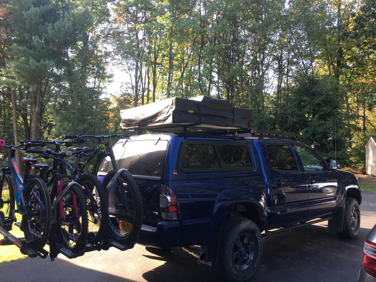

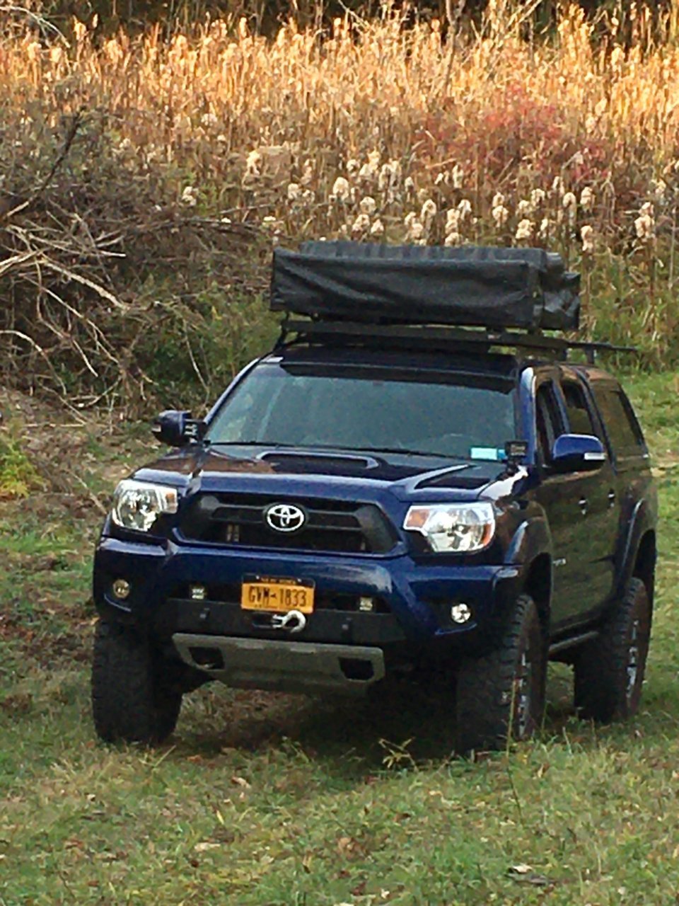

    I’ve tried both, currently running on a Frontrunner rack on the cab. The shell mount made me nervous, always afraid I’d wake up in a fiberglass splinter nest. I was also experiencing sag but have since added airbags and Daystar cradles so probably not so bad now. Mileage is reduced no matter where you put it, maybe a little better farther back?B1158130-BE2C-49D8-BF9A-D5E2BFC2882A.jpg1528788E-3899-43E5-A043-649A352E39B0.jpg 4906ED18-B0CA-46B0-9BC2-60841778C560.jpg

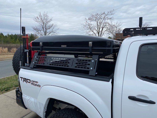

    I prefer over the bed...
    I had a shell with a soft RTT and it was making already terrible gas mileage worser :)

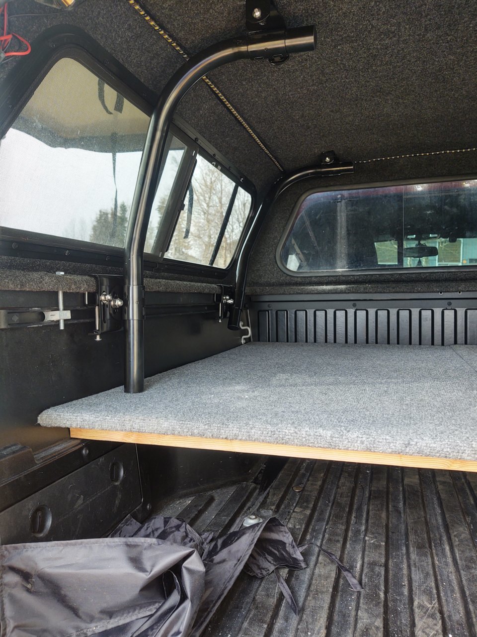

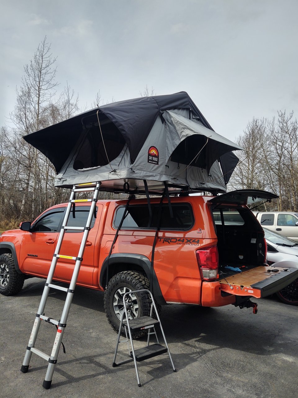

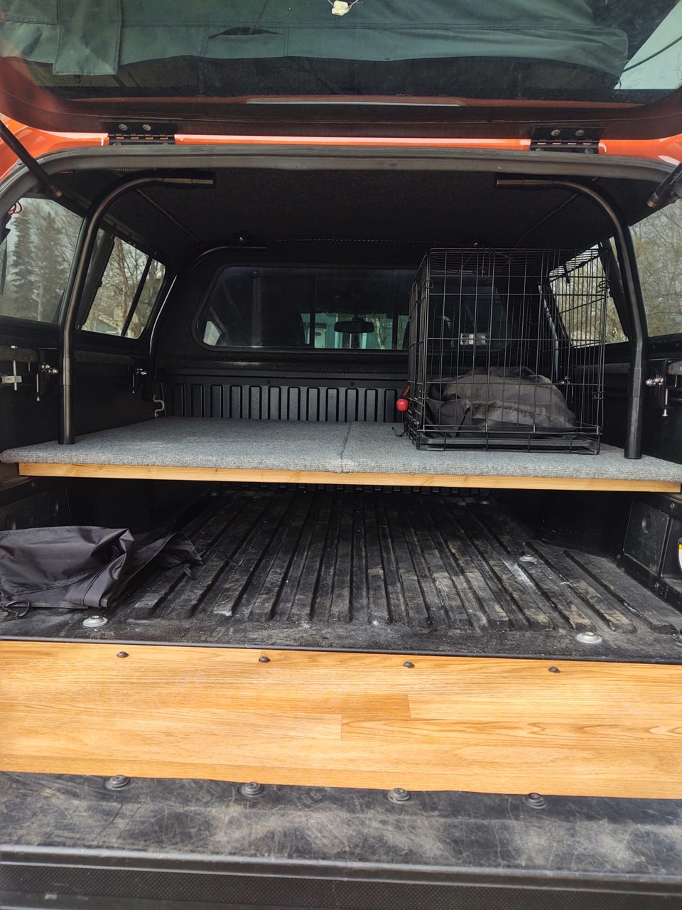

    I'm running mine on my shell but I still had concerns with the weight on the fiberglass so I have a support system inside to help with weight distribution.
  10. May 5, 2021 at 12:32 PM
    #30
    dpf88101
    dpf88101 Well-Known Member
    Sep 21, 2020
    #341518
    359
    Looking to do this same thing - do you have a source for this setup
    Think I found it after a quick search - looks great thanks -
    https://www.milford.one/LoadMax-universal-roof-rack-support-system-505500

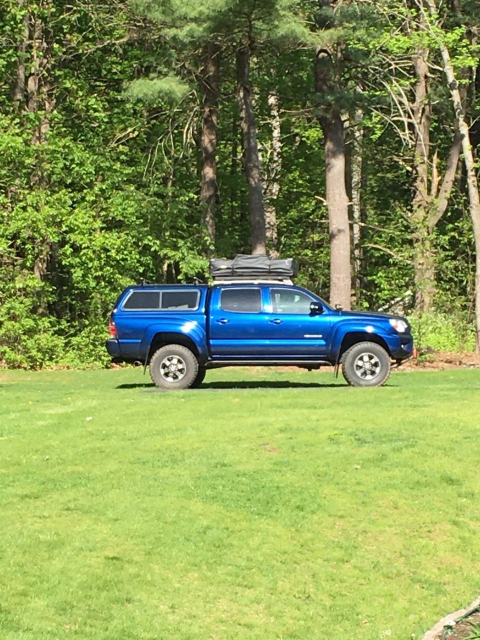

    Love this and this might make me feel more comfortable w adding an RTT to my shell. Any pics from the top side of the shell and any issues with rain? In my head, it seems the shell with the RTT weight can sway side to side more than the bed itself and the brace below would need some wiggle room to compensate for the sway. Any thoughts on that?
  13. May 5, 2021 at 5:35 PM
    #33
    Cool_Calm_B
    Cool_Calm_B Well-Known Member
    Aug 20, 2020
    #338286
    62
    Bryan
    Anchorage Alaska
    2017 Inferno Tacoma TRD OR
    No issues with rain or water. Sealed my fixed points pretty well with silicone and the support system came with foam gaskets to make for a good water tight seal. As far as sway goes, the supports have a small amount of articulation from the celling point that might help with that. Hasn't come across as a worry for me.

    I have the Snugtop Topper with Rack Rails installed from the factory. I then added the UpTop Bravo EX Rack, going to purchase the Milford LoadMax system (and see if they will allow me to purchase two more braces - making total of six (6) ) this will provide me a total of three (3) per side and I will bolt down through the rail system on the shell, then add my Bravo EX rack for the RTT to mount to. This should adequately distribute the weight ( a bit of over kill but better to have and not need than need and not have)
    Also I am planning on affixing Molle panels to the supports inside to mount my rotopax, MaxxTraxx, etc. I already have my shovel, highlift, spare tire etc. mounted inside.
    Cool_Calm_B[QUOTED] likes this.
