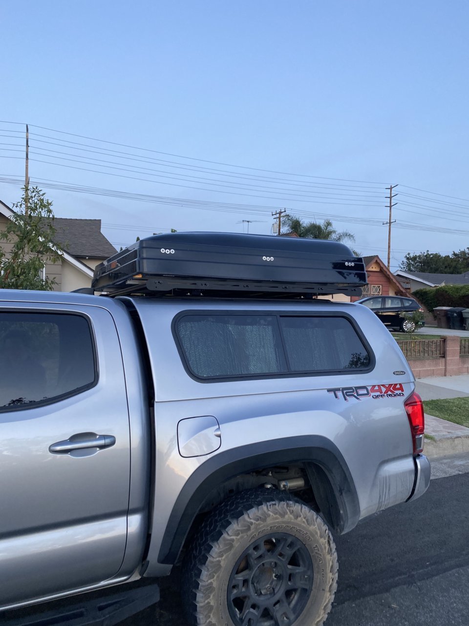

    Have a roofnest condor mounted on top of my snug top shell for over a year. Shell is reinforced I believe they call it the sportsman package. No bed stiffeners because I like to live dangerously.

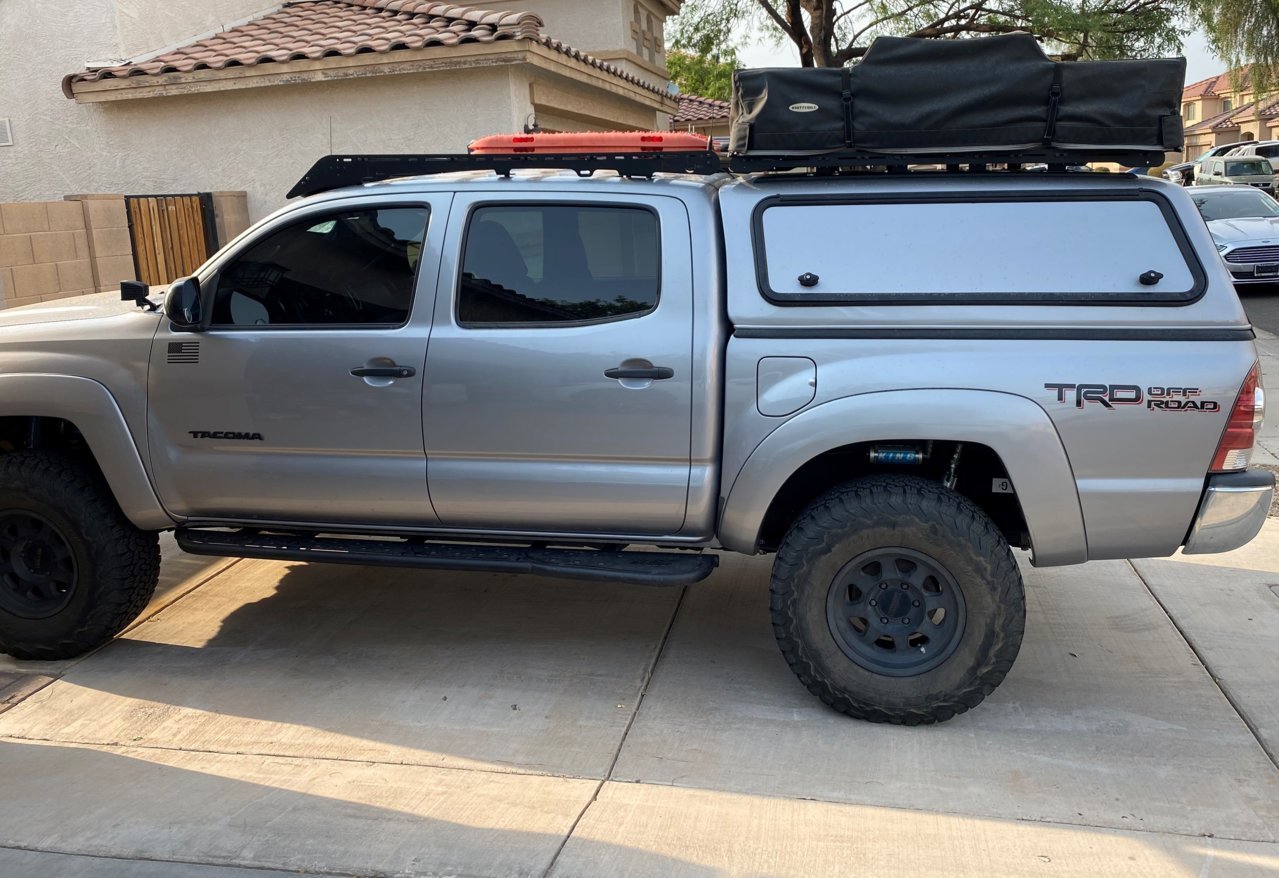

    I have the same set up and I added more feet and more cross bars for better weight dispersion

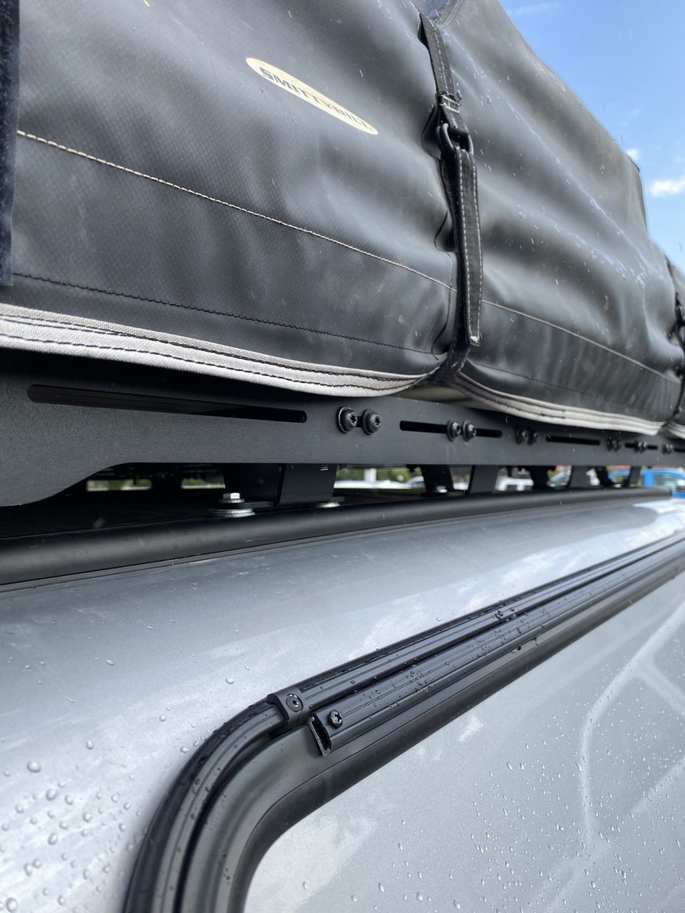

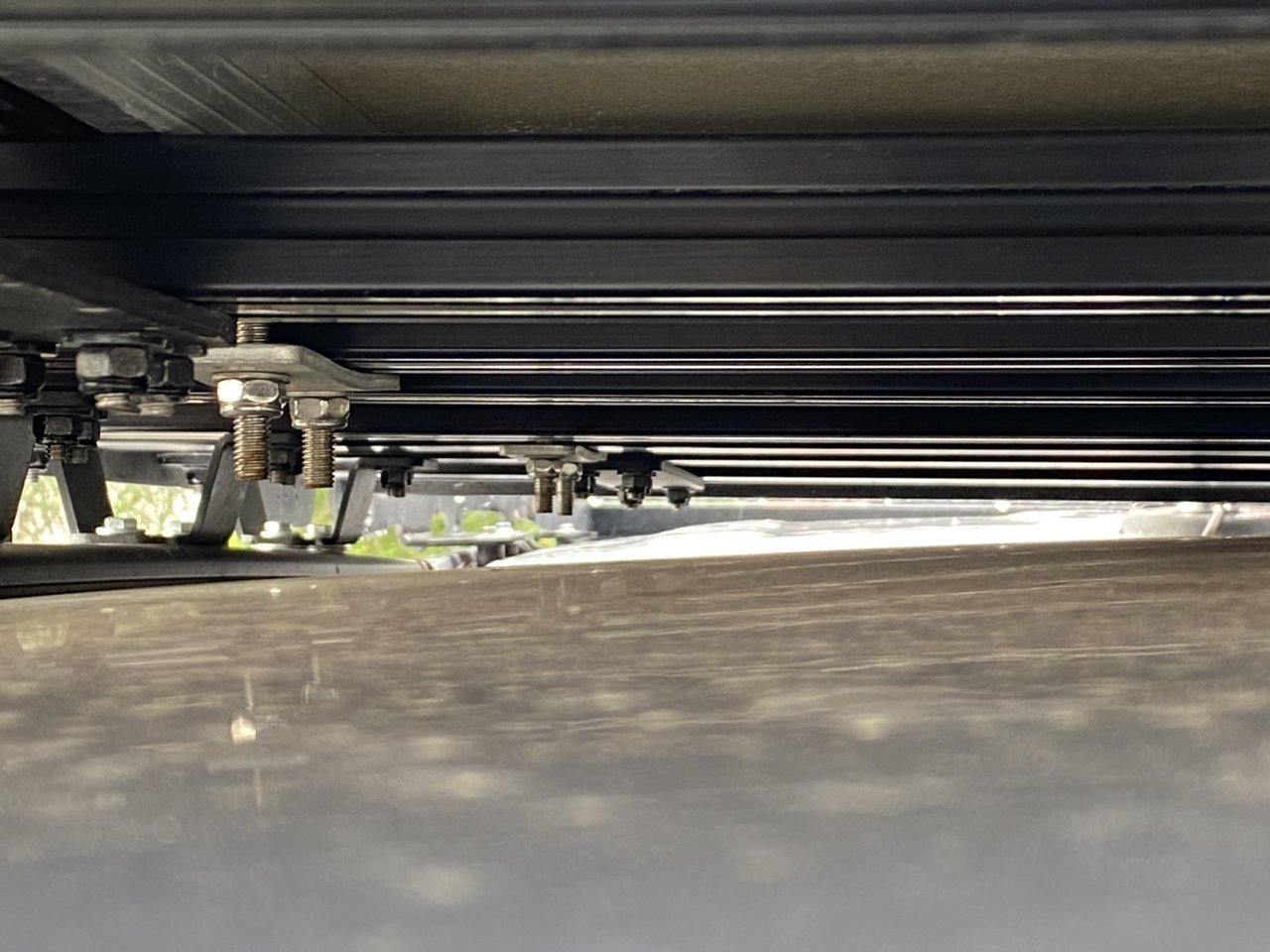

    Hopefully this help give a better idea of how I have it set up. It started to rain so I went back in to work. I ordered four pairs of feet and two extra cross bars for the Prinsu.

    Forgot to mention as well that the washers are to help compensate for the curve of the rails that are on the topper so the topper rails dont have as much stress pulling up through the fiber glass

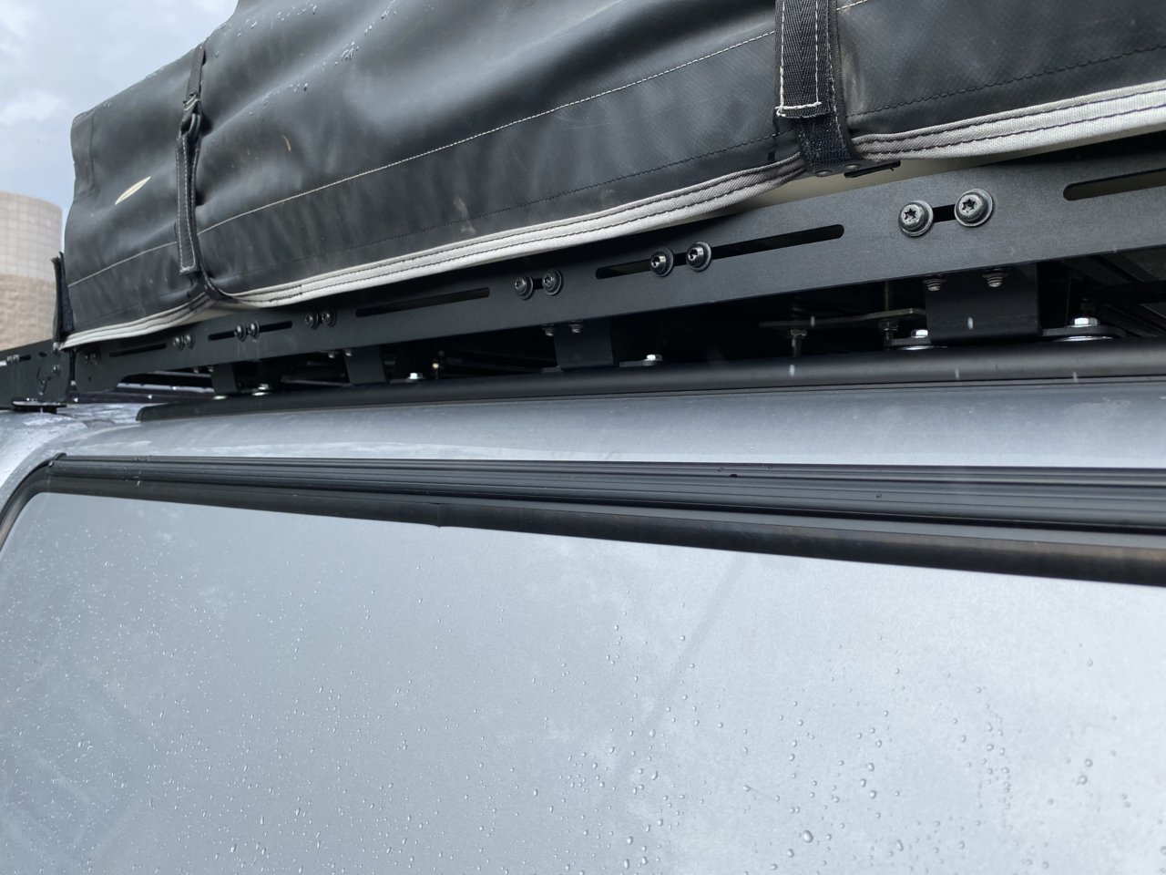

    Thanks man! I ended up relocating the tent rails (had to drill new holes in the tent) to match up with the existing holes on the RLD bed cap. This allowed a direct mount to the camper shell and keeping it as low profile as possible. So far, I haven’t had any issues and I’ve checked the nuts/bolts to make sure the hole isn’t getting any bigger. I did have to trim my roof rack where the tent hovers above it so that it wouldn’t touch when I’m flexing off road.
    I’m running the victory 4x4 access cab rack
