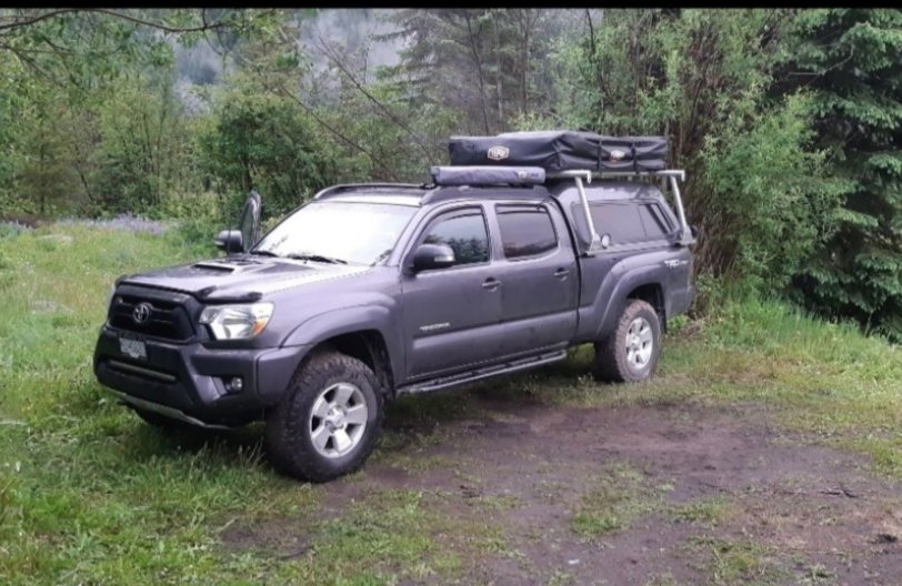

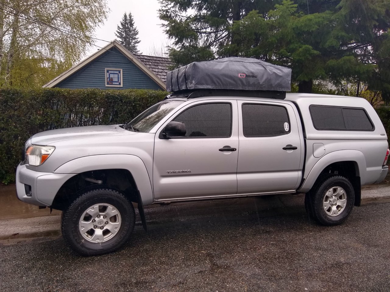

    20220325_212225.jpg I have had my Westcan Over Canopy Adjustable Rack for 4 years. Works great tough as heck. To accommodate the inside attaching of rail bracket you need to notch the lip of the canopy. It can hold 600 lbs dynamic (in motion). I have total choas heavy duty bed stiffners and a ratchet strap inside the bed to keep the bed from spreading apart while wheeling.

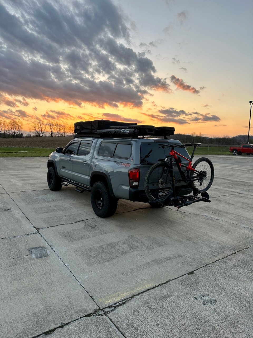

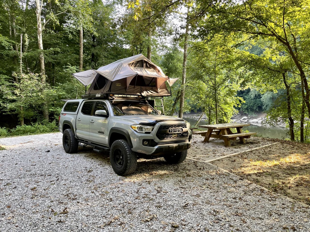

    Anyone running their tent on the cab have any long term issues?
    I just picked up a Leer 100XR for my DCSB and have to make the decision to either order tracks (drill a bunch of holes) and order a Prinsu for the shell, OR just put it on my Prinsu roof rack.
    I had it mounted to CBI Overland bed bars and it was great, but I'm happy to have the topper now.

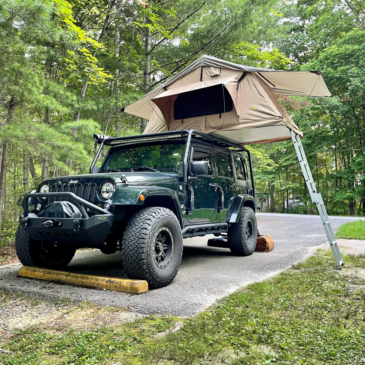

    The height doesn't bother me as I've had a RTT on the top of my last JKU for tens of thousands of miles and that was a brick on 35's with another smaller brick bolted to the top.
    Here are a few pictures of my setup(s) because threads are 10x better with pictures.
    If I put it on the roof, I'll still eventually get a rack of some kind for the shell and move my awning back there to have almost full length coverage once the tent and awning are both open.

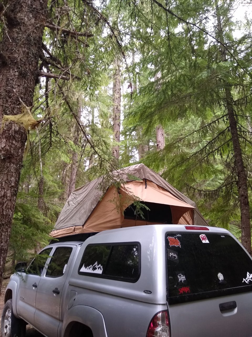

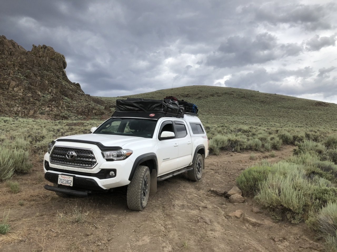

    My rooftop tent on the cab has been amazing- I recommend it for those of you who have a camper shell or something that you don't want to drillinto. I just use the factory rack holes to put on the offroad rack (ARB) and then I popped an ARB tent up there. I love it. Going strong for months!!

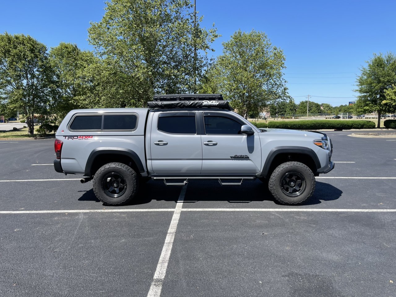

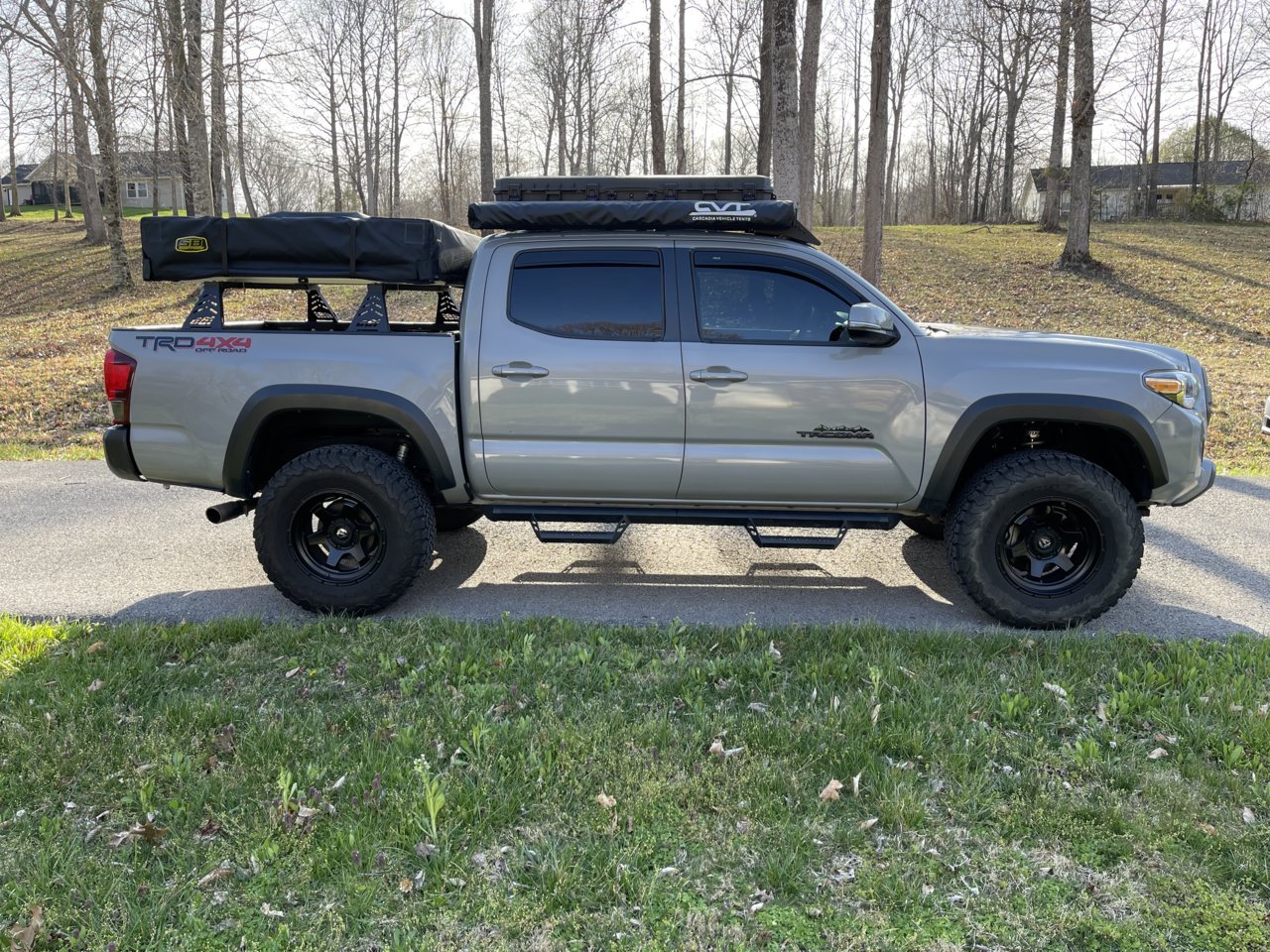

    No worries man! I always try to check my old posts. Other than looking a little goofy at certain angles, I'm happy with having it on the roof.
    It's been up there since ~ August of last year and still going strong. I've since added Front Runner rails, Sherpa Equipment mounting feet, and Prinsu LoadBars to my camper shell so I could mount my Plano cases and my awning at the back.
    With the tent and the awning deployed to the same side, I have almost the full length of the truck for shade/coverage.
