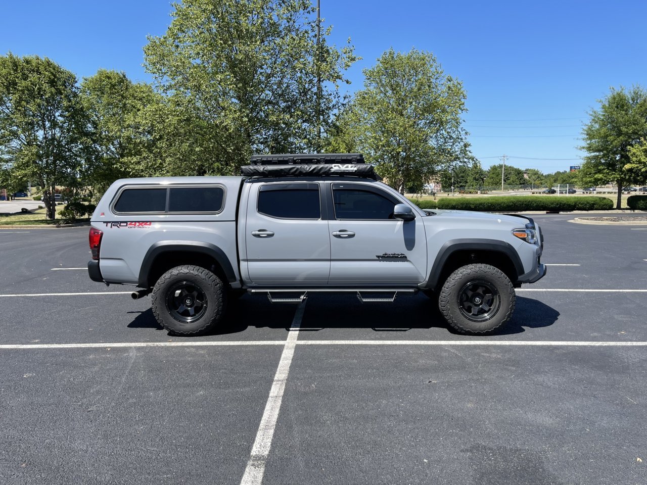

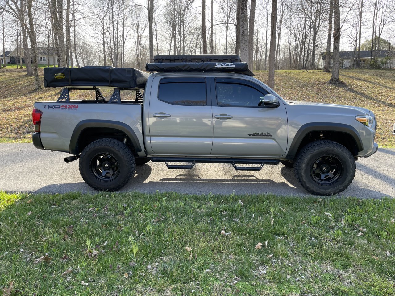

    I just picked up a Leer 100XR for my DCSB and have to make the decision to either order tracks (drill a bunch of holes) and order a Prinsu for the shell, OR just put it on my Prinsu roof rack.
    I had my RTT mounted to CBI Overland bed bars and it was great, but I finally managed to find a used camper shell in Cement semi-locally.
    I have Total Chaos bed stiffeners already, but I'm iffy on putting it on the shell without the Milford LoadMax support system which is another added cost.
    https://www.milford.one/LoadMax-universal-roof-rack-support-system-505500
    If I put it on the roof, I'll still eventually get a rack of some kind for the shell and move my awning and Plano cases back there to have almost full length coverage once the tent and awning are both open.
    Obviously MPG will suffer moving it above the roof line, but I had a RTT mounted to my JKU's roof for tens of thousands of miles. That was a brick on 35's with a smaller brick bolted to the top, so I'm used to the MPG hit.
    Here are a few pictures of my setup(s) because threads are 10x better with pictures.
