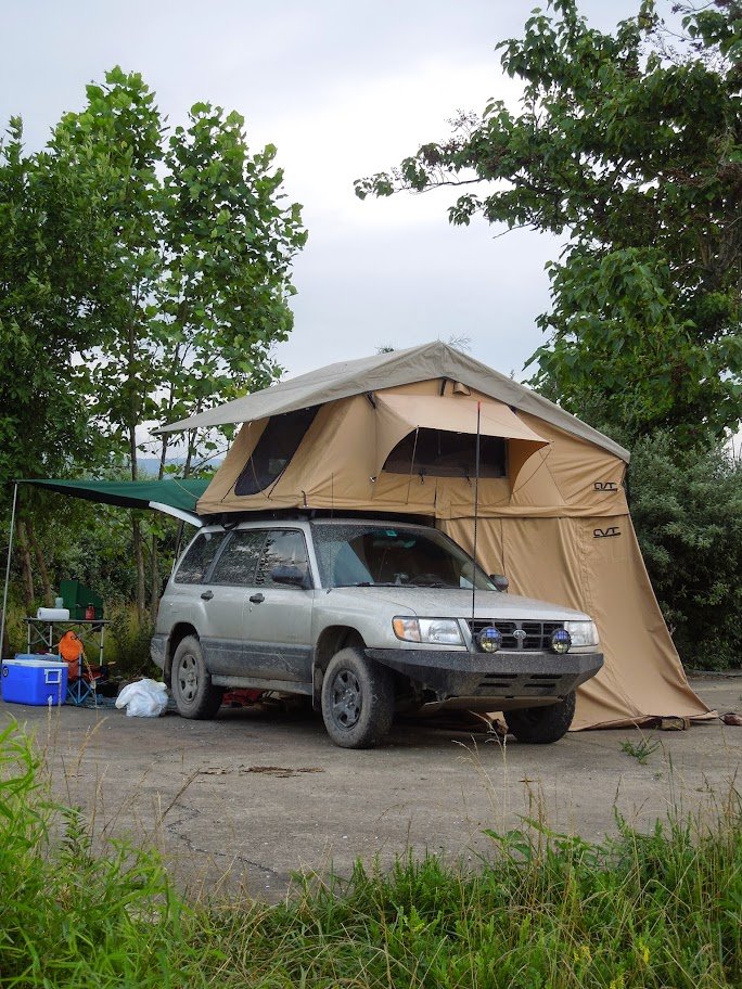

    AM-JKLXz5B1ctKQch6YOeffH3E7W9V27ZZzqIBUH_9c006a06bc3388e76ead6dcb8284000bab96067d.jpg
    My rig 10 years ago, tent on stock Subaru crossbars rated at 125# dynamic weight (i.e. driving down the road) No issues, I'd gamble that a 3rd gen Tacoma cab is at least as strong as what Subaru was making in 1999.

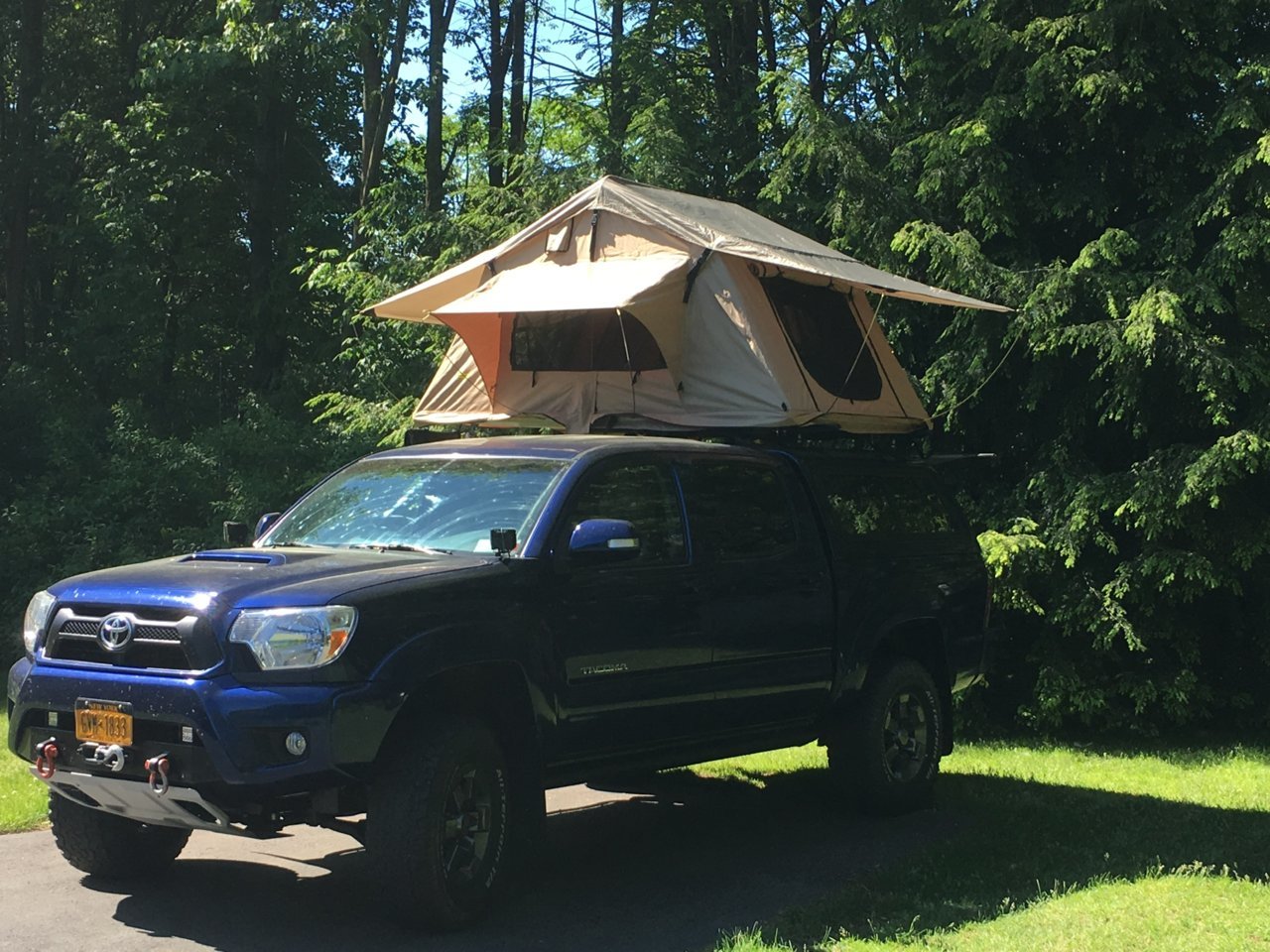

    on the topper…
    or on the truck cab, no issues either way.
    I will say the FrontRunner rack on the truck cab feels significantly more sturdy.
    Just Thule bars mounted to the tracks on my Leer topper.

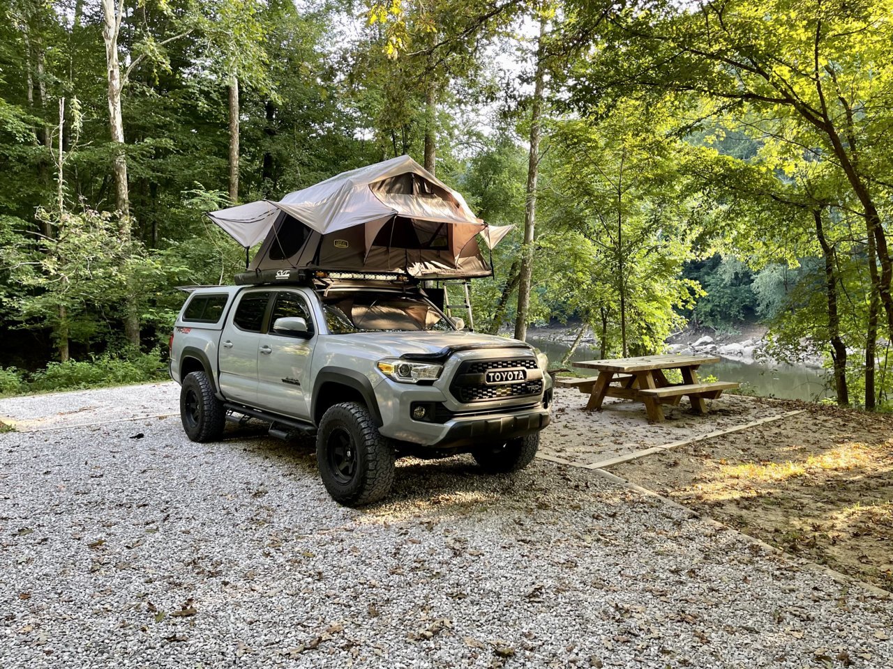

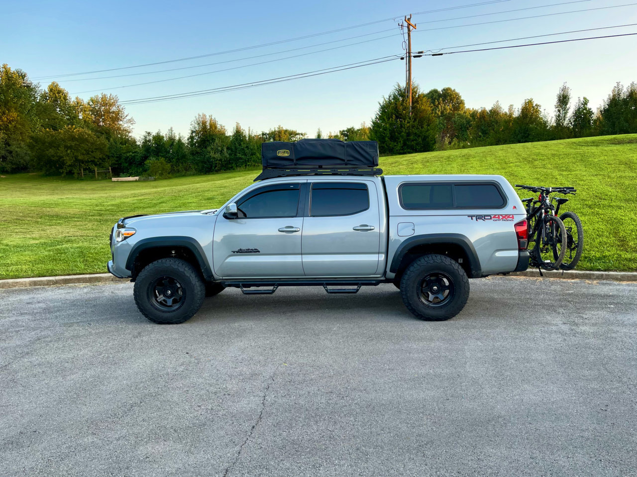

    For anyone wondering, I ended up putting the tent on the roof and it's great. We used it over the weekend and had a blast.
    It was me, my wife, and our two small kids in the tents and contrary to popular belief the truck's roof didn't collapse, nothing caught on fire, and no cracks opened up in the ground.
    In all seriousness it was totally fine.
    Surprisingly I got zero added wind noise than what I already had with my rifle cases, awning, and lightbar. It took 6ish weeks to get the 1" tent mounting feet I ordered from Prinsu, and when they finally came in it took me probably 2+ hours to get it all bolted down and working together.
    It BARELY clears my light bar, but it clears. I have a shark-fin antenna, so my last load bar is vertical rather than horizontal, so I can't use it for mounting. This means the tent sits a little father forward to keep the mounts evenly disbursing weight, and this wouldn't have worked without the 1" higher feet to clear my lightbar.
    Between tightening all 24 RTT mounting bolts and getting my awning back on I have no skin left on my knuckles or forearms.
    My current plans are adding rails to my camper shell and getting a Prinsu Top Rack for it. Then I'll put my rifle cases back there because I already miss the extra storage. I'll also move my awning to the same side my tent opens so I'll have almost the entire truck length for shade and cover. As an added benefit I can stand up straight under the tent now at 6'4. I may end up with the Prinsu awning brackets to raise it higher as well.

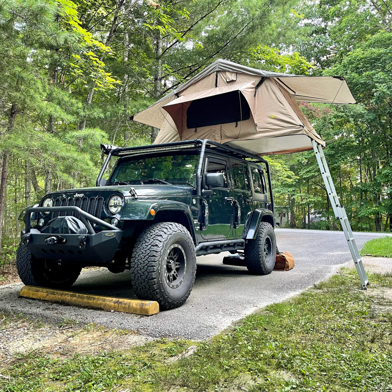

    People seem to run them all kinds of tents on their shell with zero issues, but something about the weight of the tent, the rack, plus my family just seems like a lot for straight fiberglass.
    Although, people run them directly on their Jeep Wrangler hardtops more than I see them on camper shells, but those are just fiberglass as well and maybe even thinner than the 100XR. I bought an external frame mounted roof rack when I had my RTT on my Wrangler for the same concern about fiberglass and that much weight.
    Overall I am happy with how it turned out on my Tacoma's roof though!
    Here is a picture of my first RTT on my Wrangler with an externally roof-rack that I mentioned above.
