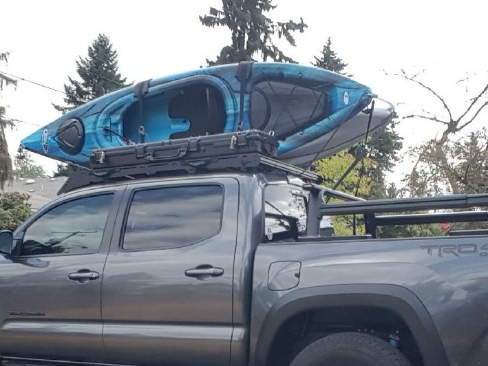

    Depends on what you're outdoor fun consists of, and how much external storage you need. I use mine for my kayaks and have a couple cheaper cases on my rack (one comes off to accommodate the kayaks) that hold some outdoor gear, cheap tools and roadside equipment, and when my kayaks are up there I put life vests and oars and whatnot in the case.

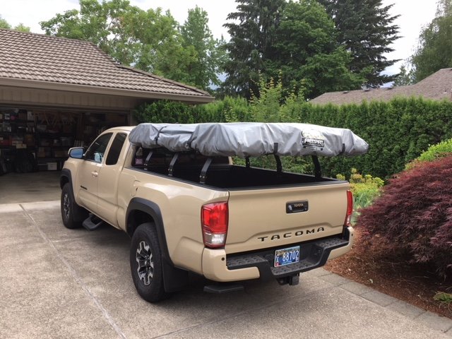

    2017 Tacoma 4x4 TRD AC Off Road
    I vote bed rack, RTT sits just about cab height and I fill the bed of the truck with all the camping gear.

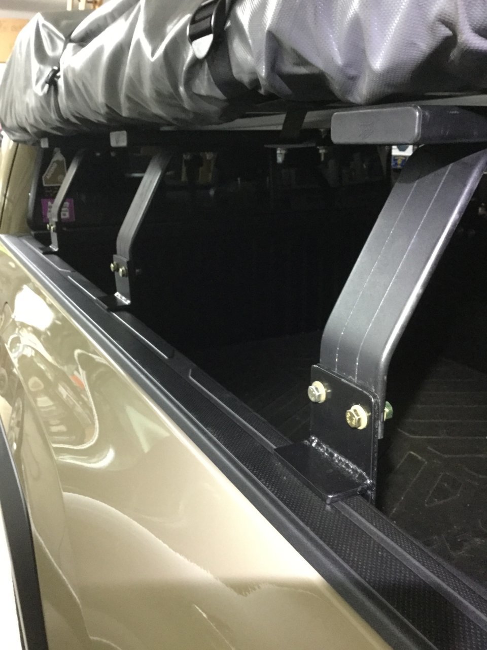

    They are Front Runner bars on custom made extensions.

    Before you install weight over the bed, be sure to install bed stiffeners. These beds are composite and are very strong but not laterally when you put weight on the bed rails. Bed stiffeners will solve this problem.

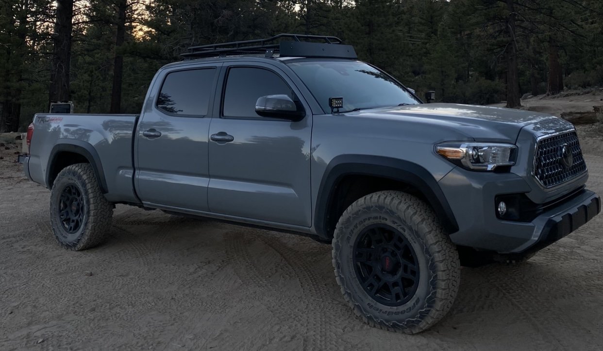

    The Tacoma Gobi roof rack is a waste. It doesn't cover the entire cab.

    I ended up with a Gobi caused I found one for 600 bucks on offer up, so my opinion is slightly biased. You won’t break a gobi, bend a gobi, absolutely nothing, even with gross negligence. I’ll say that the gobi for the Tacoma is NOT worth it at roughly 1500 bucks. As @kpinthebay pointed out, the rack stops right where the antenna starts. I did reach out to Gobi prior to buying one, and they were open to extending the rack on a case by case basis.

    May be a dumb question but.... how did you mount those kayaks up there? Did you use a j rack of some sort or supports? I literally just installed my Prinsu rack yesterday but one of my future projects was to see how I could transport my 2 twelve foot kayaks for my girl and I to the springs/beach. I was originally thinking I'd get a bed extender due to the size and width BUT, maybe the prinsu can help me out in the meantime or if I'm in a pinch (longer trips where two vehicles would be best to have a drop off and load vehicle if going up-river).
