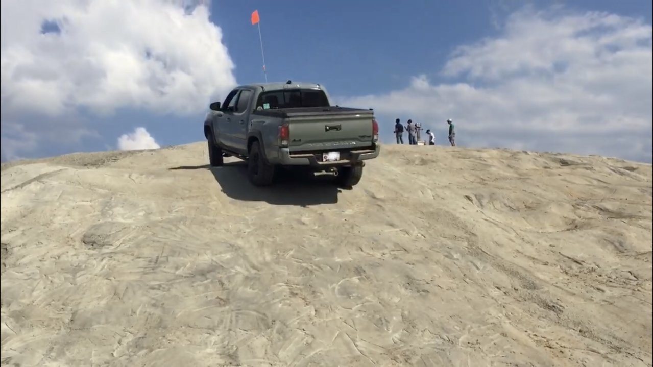

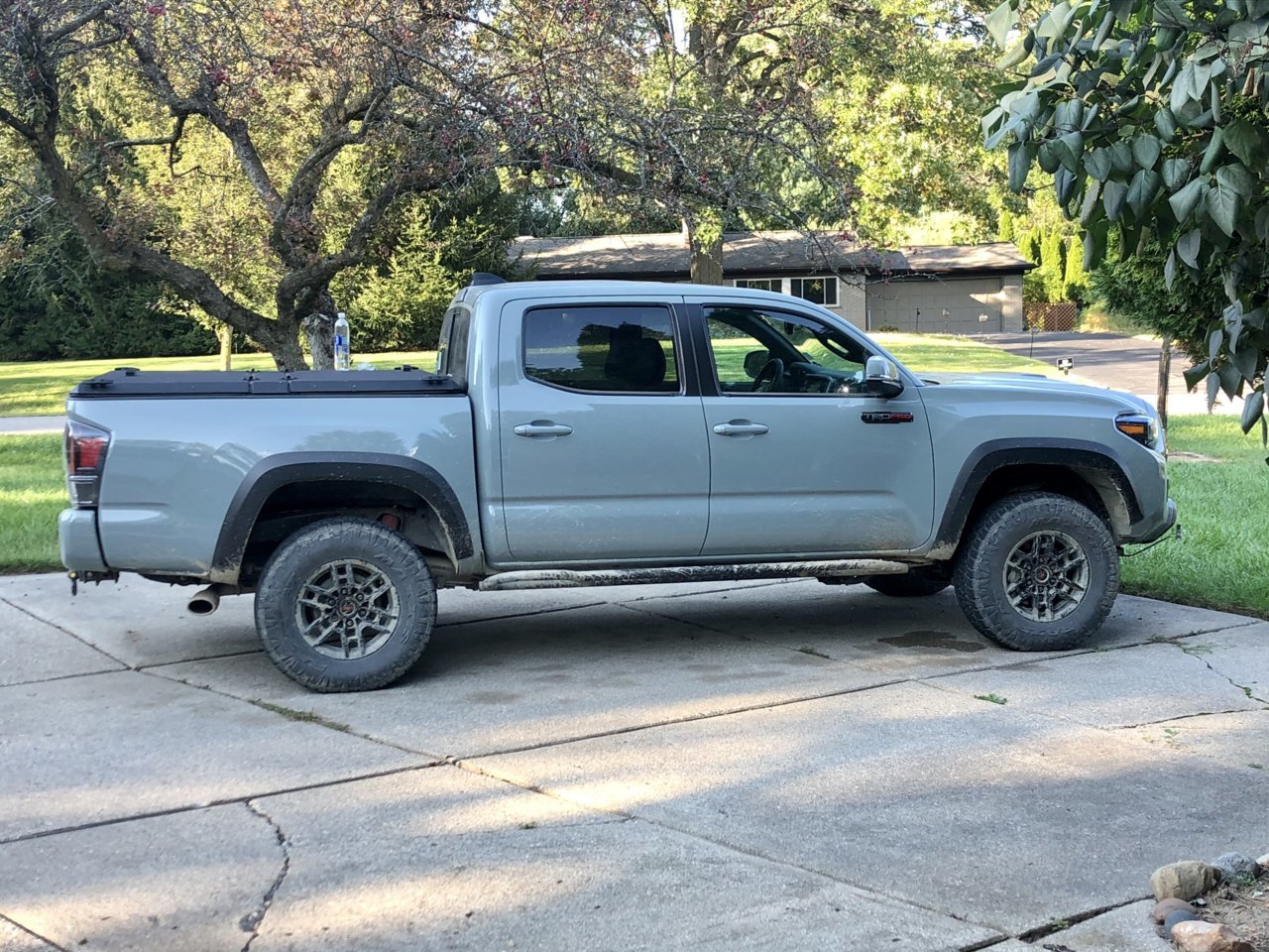

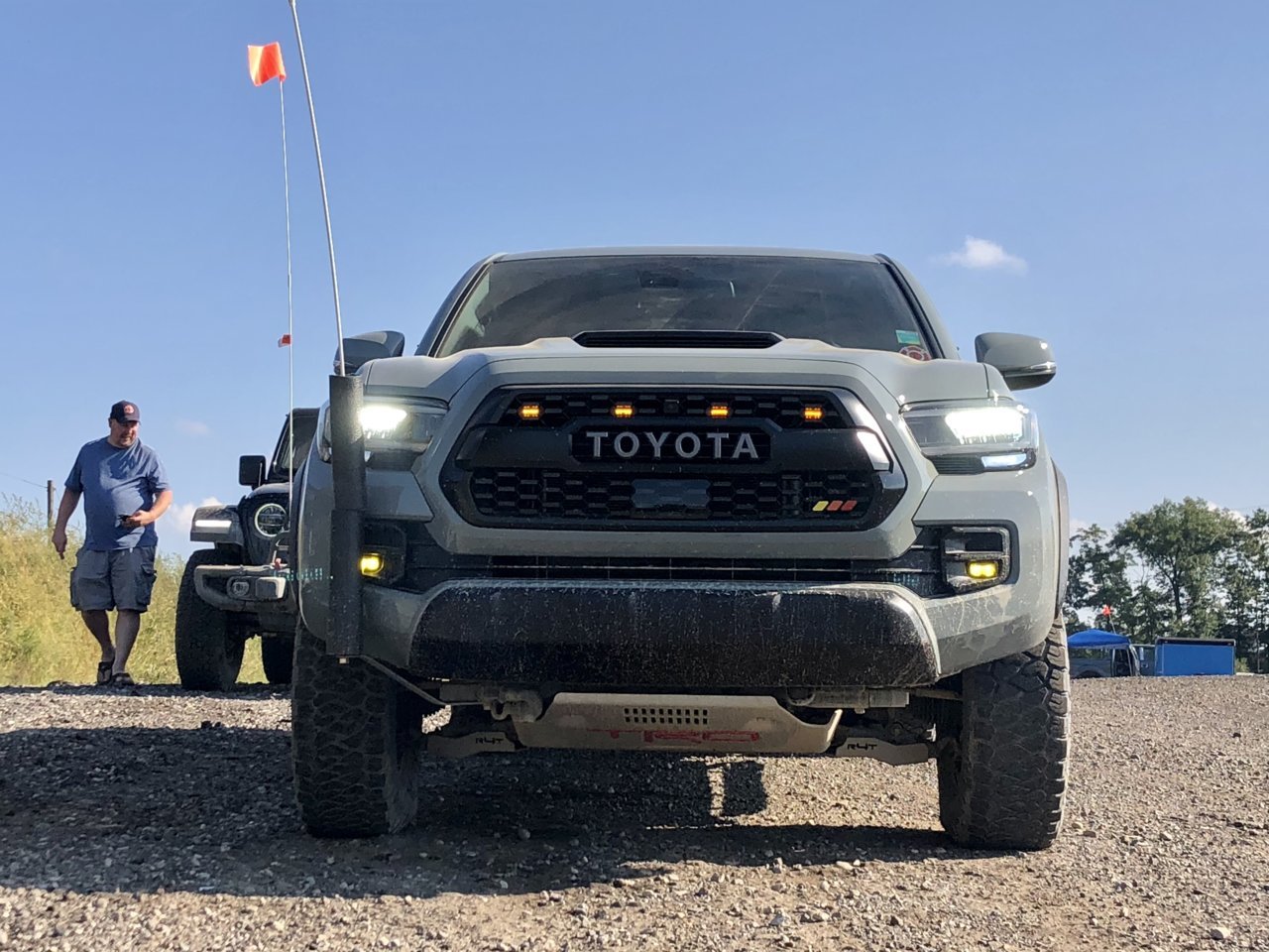

    Took the Tacoma to a local off road park with a few buddies for it’s maiden voyage in the dirt. I wasn’t able to get many pictures because I was busy behind the wheel but had a blast and will definitely be back for more!
    I also feel like LR does an impressive job hiding dirt, well at least in pictures.

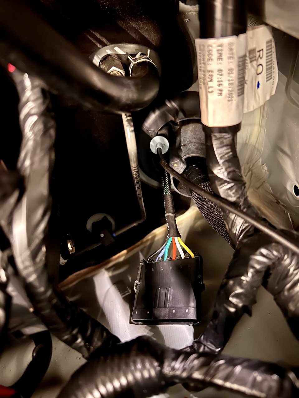

    Smaller mods as of lately, and mostly things that are not very interesting visually, but in the efforts to further catalog progress...
    In the past month or I've done:
    - Clutch fluid accumulator delete mod (dremel hack version)
    - Installed a Core performance shifter

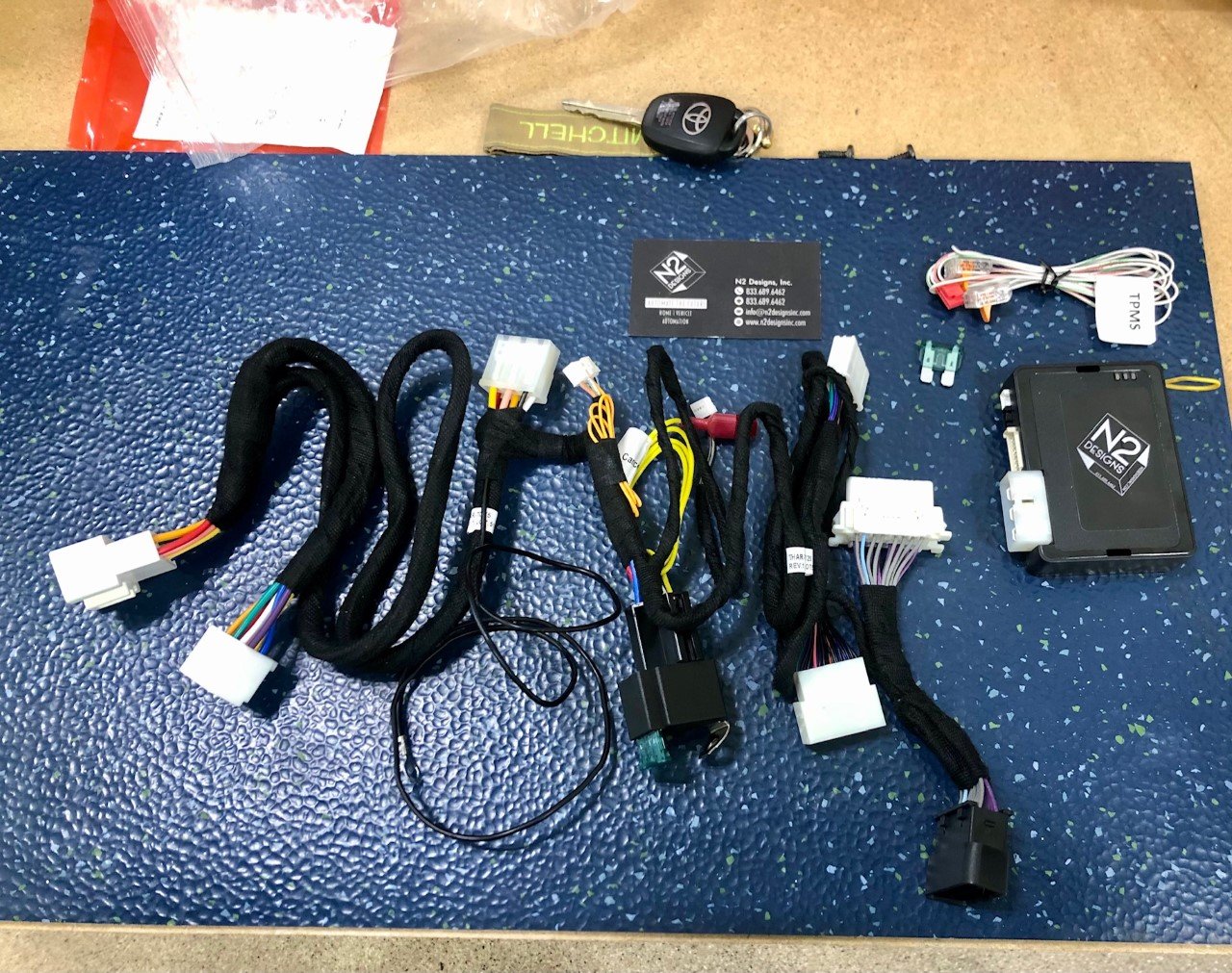

    - Added a N2 remote start and organized/labeled/cleaned up some wiring under the dash

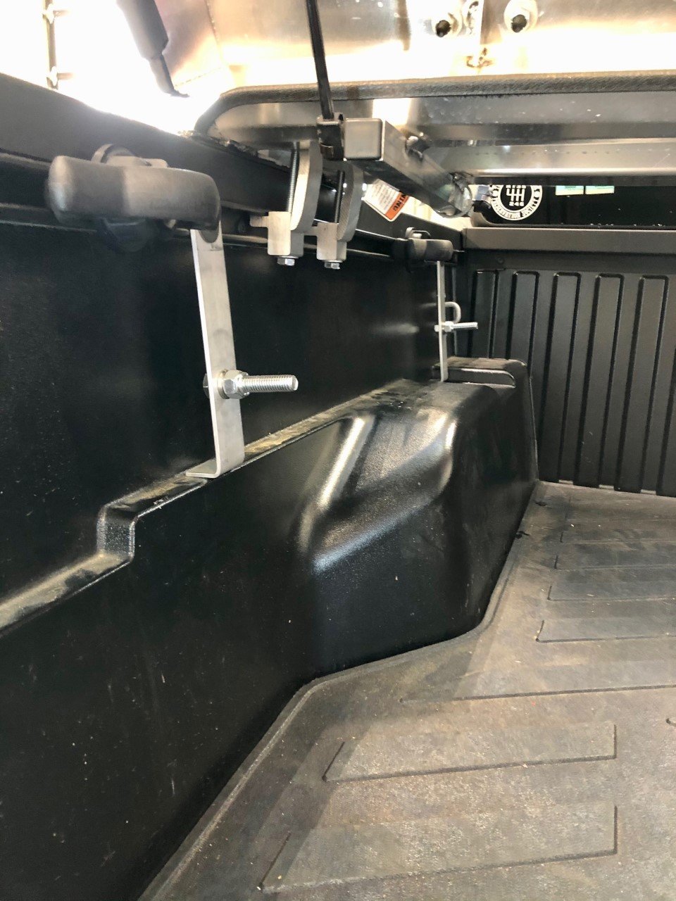

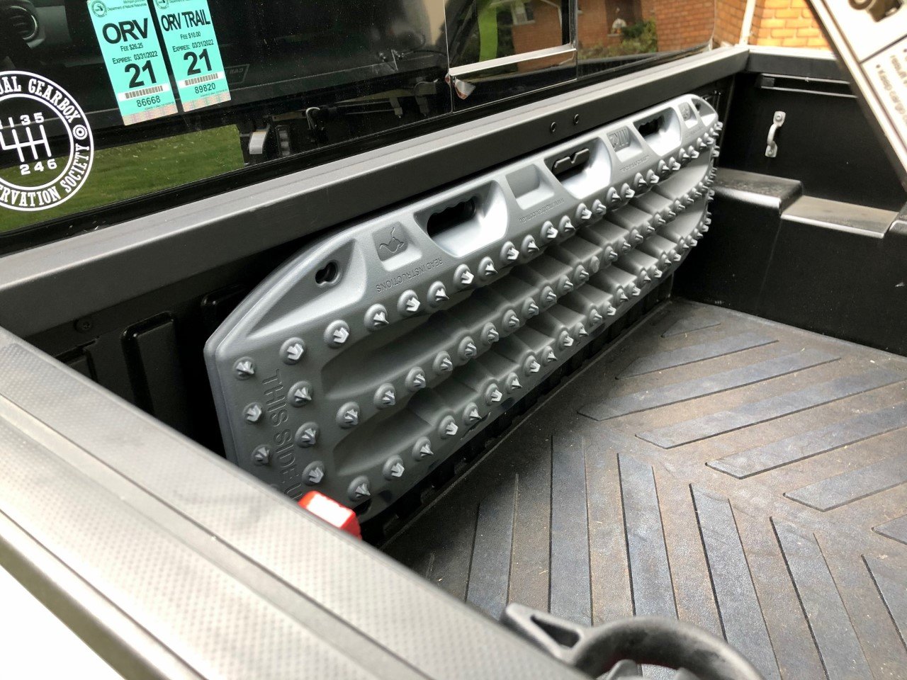

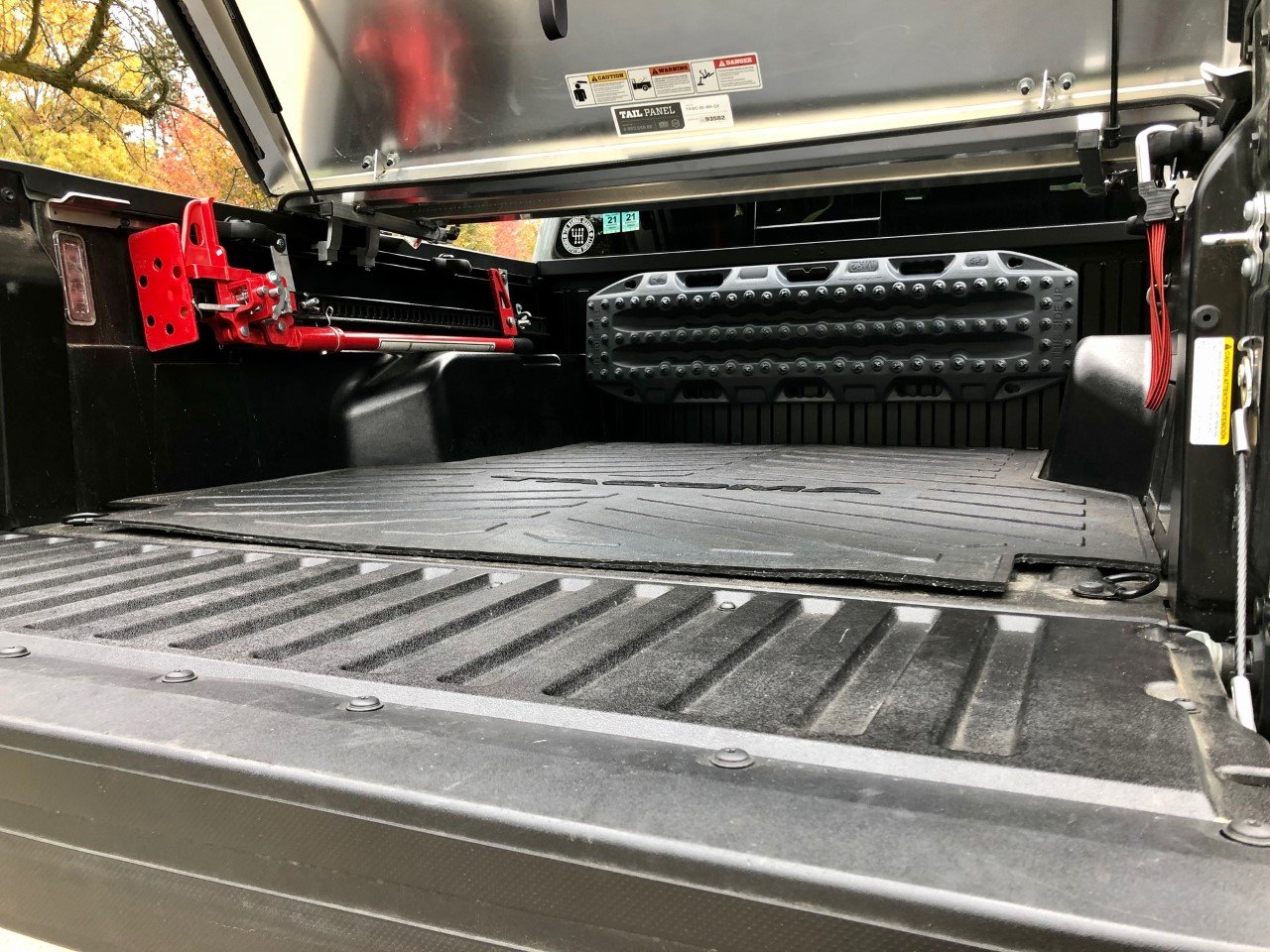

    - Made some brackets for my hi-lift jack
    - Hung my Maxtrax on a QuickLee truck bed mount

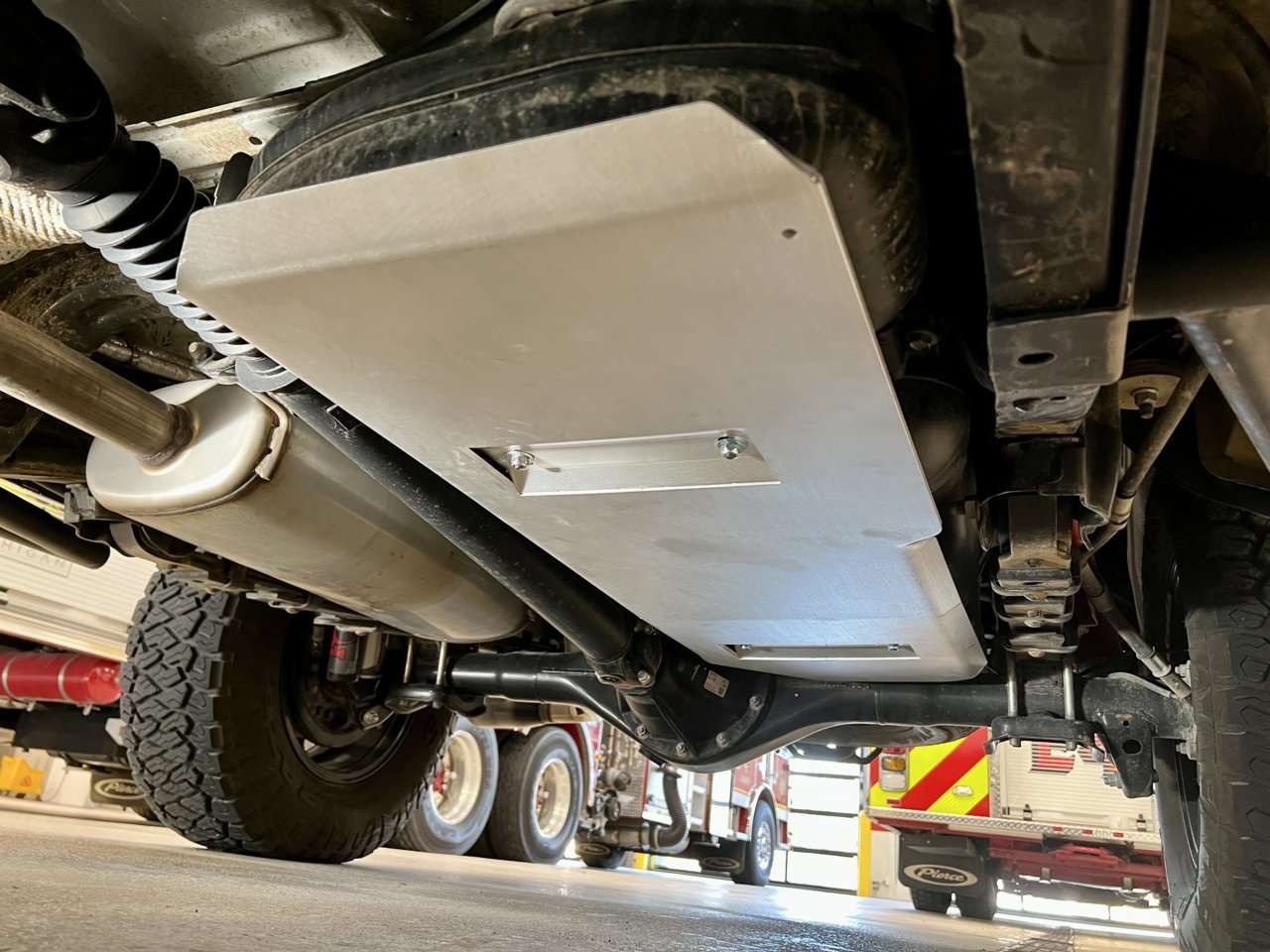

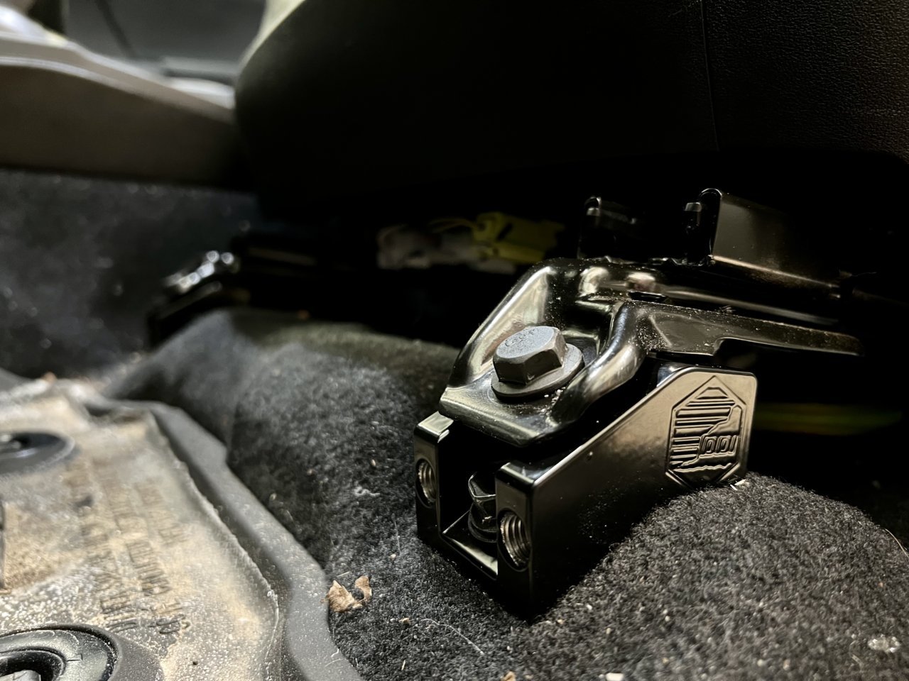

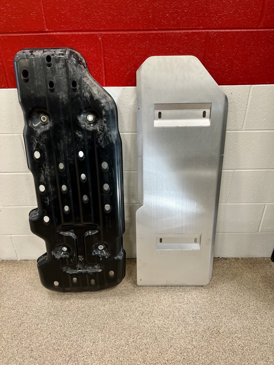

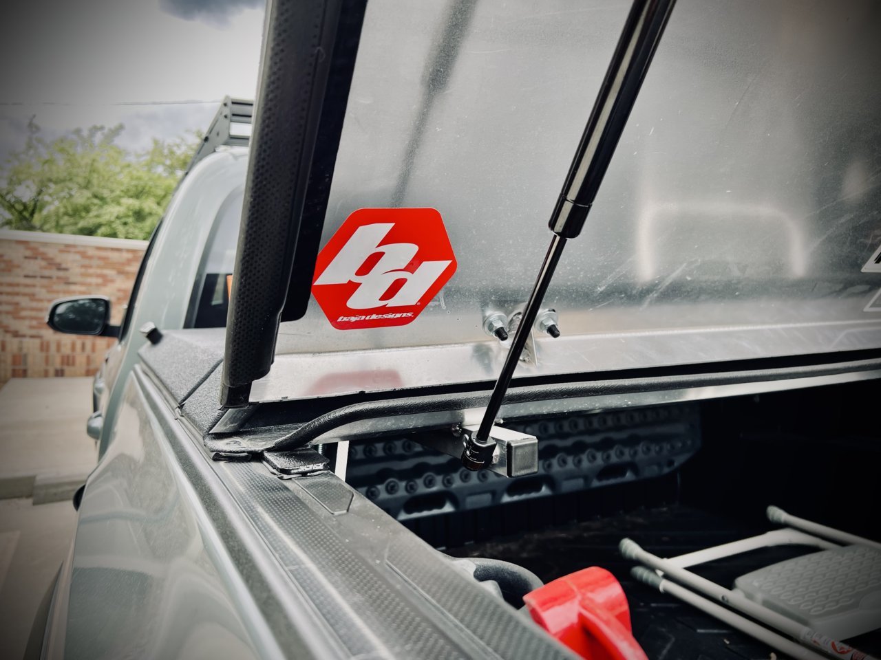

    Few more small updates: RCI aluminum gas tank skid, and DDI seat jackers…
    Also been pretty pleased with Maxxis Razr AT tires so far in snow. Not single traction issue yet! I was even able get enough grip when pulling a minivan out of a ditch during a recent storm.

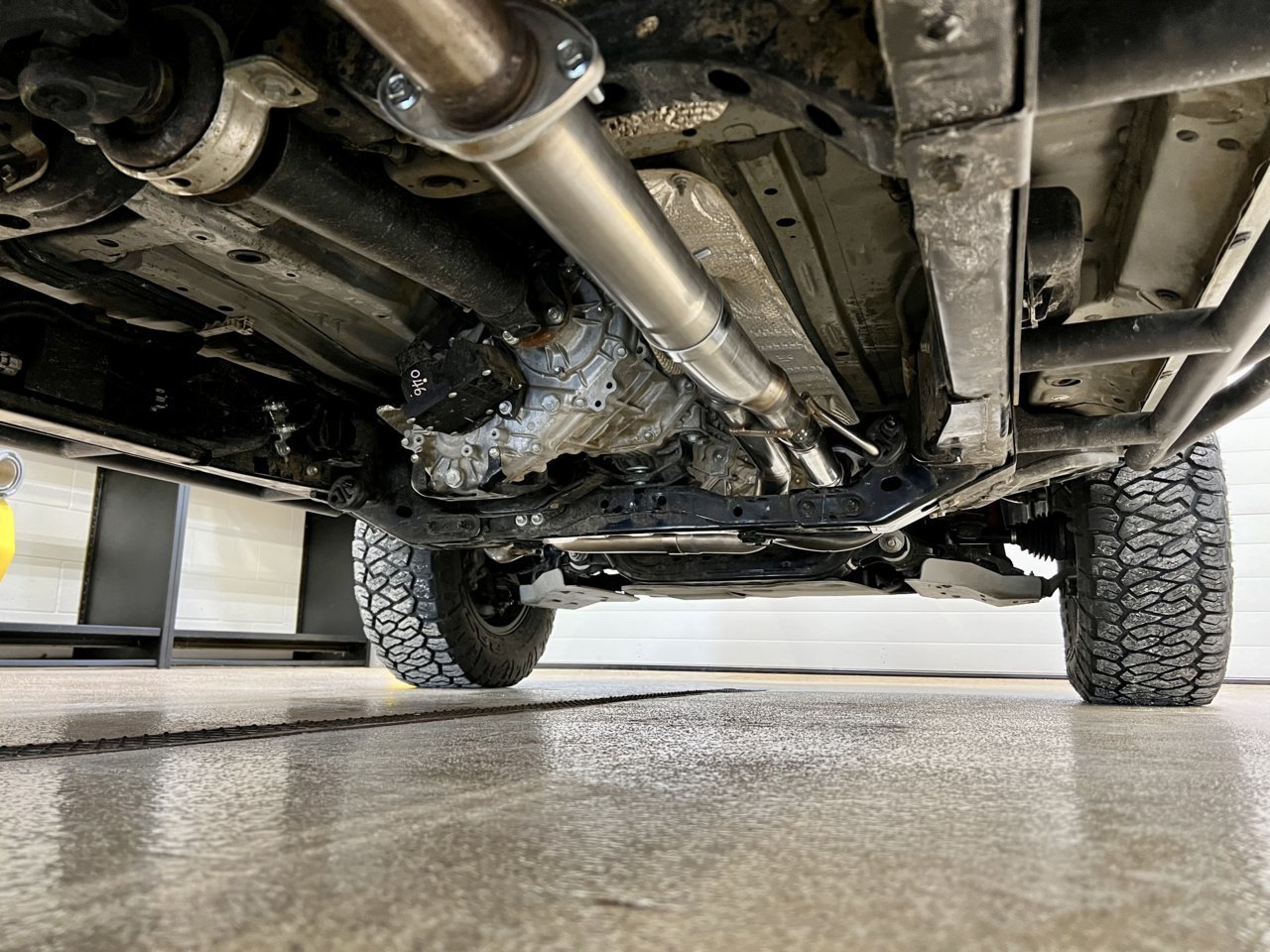

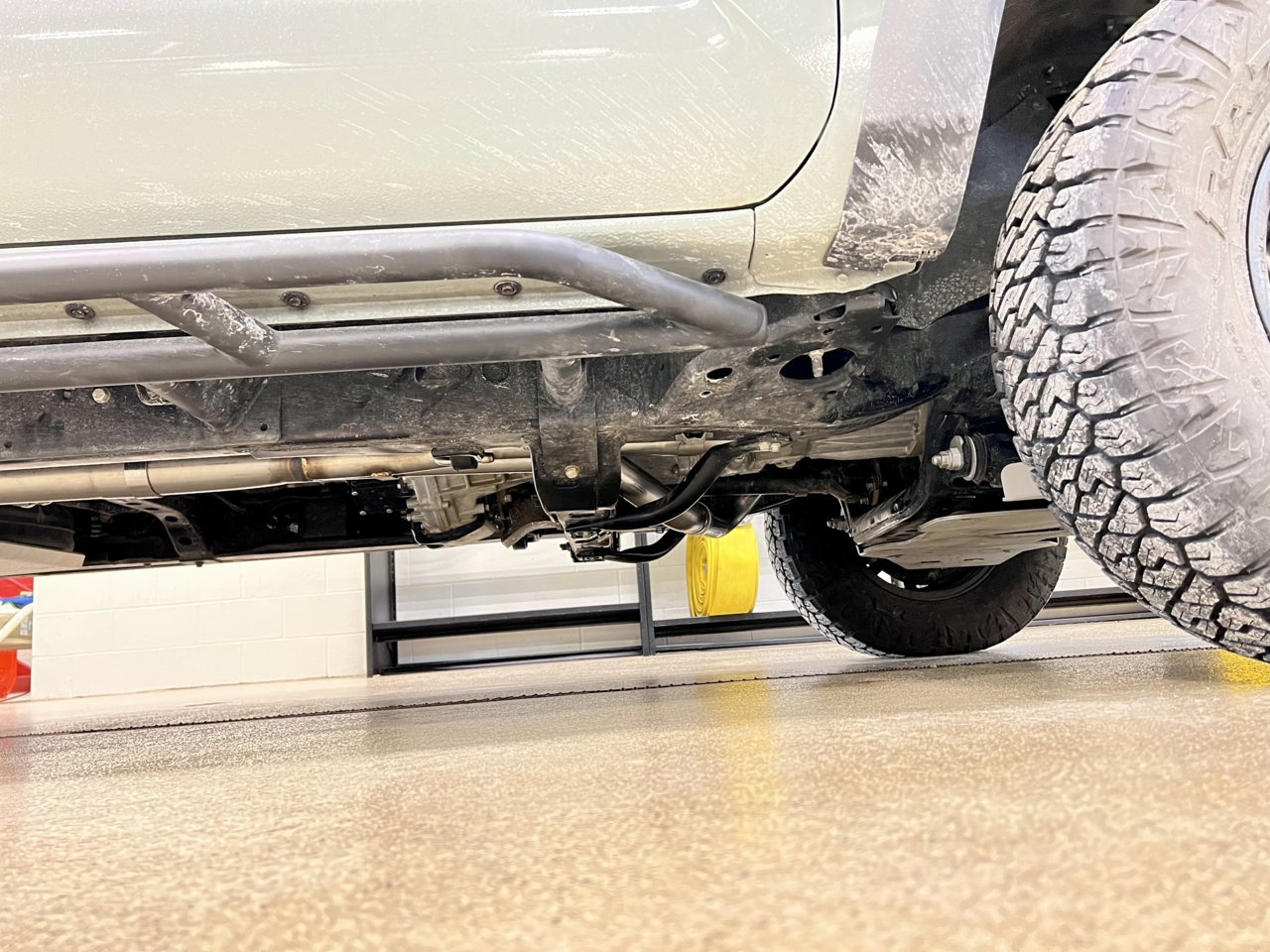

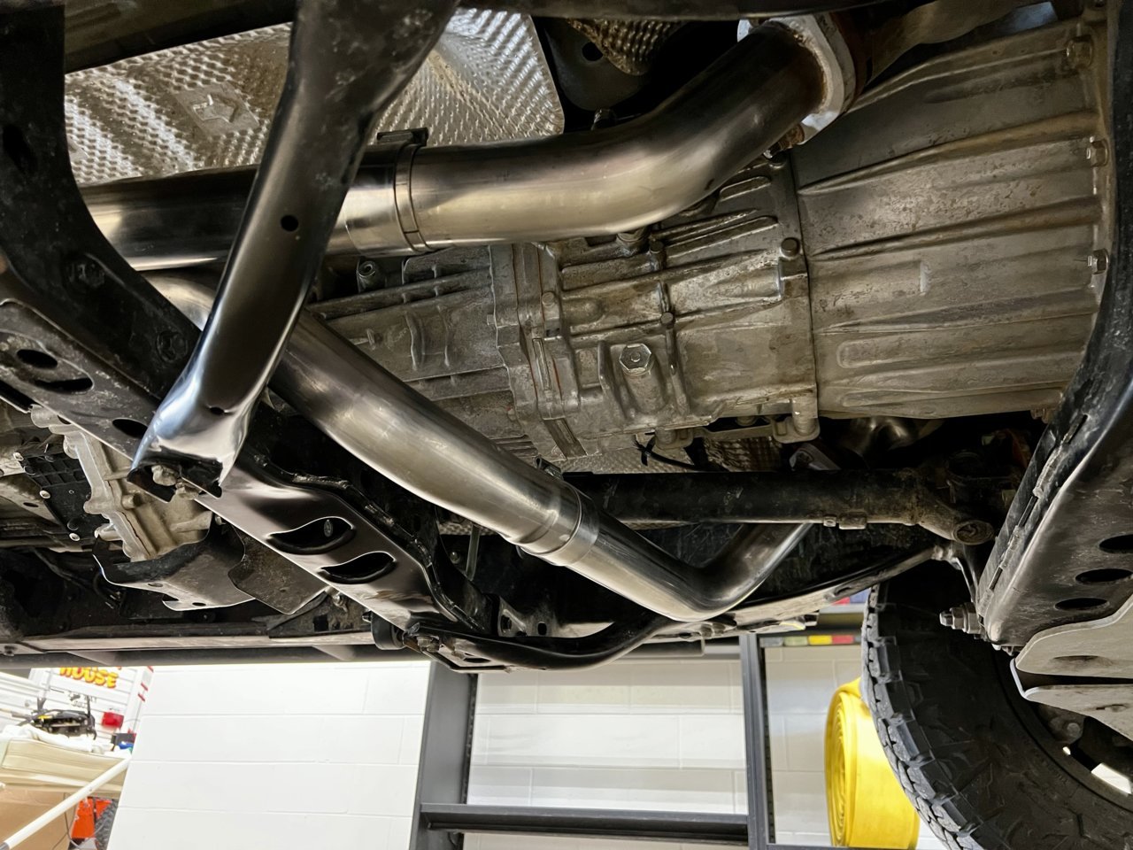

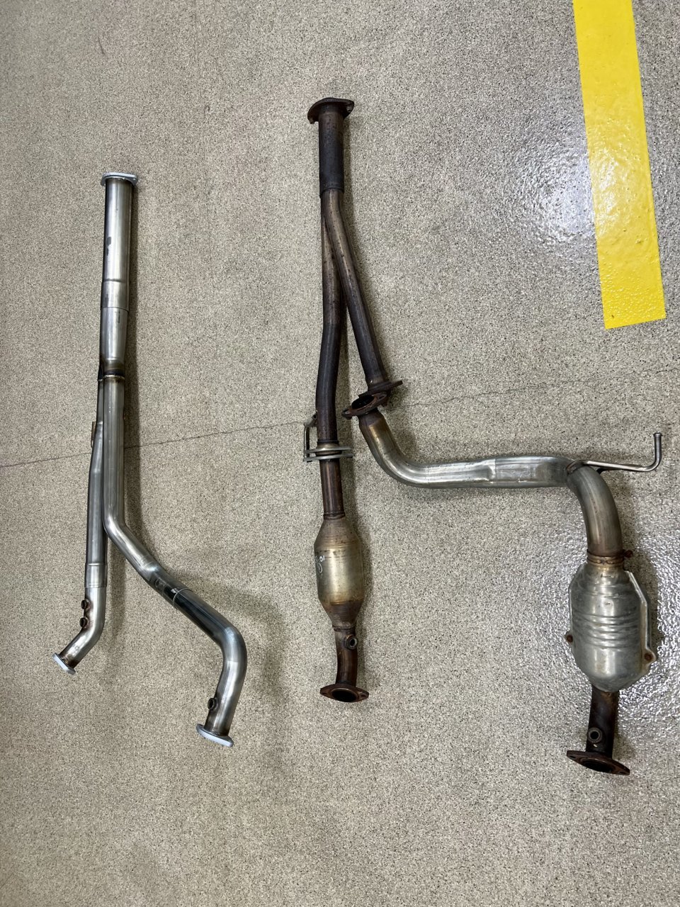

    The URD y pipe went on today. Install went pretty smooth, haven’t been able to drive it much today but I’ll give an update after I have the chance. I’m hoping for at least a minor change in tone and a little bump in performance. Also a plus that it solves the exhaust crossover re-route and tucks everything above the frame.
    Edit: So after driving with the new y pipe for a couple months I can say without hesitation that a difference can be felt and heard, though nothing major on either front. Performance-wise the truck feels like it pulls slightly harder through the power band and power delivery feels “smoother” overall. The sound is only a slight bit deeper and throatier than the TRD cat back alone, but it is definitely pleasant sounding. Still not as aggressive sounding as I would have hoped, but overall I am pleased. I’m hoping once I am able to get a tune that this mod has helped in opening this engine up a bit more.

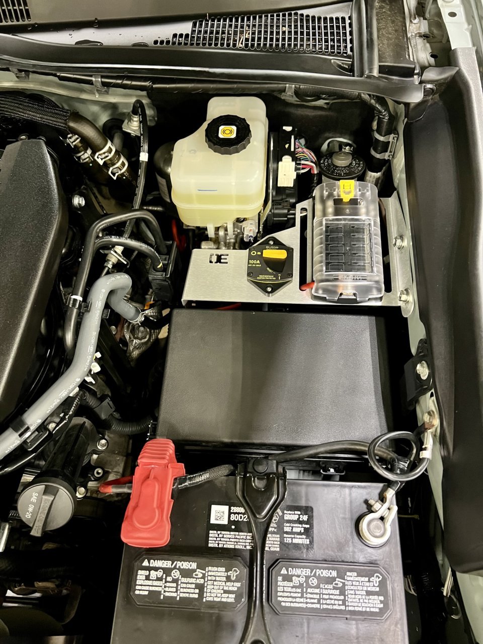

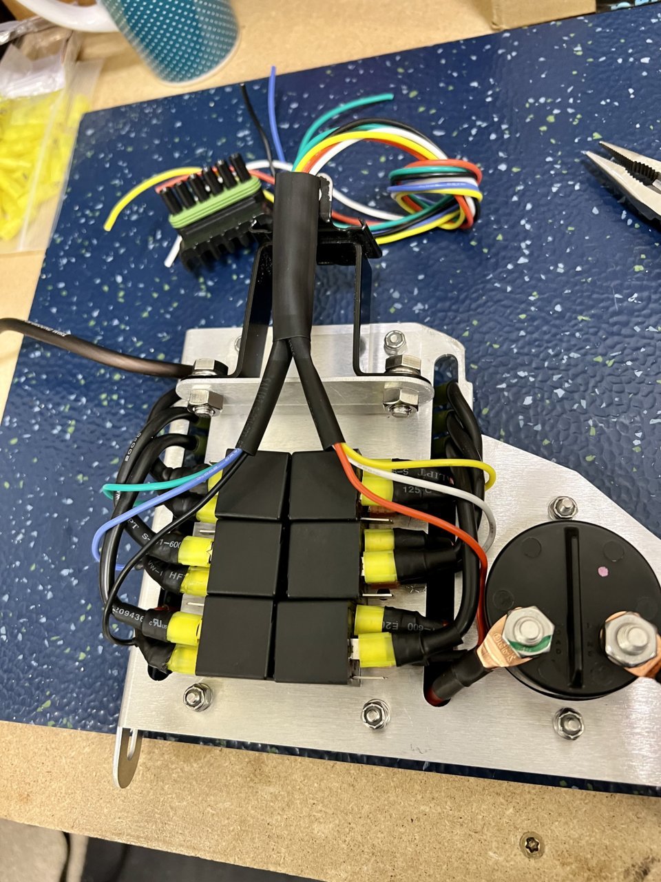

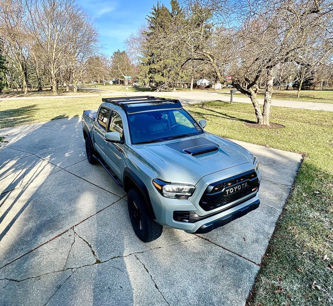

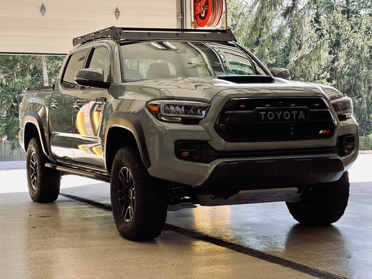

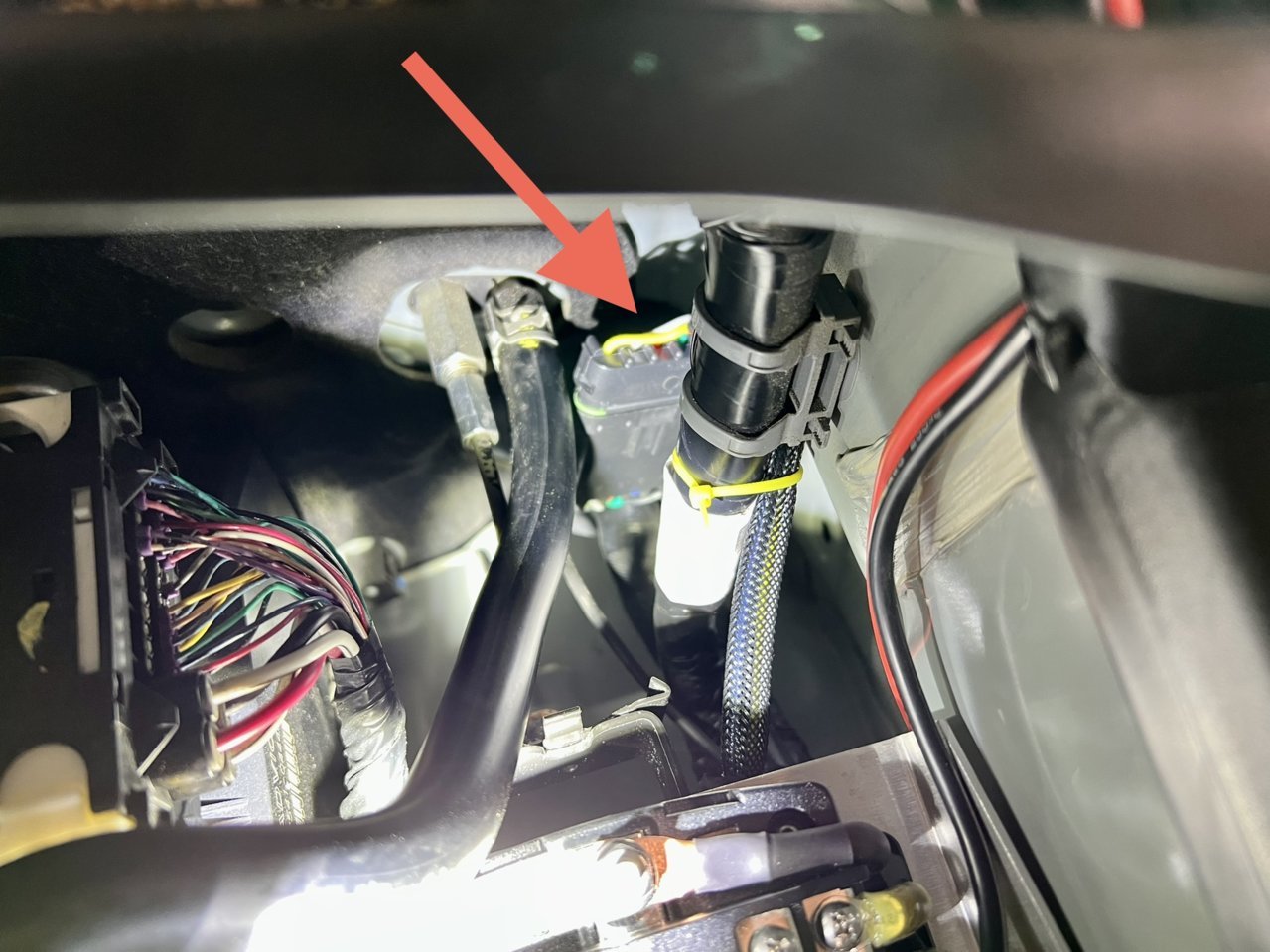

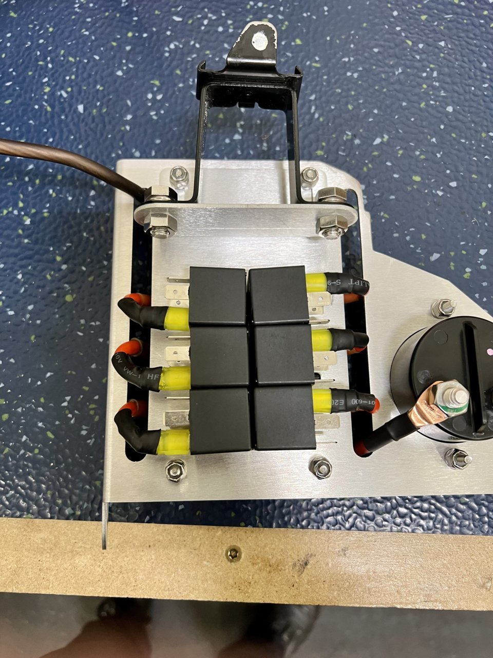

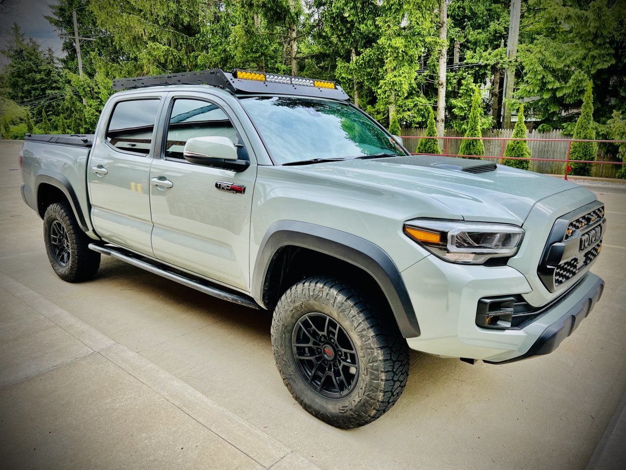

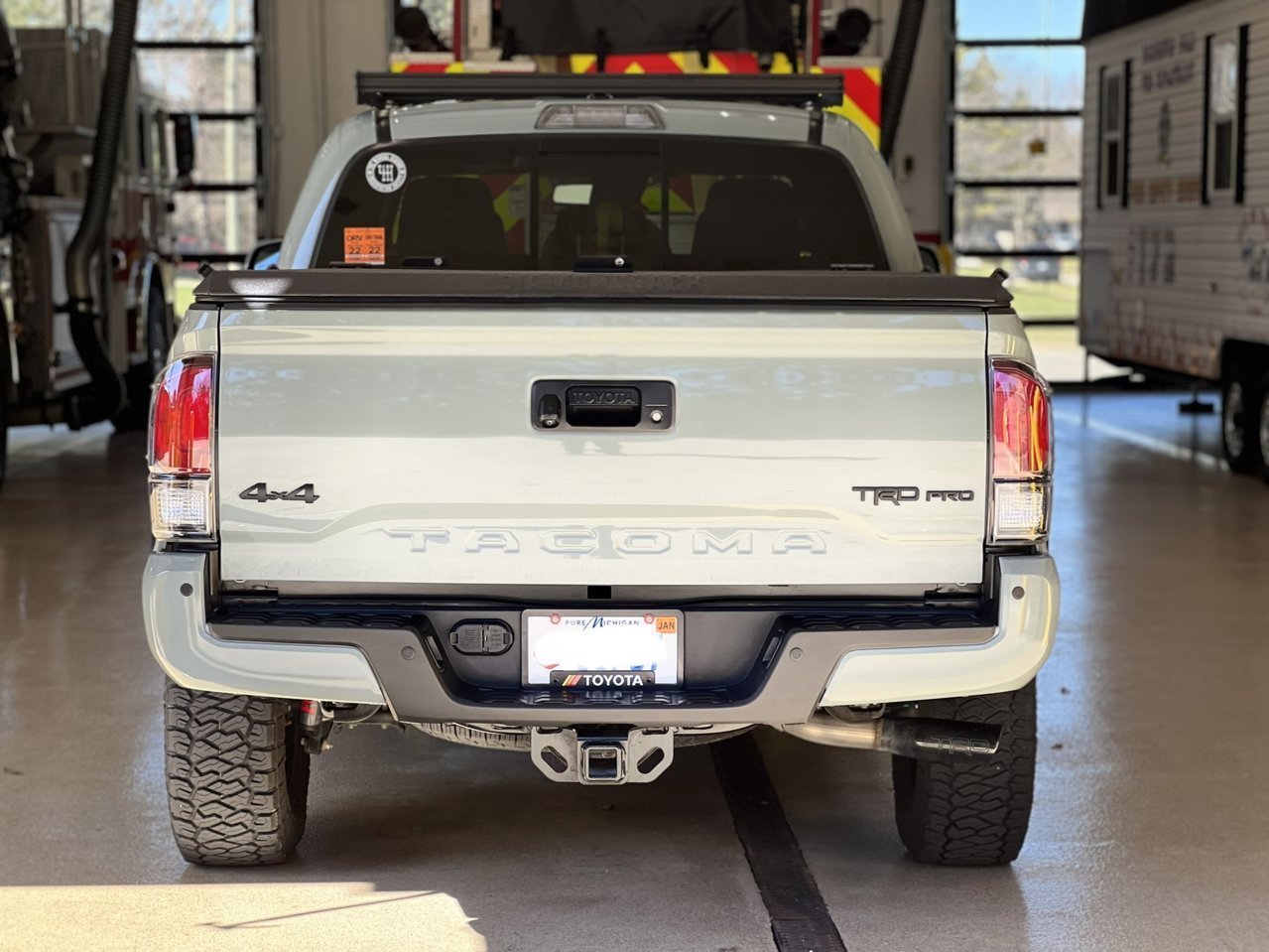

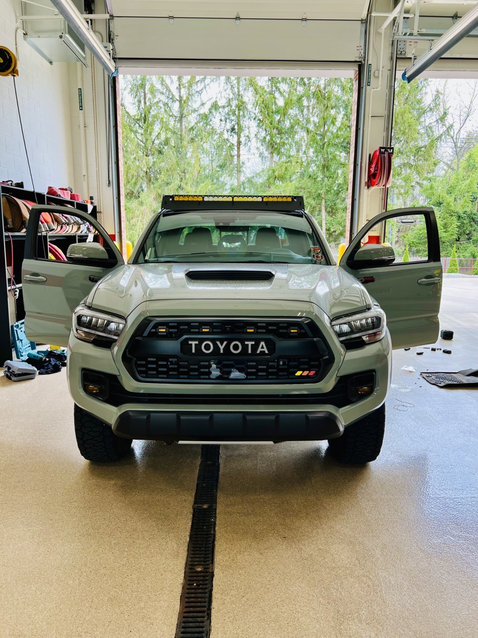

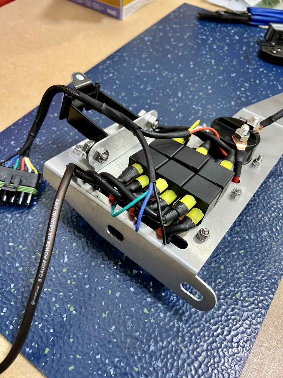

    It’s been a bit and I have some catching up to do here. First upgrade to report is a Martin roof rack:

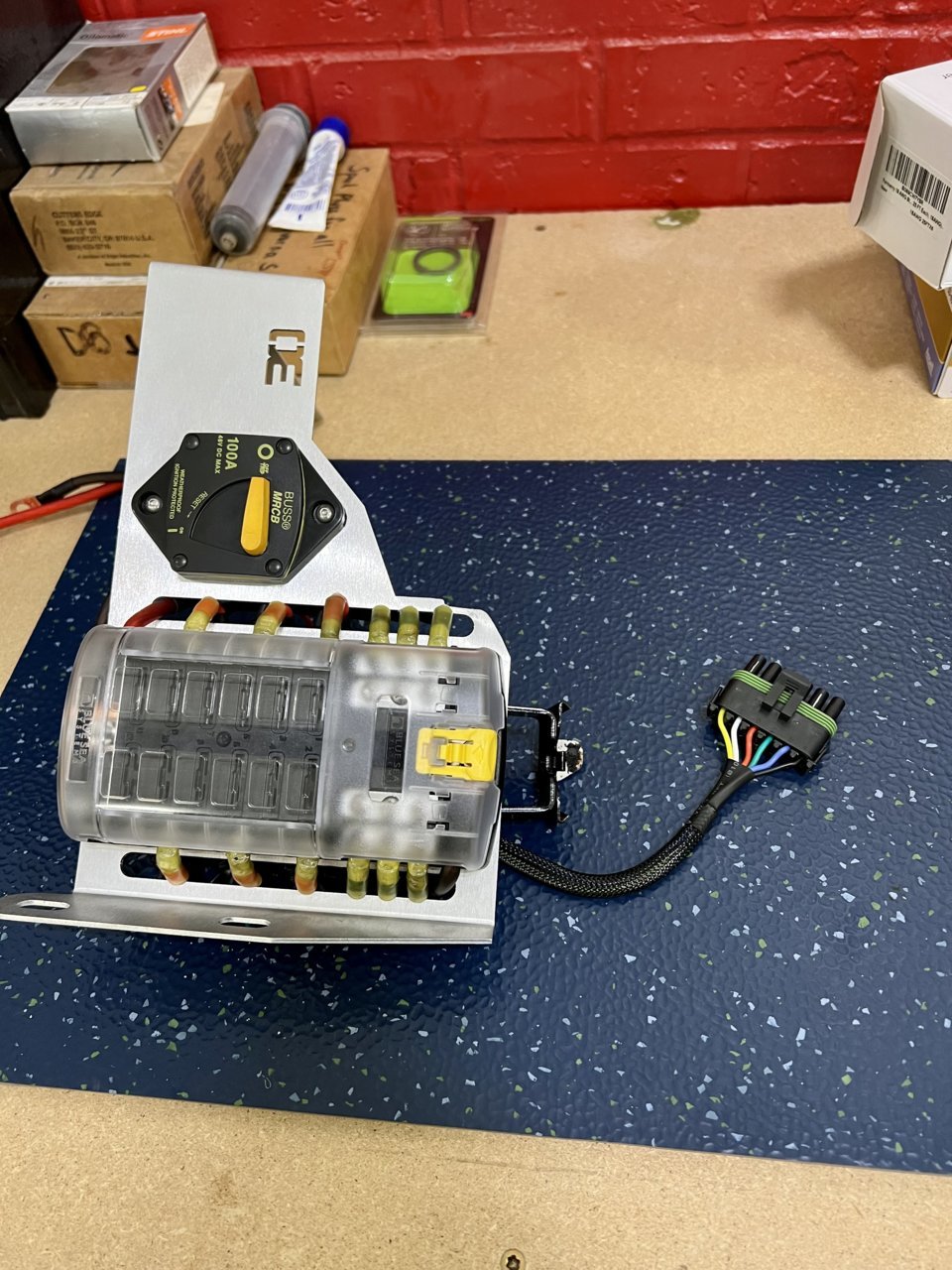

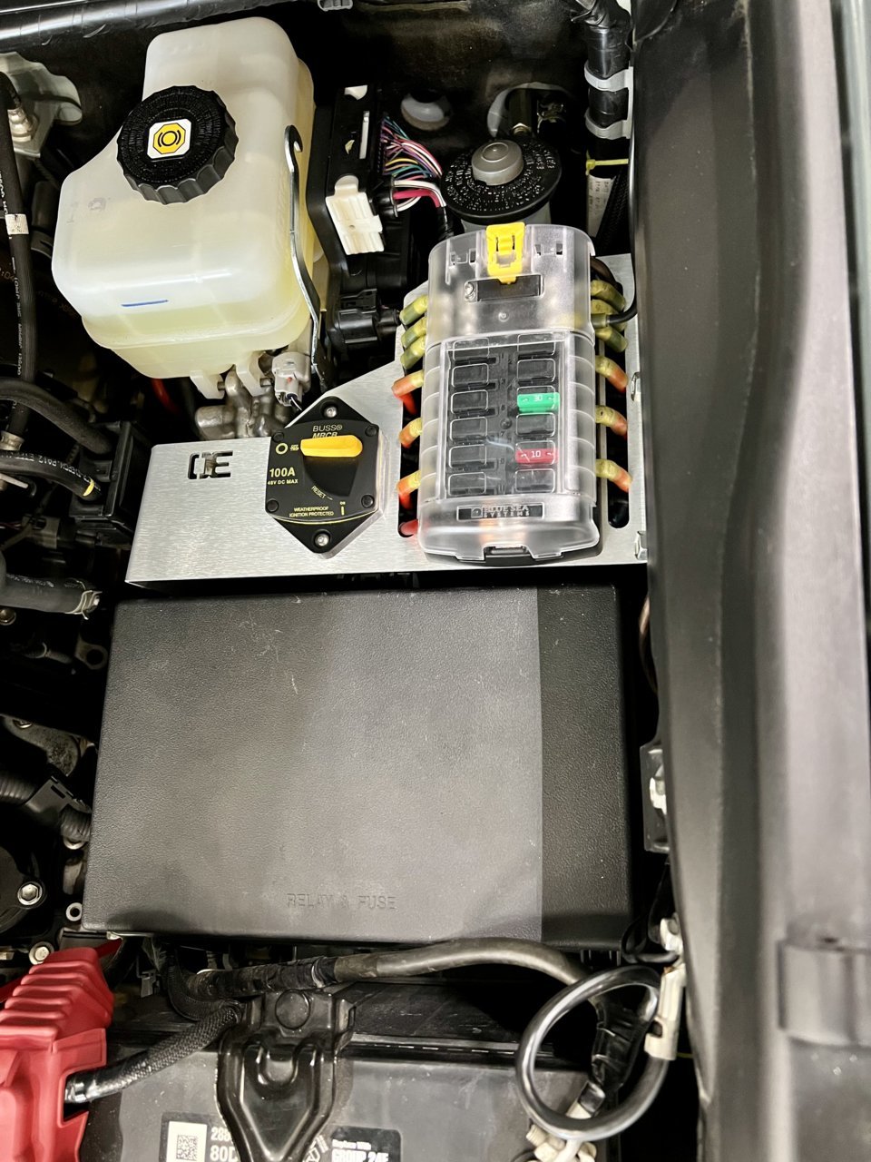

    Since the rack is in place, it’s time to start preparing for some high lumen goodies to attach to it. I embarked on a little crash course on electrical systems and wiring as I decided to tackle all the wiring/harnesses project myself. Google, YouTube and this thread helped immensely:
    https://www.tacomaworld.com/threads/diy-build-and-install-a-bussmann-rtmr-fuse-relay-block.399454/

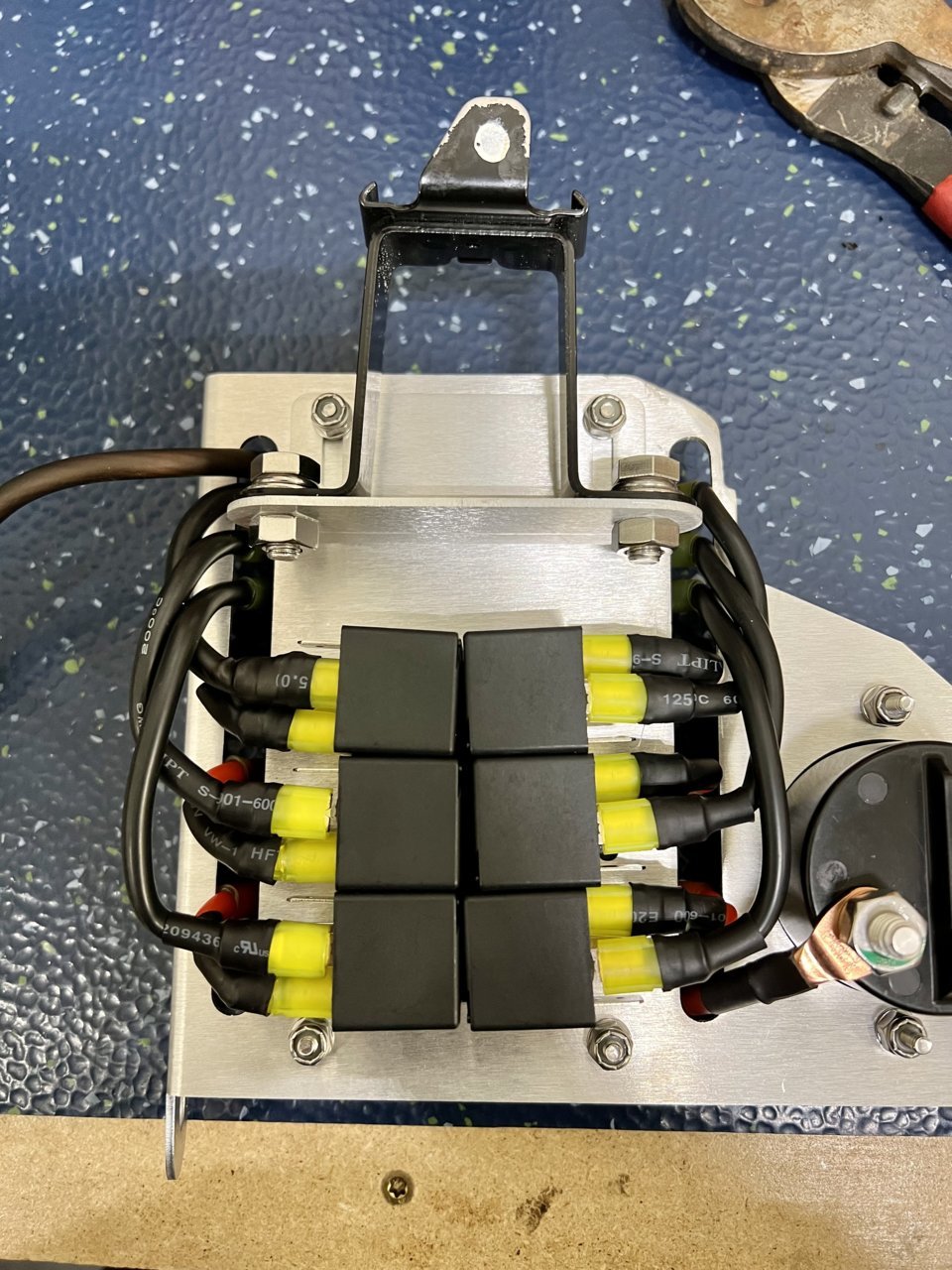

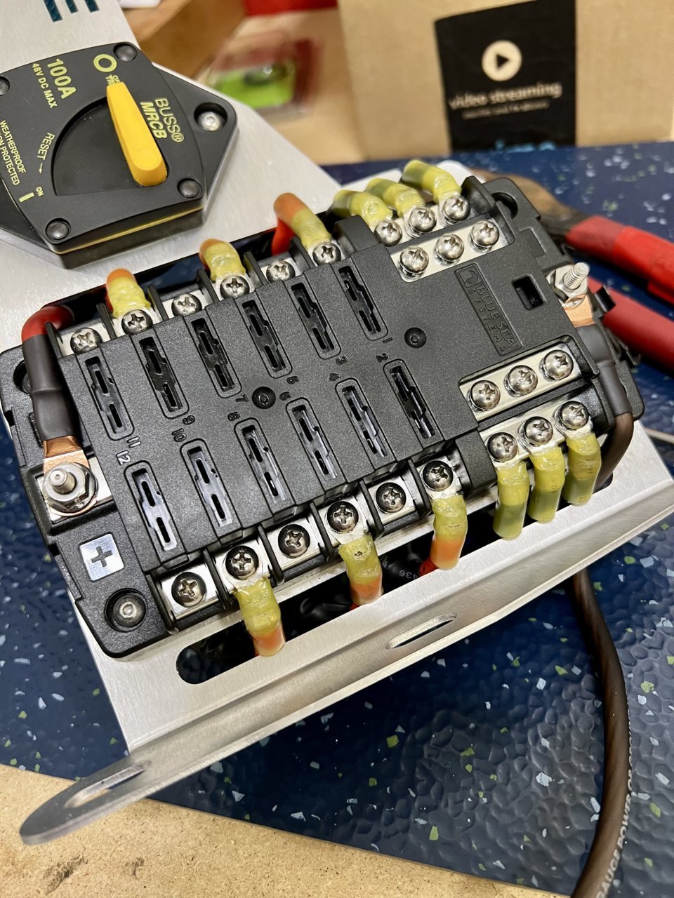

    Im going document my progress so far but keep in mind this is my first attempt at anything like this so if anyone has any feedback or suggestions please speak up!
    As always, my goal is to keep thing as clean and “stock” looking as possible and also as streamlined as possible for easy troubleshooting and high flexibility for changing things up as I continue to work on the truck. I decided on an auxiliary power tray from Overland Equipped as my basis for my wiring project. Below was initial installation for testing fitment and clearance for my future plans:

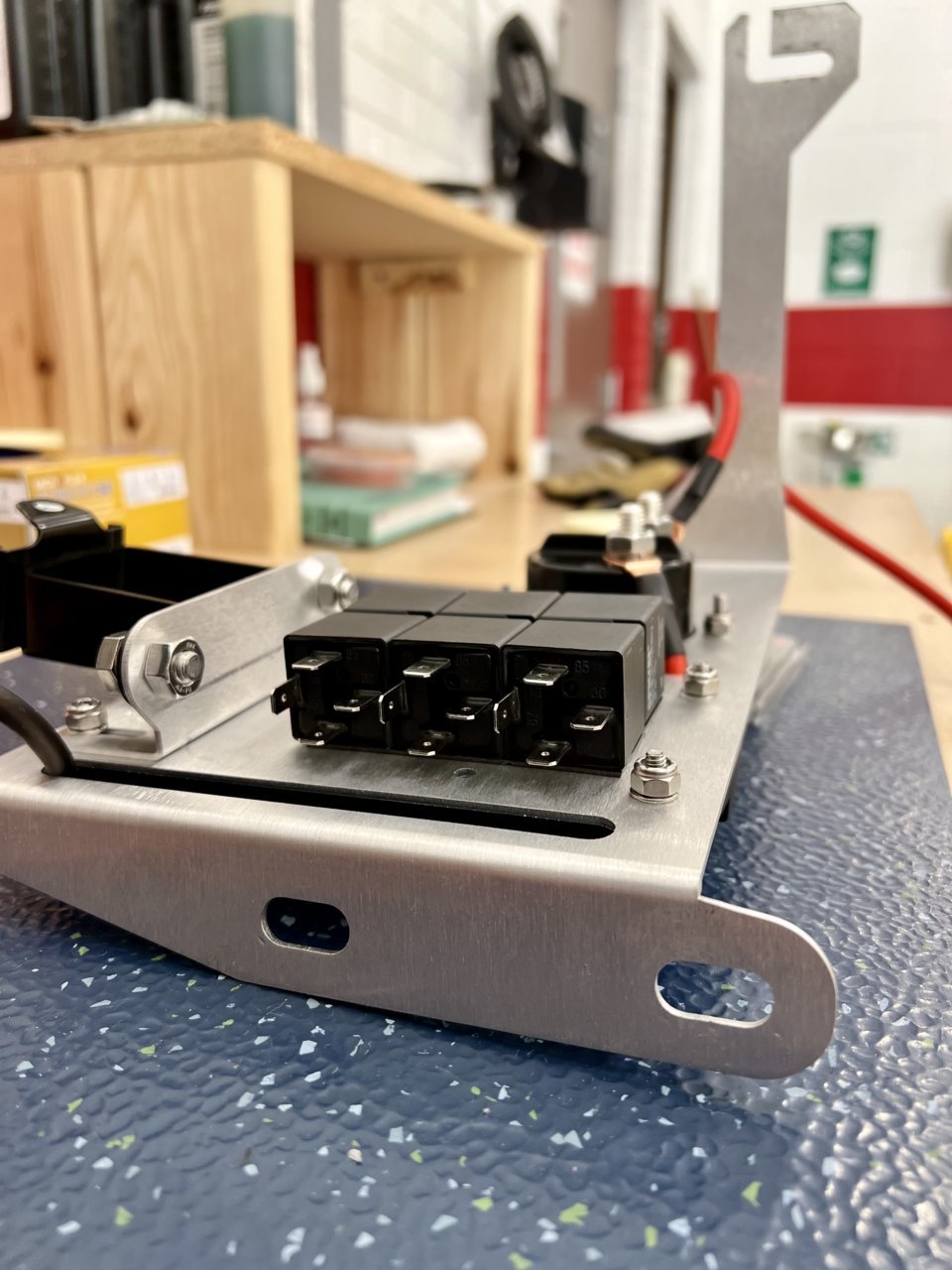

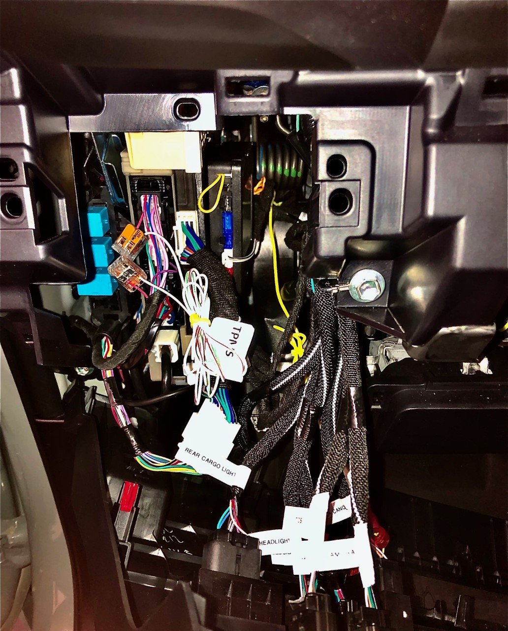

    I then cleaned up some edges and did a little trimming in the corner where the break booster line was in contact with the bracket. Next I started by mounting my relays on the underside of the bracket with 3M double sided tape.

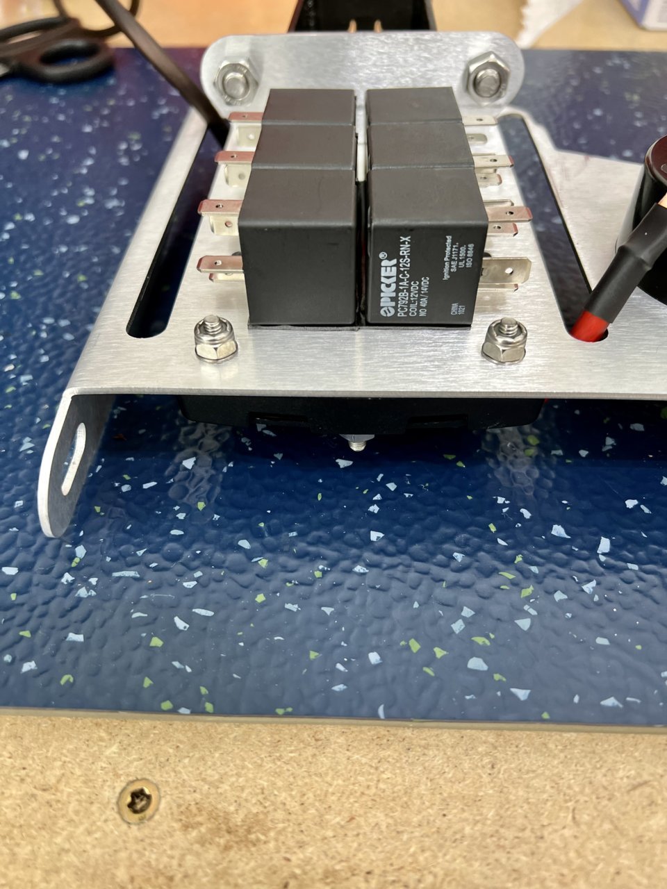

    Then I pre-wired the relays to the positive and negative terminals on the fuse block:

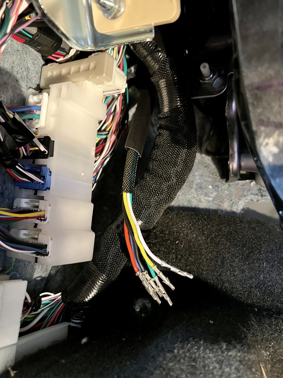

    I wired everything up conservatively with 10 awg wiring (probably overkill) to have each relay equally capable as far potential draw to prevent me from needing to redo any wiring down the road. I then wired 18 awg to each of the relays and created a pig tail with a weather pack connector for quick disconnect if/when I had the pull the tray out. Each one color coded:

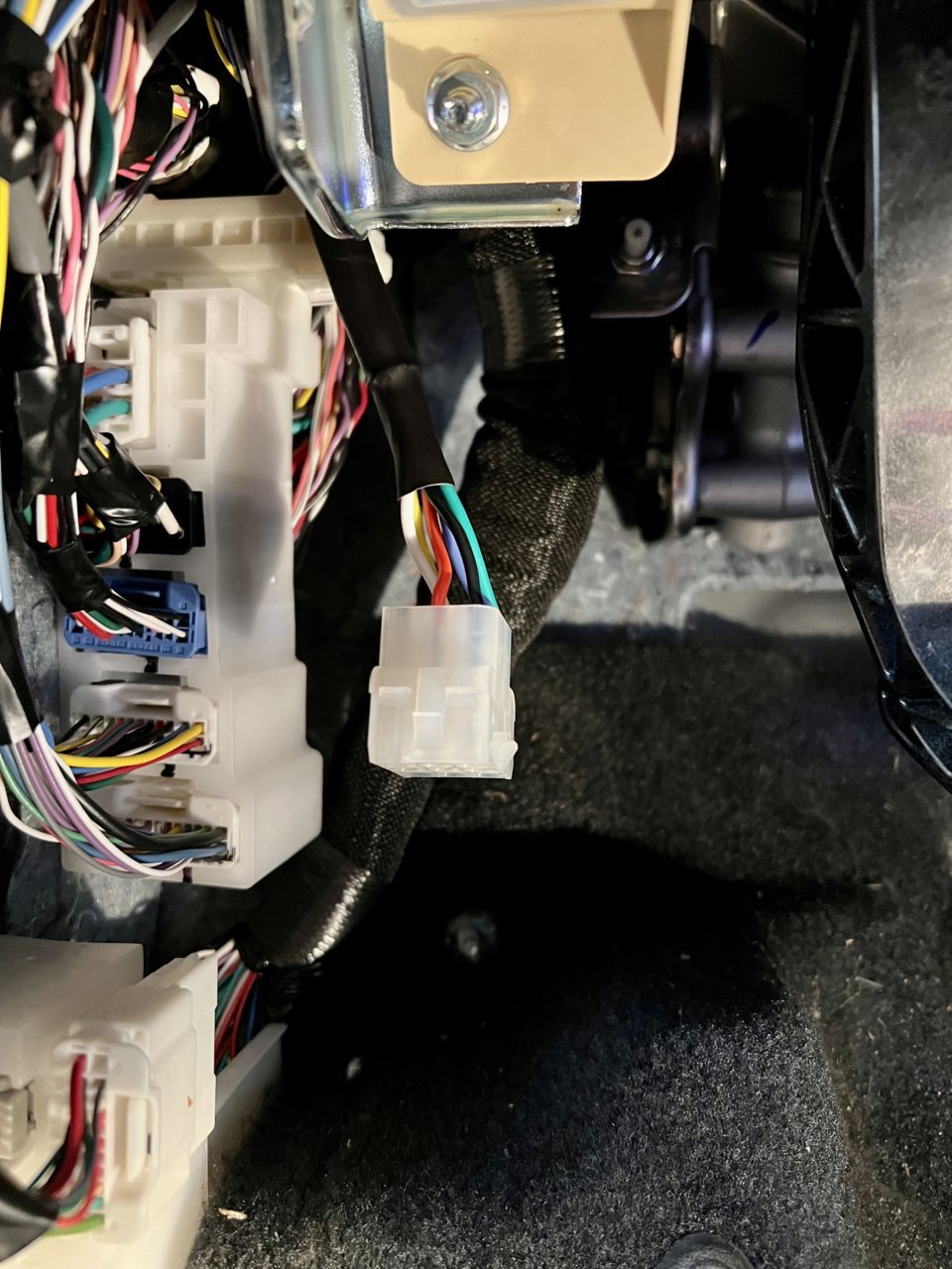

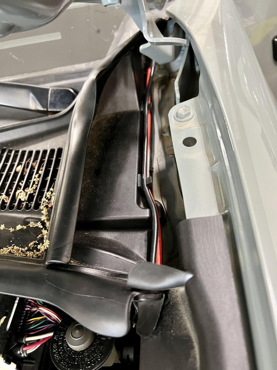

    I then bundled the same respective color coded wires and made a short harness and passed it through the driver side firewall grommet. In the bay is the female weather pack connect to mate with the power tray, and in the cab is a multi-pin Molex connector. This gives me 6 open pins to wire as I see fit. My immediate plans will occupy at least 4, the last two I’m sure I will find something else to add in the future.
    Engine bay:
    Cab under dash:

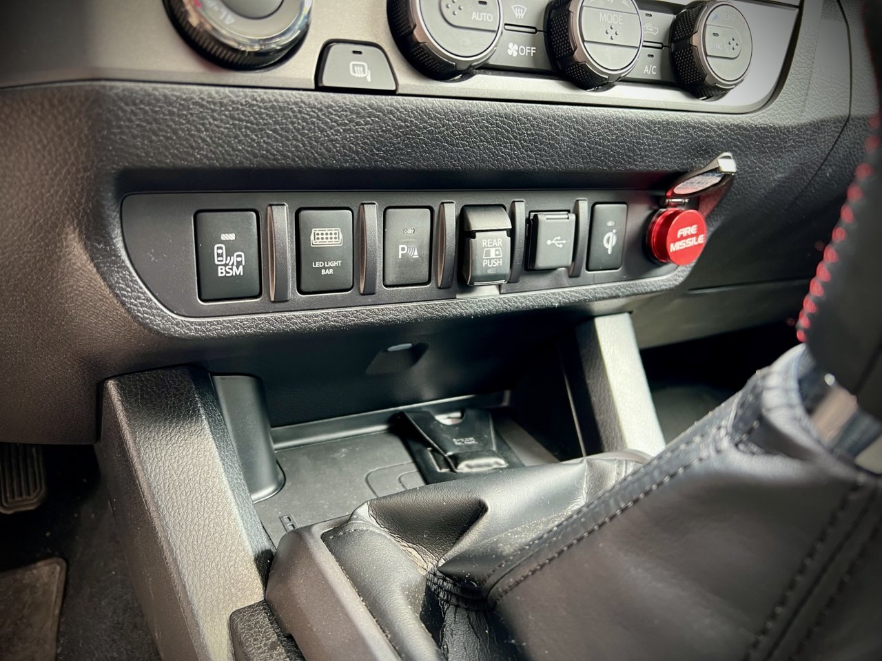

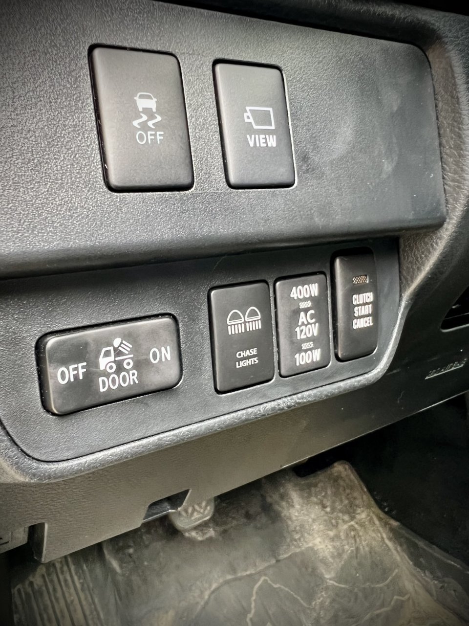

    While I waited for my back order lighting to come in I installed some CH4x4 push style switches in the cab and wired them to the Molex connector under the dash.
    I had one blank in the center (I think where ETC would be if it was an auto trans), second from the left, which will be for my light bar.
    I removed the auto headlight button that I would never use, taped it and tucked it behind the dash and replaced it with a switch for the chase lights I will be eventually installing. I’m not sure I’m 100% satisfied with the CH4x4 blue lighting. Too far from the stock switch lighting, I might switch this up in the future…
    My Baja Designs Onx6 40” light bar arrived just the other day:

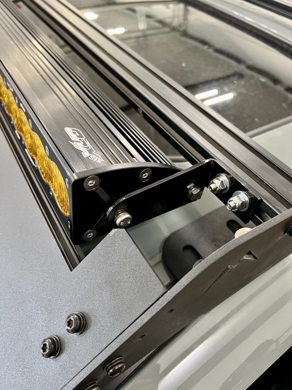

    Though unfortunately the brackets that come with the light bar won’t work with the Martin rack. After some deliberation I decided I’ll fab some brackets and mocked up the light for measurements… and also because I couldn’t help myself from wanting to see a sneak peek:
    That gets me up to date, more pics and progress to come soon!

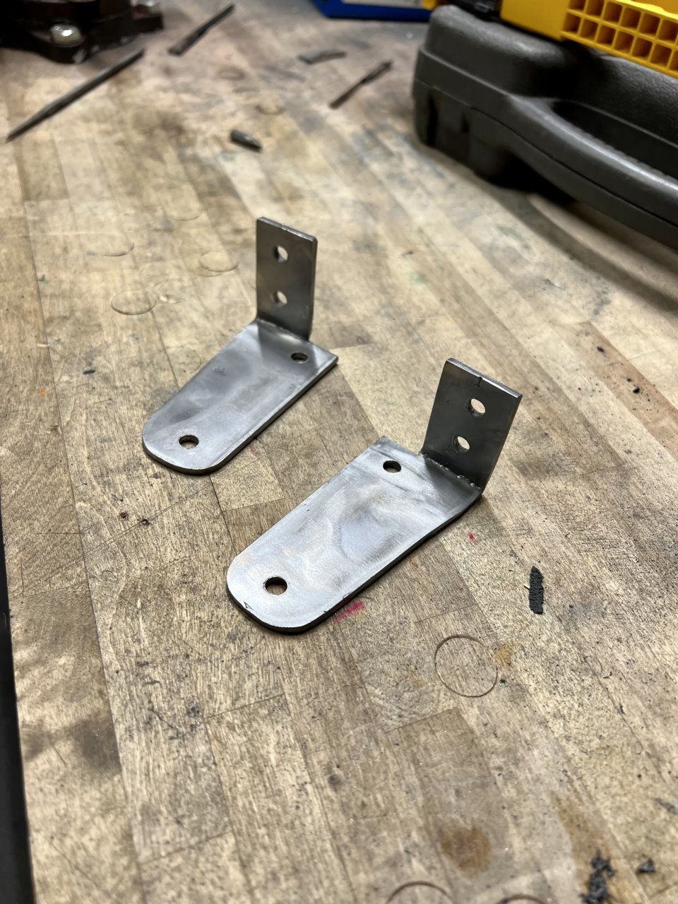

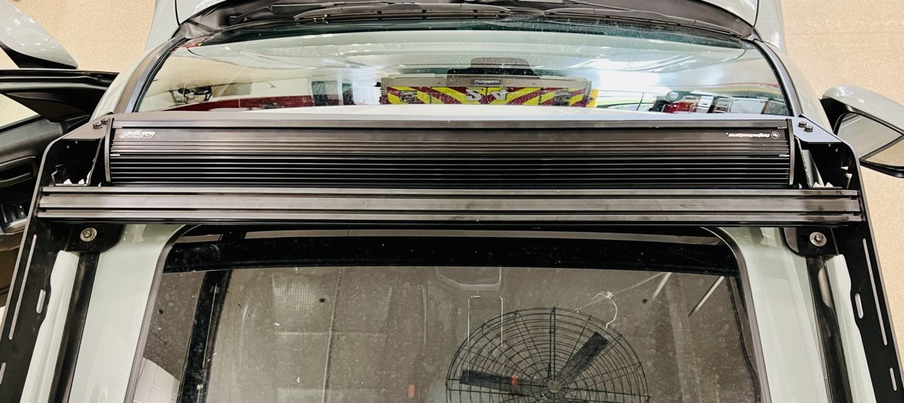

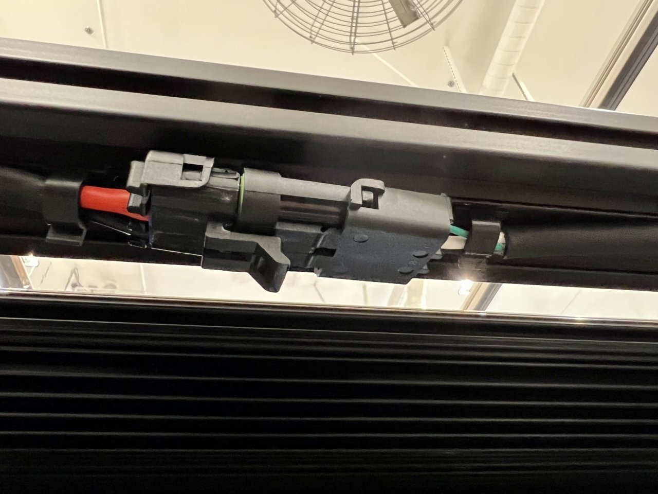

    I couldn’t find any easily accessible brackets that would marry a BD light bar to the Martin roof rack so I ended up making some simple ones out of 1/8” bar steel, painted them and mounted the light:

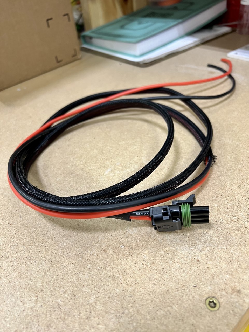

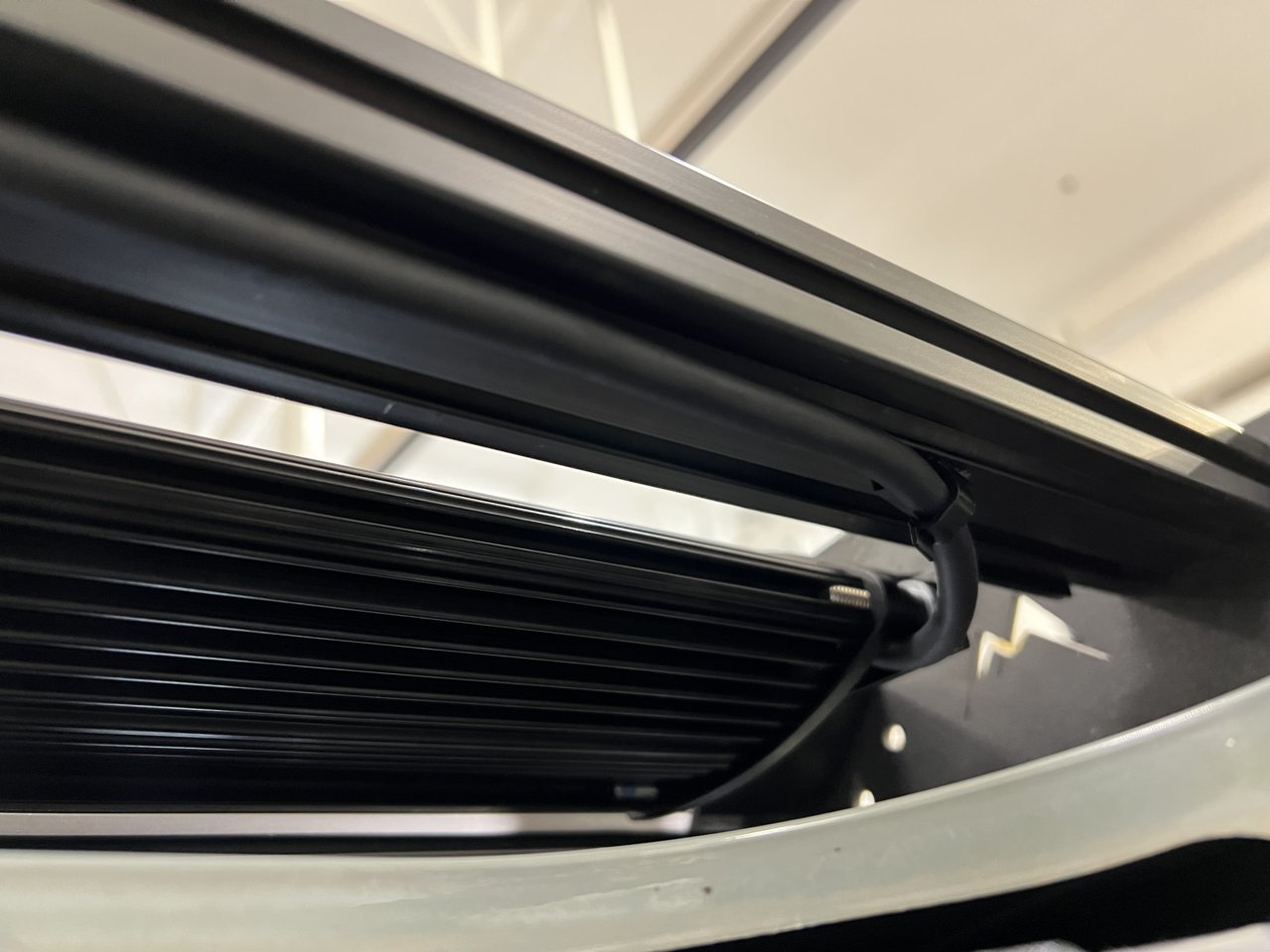

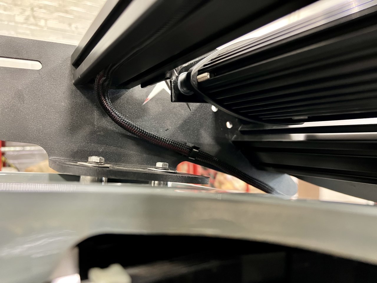

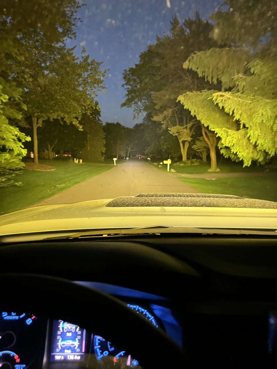

    I then started on the harness for the light and tried to run the wiring as cleanly as possible. The plug and most of the wiring I was able to tuck under a cross bar and used a universal wire hider down the driver side A-pillar to under the hood.

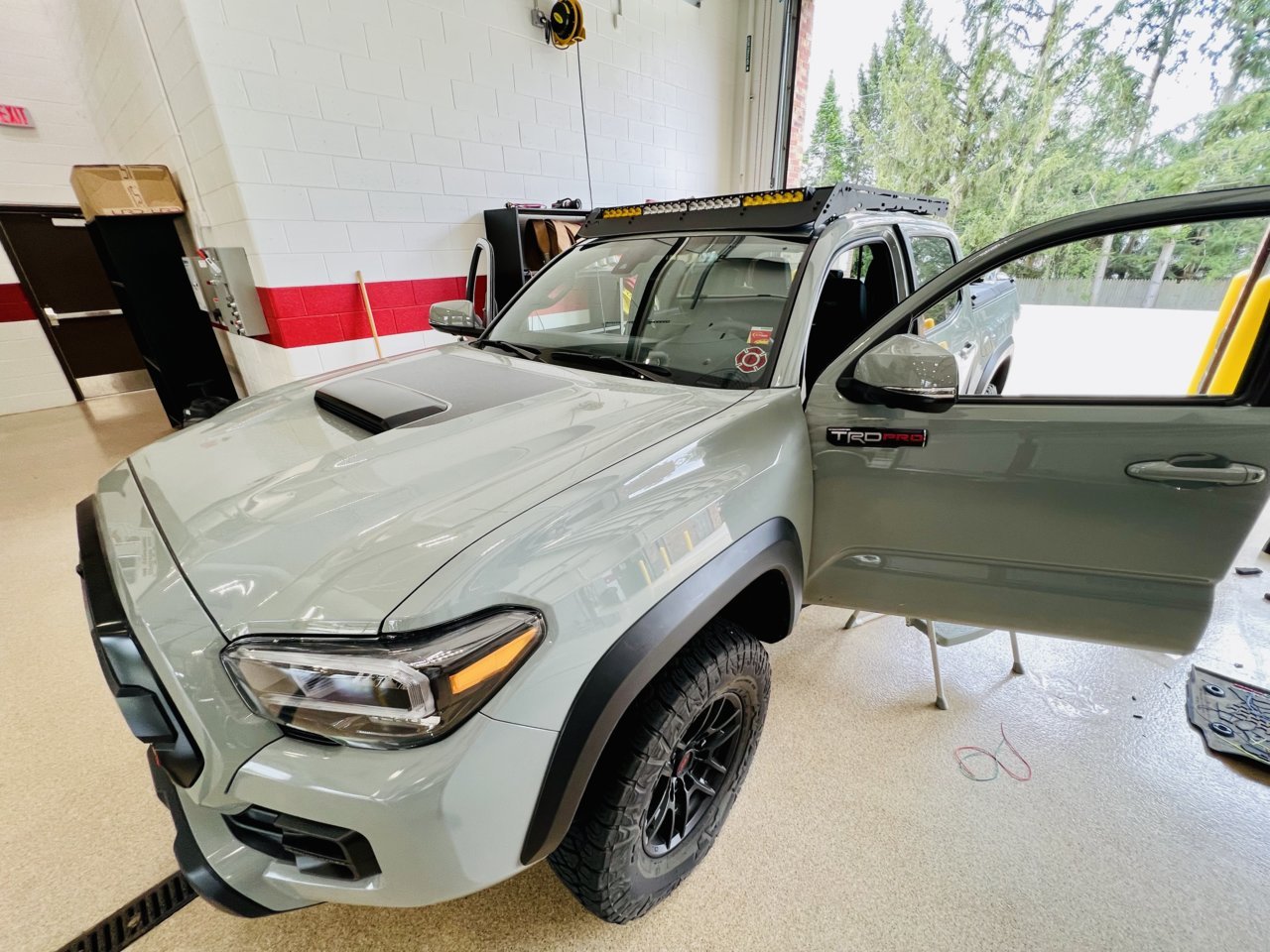

    First accessory wired into the OE aux power tray! I might have to make some minor adjustments as far as fit, but there is plenty of room on the underside for the relays, and the pigtail is now plugged in and ready to power all aux switches in the cab.
    Just a quick view from above to show that pretty much none of the wiring is visible or would interfere with any future mounting on the rack, and a few shots of the final product. I will add night photos when I get the opportunity.
    If anyone has any questions/comments let me know.

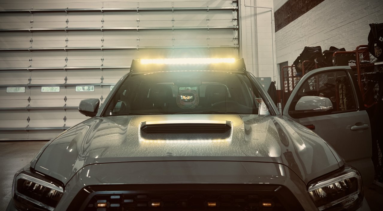

    EDIT: Cockpit view of light bar on and off at night:
